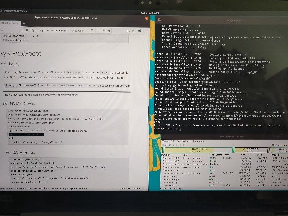

See my code above: you're mounting your /dev/nvme1n1p7 EFI partition to /mnt/boot/efi, and your root system partition /dev/nvme1n1p7 to /mnt. You don't need to mount the swap to fix the bootloader.
The code on the system 76 site basically auto mounts some of the other necessary virtual file systems, then chroots into your mounted system, updates the initramfs then runs the systemD bootctl command to reinstall the bootloader & (we hope) fixes missing entries in NVRAM etc.
Do you mean nvme1n1p8 to /mnt/boot/efi and nvme1n1p7 to /mnt?
nvme1n1p8 is the efs partition you see from my pic i posted yesterday and the nvme1n1p7 contains the ext4 with all my data
Cheers thanks.
After going through most of the steps I got an error after one of the steps reach completion.
Basically when I had executed
Update-initamfs - v - k all
some of the stack trace logs

Error: GDBus.Error:org.freedesktop.systemd1.UnitMasked: Unit -.mount is masked.
Despite the error above I continued the process and it seem to finally boot into my pop os!
Woot!
Man I owe u big time for this!
Thank you so much mate!
Really appreciate it!
On a separate topic, is there clone backup tool/time machine feature where I can backup everything including the apps and data as is and restore it if ever I completely mess it up again?
fwiw the error is because the initramfs update auto ran a grub-update(!), which obv fails cos you're not using grub.
Nice one for sticking with it - fixing a knackered bootloader is one of the Linux rights-of-passage and the fact you've done it once will def come in use in the future.
