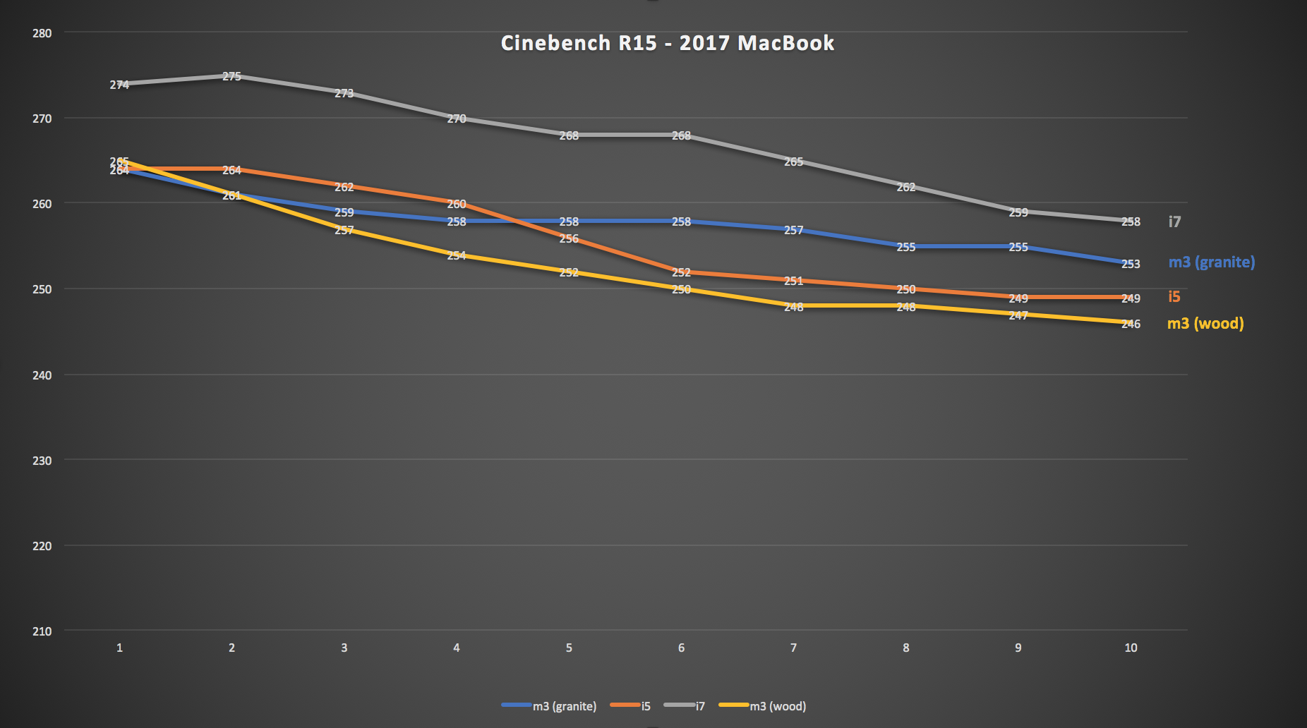

As I suspected, the table material makes a difference. The first time I ran the test on my 2017 MacBook Core m3, I ran it on a granite counter, and turned off WiFi and Bluetooth. I just ran it again, but this time ran it on a wood table (which would act more as an insulator, keeping the heat in), and kept on WiFi and Bluetooth.
First off, the Cinebench R15 test on the wood table followed a curve which more or less flattened out around the 240 point range after 20ish runs. No hard performance drop-offs either.
As expected, the performance curve of the MacBook m3 on wood was shifted a bit lower than the performance curve of the MacBook m3 on granite (although the difference after 10 runs was less than 3%). Furthermore, the performance curve of my MacBook m3 on wood more closely followed the performance curve of Brookzy's MacBook i5.
Above are the first 10 runs. Below is the raw data for all my 22 runs.
265
261
257
254
252
250
248
248
247
246
245
244
244
242
242
242
241
242
240
241
240
240

I agree. It was just nice to confirm that the i5 wasn't behaving abnormally. The main reason my initial m3 had it doing better over time than the i5 was because I was using it on a stone countertop. Once I switched to wood, the m3 and i5 behaved similarly. However, the bigger point was that it appears there is no real point in getting the i5 (unless you need more storage), or the i7 for that matter... at least according to this test.
Over 10 runs, the fastest speed the i7 achieves is 275 (near the beginning of the 10 runs), and the slowest speed the m3 achieves is 246 (at the end of the 10 runs). The difference there is 29, which is just 11% slower than 275.
Furthermore, the biggest difference in this test on the same run between the i7 and the m3 is 268-250=18, or all of just 7%. As you said, subjectively there should be no discernable difference.
That said, for very bursty stuff, the i7 may feel a bit faster. According to Geekbench 4, it can achieve approximately 8450 multi-core, whereas the m3 achieves about 7050. That's a 17-20% difference. There is still no point for the i5 though, since it only achieves about 7480, which is only 6% difference vs the m3.
BTW, here again are Notebookcheck's 2016 Cinebench numbers:
2016 m3: 218 --> 185 (-15.1%)
2016 m5: 260 --> 229 (-11.9%)
2016 m7: 251 --> 207 (-17.5%)
Versus my m3 over the same 22 runs:
2017 m3: 265 --> 240 (-9.6%)
