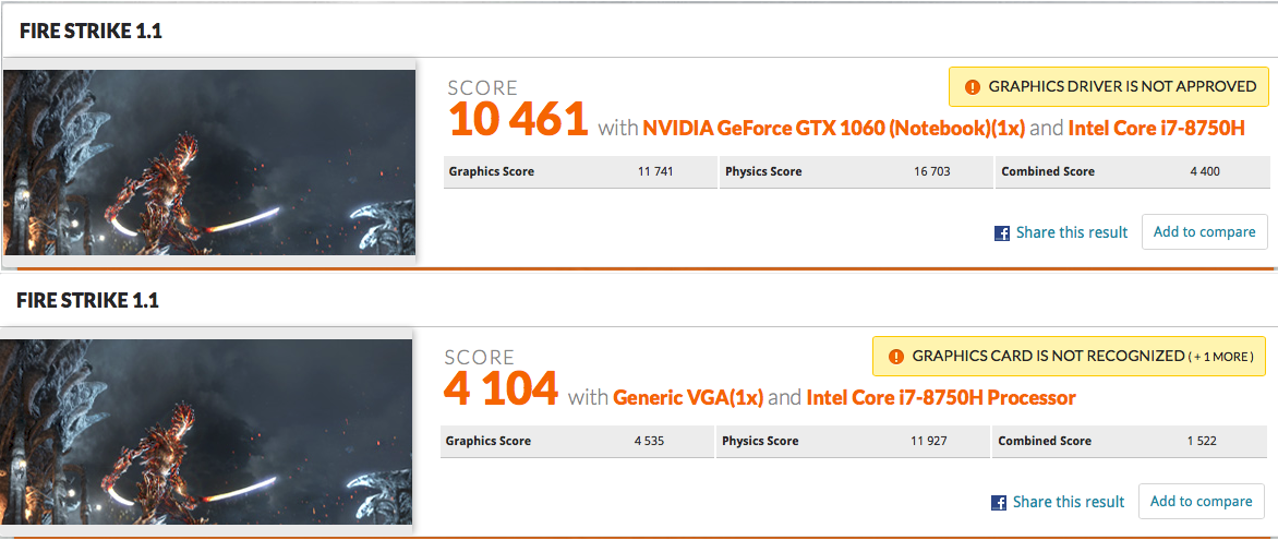

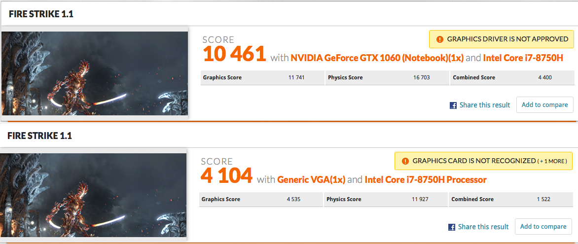

@DannEboE - I’ve run all the test but I think we’re doing something wrong. 560x comes out 15-35% faster, which is a lot more than what I expected, but still possible. But all the physics/cpu scores I get are a whooping 50% faster on your machine, and that doesn’t make any sense, we have the same CPUs. Do you use anything to limit CPU, like Intel XTU or something? What are your drivers version? And did you buy advanced version of 3dmark? The base/free version doesn’t have all the graphs etc. and just to be sure - you have your windows desktop set to native retina resultion? I guess so based on heaven/valley.
Well of course nobody buys MBP and expects dedicated Windows machine performance in games. Or strictly for gaming as primary use. But MBP with dGPU is still quite capable in this regard for occasional session when you’re bored in a hotel room.
On Windows side, I am not using anything to limit CPU. I have Intel Power Gadget to monitor temperatures and they seem to be holding pretty well (relatively). I can check driver versions when I get home from work, but they are default from bootcamp installation + the latest windows update. I have Windows 10 Pro if that does anything. I should only have the basic version of 3dmark. Yeah, all resolutions are set as native.
It is possible I also received a slightly slower variant of the processor. Maybe I got the lower end of the stick for what was acceptable for that processor model.

@DannEboE - you have the advanced edition of 3dmark, I just noticed this on the fire strike screen, did you get it from steam? Would you be able to download the basic one and run those? I mean I have no idea why those cpu scores are so much different, other than the different version of the benchmark.
That's odd. I don't recall ever purchasing 3dMark haha. Yeah its in my steam.
I can try running basic ones when I get home in a few hours.
Ok, wait, I’ll just get the steam version and run it again.
[doublepost=1533931454][/doublepost]I'm sorry everyone, I forgot I've set the cpu limit in energy settings to 99%, which disables turbo boost... I have to run all that crap again.
Haha! Those benchmarks take awhile with all the demos included. At least for me, the time it took for the benchmark to identify my system was as long as the actual benchmark itself.
