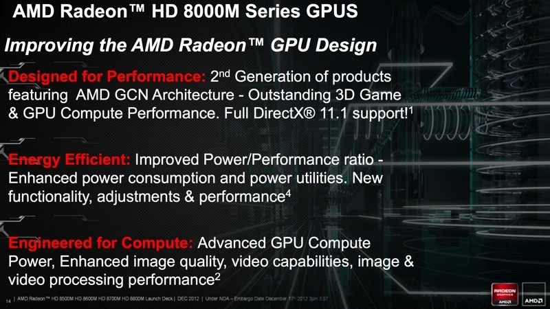

Radeon M370X = M270X = 8870M (They all are Venus XT chips, 6821 device ID)
AND in Amd's SDK v.3 beta it says that "OpenCL 2.0 supported on 8800M series."
http://developer.amd.com/tools-and-sdks/opencl-zone/amd-accelerated-parallel-processing-app-sdk/system-requirements-driver-compatibility/
Also if you look at this AMD's Solar System GPU slide, you can see that the 8000M family received updated, second generation GCN. Back then it was not yet called version 1.1, hence the confusion.
