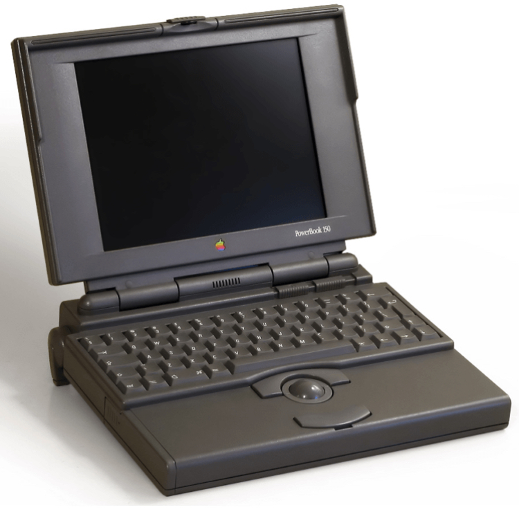

I’m in as long as we finally get a proper pointing device again:
This thickness would allow for a proper battery as well.
PS I knew Apple had lost their way 25 years ago when they dropped the ADB port from that PowerBook 150. Steve would never have allowed that...
