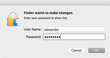

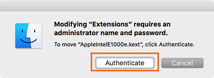

2. Click “Authenticate.”
kextbeast-authenticate
3. Enter your admin password.
kextbeast-authenticate-with-admin-password

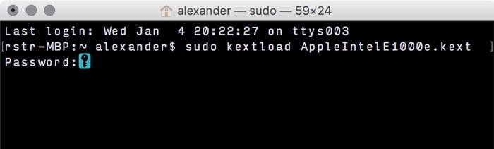

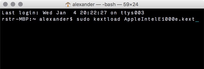

4. Open Terminal and use the command sudo kextload kext.kext to load your newly copied kext file. Make sure to replace “kext.kext” with the name of your kext file.
kextload command

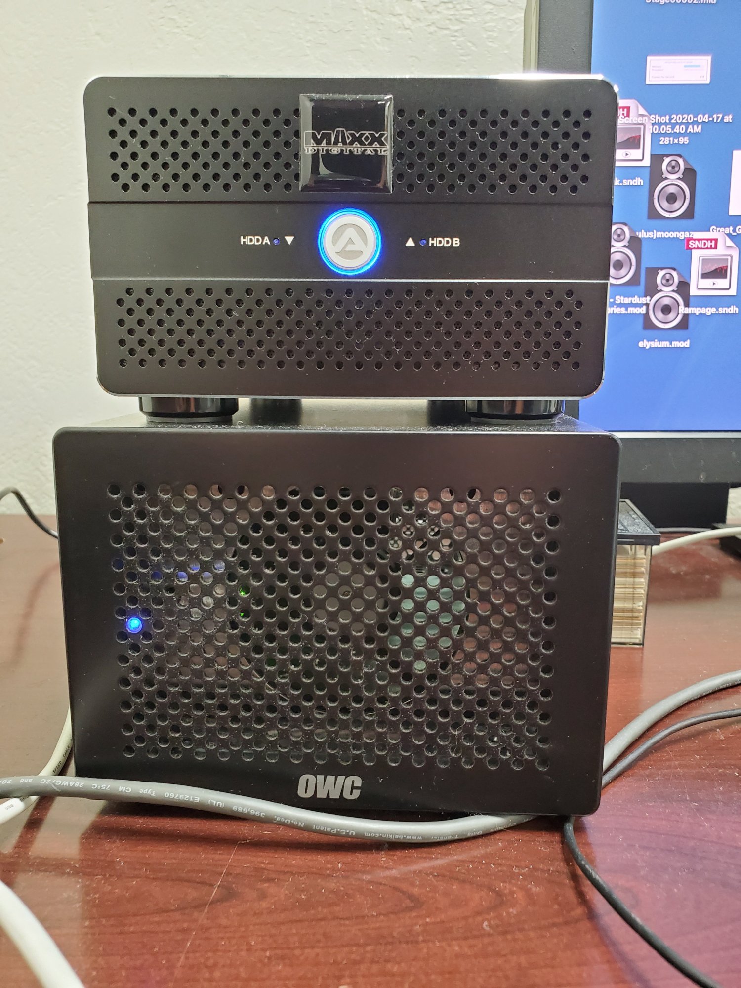

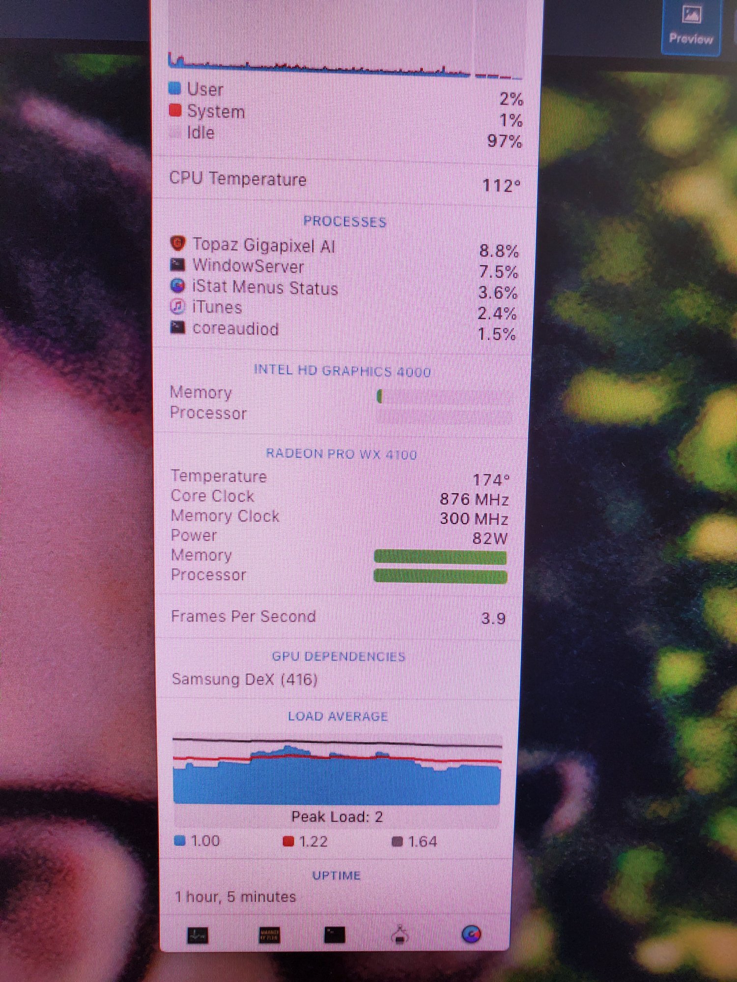

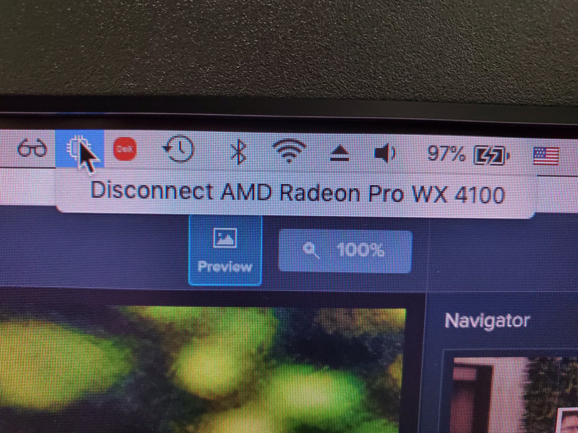

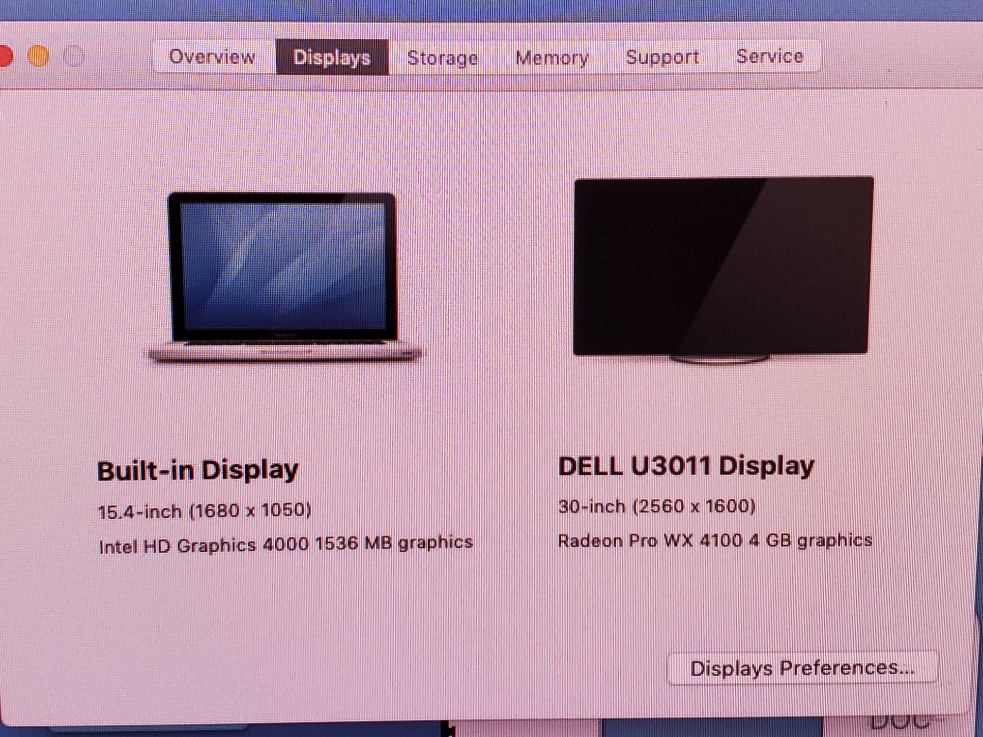

Even though I no longer use this setup due to no longer having the Mac and hardware associated with it, I figure it might help someone.
In 2018 I built a Thunderbolt 1 eGPU for my 2012 cMBP. The 512MB GT650 was really struggling with newer software like the Affinity suite and Topaz Labs. CPU was more than strong enough.
I built a setup out of used parts:
OWC Helios 2
AMD WX4100 (I used to work in ITAD and just got it for cheap)
Thunderbolt 2 cable
Using Purgewrangler and Mojave I was able really get a good run out of the hardware! Games saw decent increases in FPS (some saw micro stuttering), creative software flew, and it was an overall pleasant experience. Only downfall was that I could not put the cMBP asleep, it had to be powered up connected to the eGPU and disconnected with the egpu still plugged in.
I also chained a RAID 0 array and didn't see any real decrease in gpu power.
It definitely helps me because I own a 2012 cMBP. 🙂
OWC Helios 2
Thunderbolt 2 cable
That's a nice setup.
