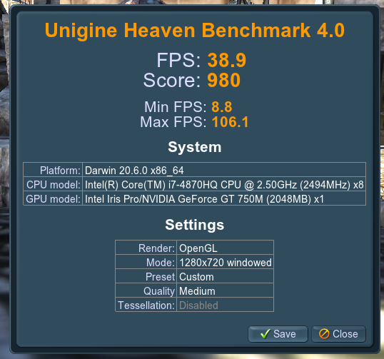

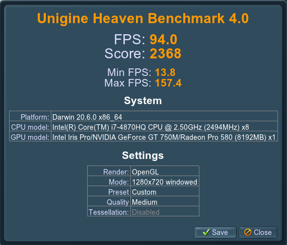

I just tried the Kryptonite + BlackMagic RX580 with my headless MBP 2014 i7 2.5GHz DG (Big Sur). This is a very fast machine for its age. 😎
Year ago when I tried Kryptonite + eGPU last time (with this headless machine) I didn't get it to work but this time for some reason no problem. I might have answered the one question wrong in Kryptonite installer last time as I initially also did that this time. The installer asks: "are you using NVIDIA GPU?". I thought this was about the internal dGPU which was also addressed in the installer after that. But when reading the summary of settings before committing to install I noticed that the question was actually about the eGPU. So, i fixed that answer and now everything works. 👍
Again, I didn't (yet) try to disable the dGPU as I do not have an internal display at all. If you want to connect the display to the eGPU and thus get even better performance you should disable the dGPU in Kryptonite installer but I wonder how does it work as this machine no longer has its original display but is working as headless? Well, it might work just fine - maybe I'll try it later. But now I just try it by connecting the external display to machines HDMI-connector. But because of this I now have to set each software one at a time to prefer the eGPU when possible. Otherwise it will use original gpus automatically.

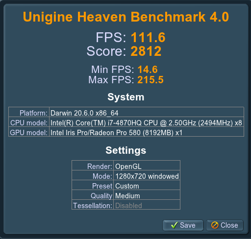

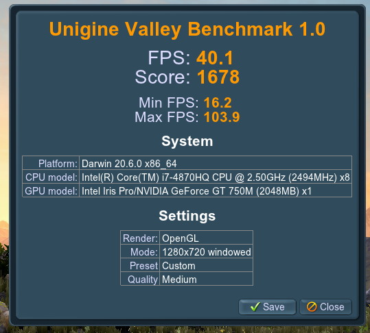

So, here are the results, very good improvement! 😍
Stock:
BlackMagic RX580 (using the MBP's HDMI out):

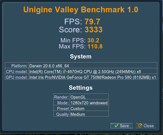

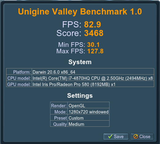

Okey, I have now tried it. It works*. 👍 But, I got some mixed results. 🧐
1. Heaven & Valley indicate improvement
2. GB5 is the opposite
* I need to unplug HDMI from eGPU and plug it into the MBP to boot and then mid way when the progress bar freezes plug it back. I have not been able to get a pic booting blind even though it defaults to Kryptonite and the process is simple. Booting with the HDMI plugged into the MBP and not disabling dGPU is easier.
Results (compare to post #107):
Two on top are when the display is connected to the eGPU and 2 on the bottom are when the display is connected to the MBP. I would have expected this to be other way around.

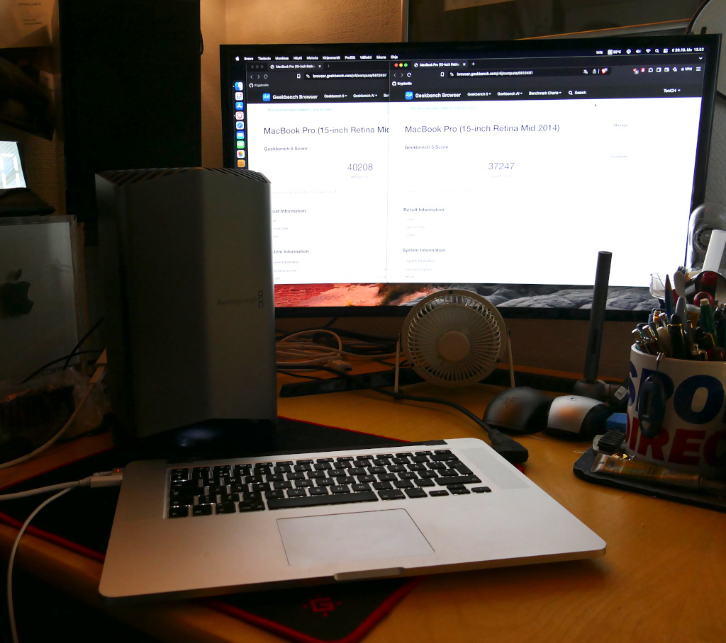

And this is what I get with Geekbench 5. It seems that this is the fastest GB result this far for this MBP+eGPU.

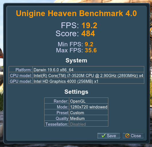

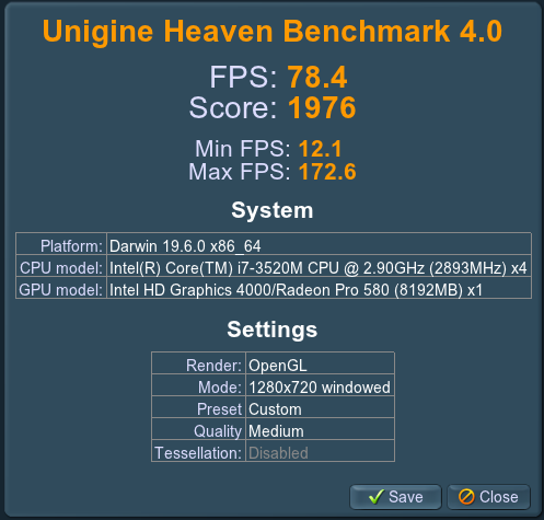

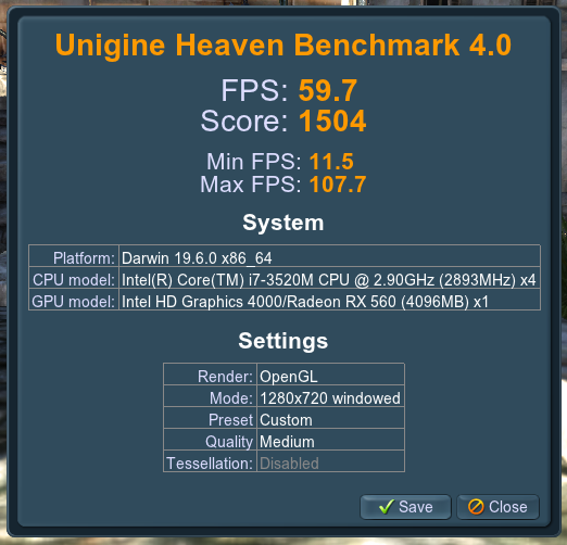

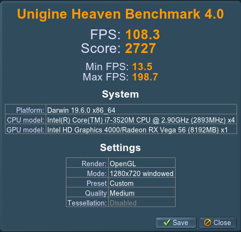

Little update here. I just got a Vega 56 Red Dragon (70€) and put it into a Razer Core X -case (100€). Plugged it to my MBP 2012 13" i7 2.9GHz. I made no changes to my Kryptonite-setup and it works right away. The OS is Catalina.
Here is a little comparison -
Stock MBP Intel HD Graphics 4000 --------- Sonnet eGFX Breakaway puck Radeon RX560:
BlackMagic Radeon RX580 ------------------ Razer Core X + Radeon RX Vega 56 Red Dragon:
