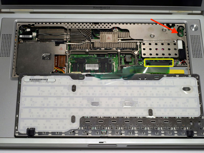

On the TiBook, there's a manual reset button underneath the keyboard. See pic from iFixit below (with red arrow marking the button's location):
Give that button a press for a second or two. Then see if your TiBook will boot.
