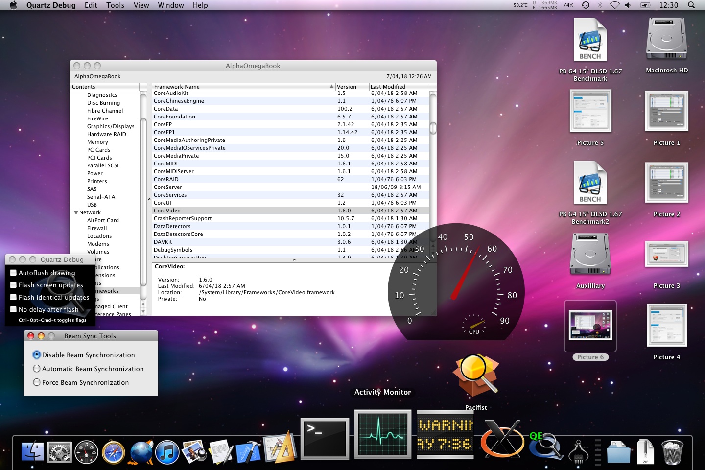

After some further digging around, I came across an Ars poster with very insightful information on what they refer to as "Memory tax" - https://arstechnica.com/civis/viewtopic.php?f=19&t=1329095

Ok, so I downloaded 10.5.1 Update, 10.5.2 Combo all through to 10.5.5 Combo and poked around with Pacifist. None of them had the CoreVideo.framework. It turns out that CoreVideo.framework v1.5.0 was from 10.5 (fresh), so I created another partition and did a clean install of 10.5, then updated this to 10.5.5 with the combo.
(CoreVideo.framework 1.6.0 is installed during 10.5.6 and remains unchanged to 10.5.8).
After all of that, my findings were the opposite. CoreVideo.framework 1.6.0 delivers higher Quartz Extreme frame rates than v1.5.0 in both the WindowManager and the Dock (when magnification is enabled).
Here are some FPS readings (Using the Xcode 3.1.4 > Performance > Quartz Debug > Frame gauge)
PowerBook G4 Late 2005 DLSD 15” 1.67Ghz / 2GB DDR2 / ATI Mobility Radeon 9700 128MB
10.5.8 with CoreVideo 1.5.0
BeamSync: Auto
2D Dock Magnification:~28 - 32 fps
WindowManager movement:~34 - 40fps
BeamSync: DISABLED
2D Dock Magnification:~36 - 42 fps
WindowManager movement:~55 - 58fps
10.5.8 with CoreVideo 1.6.0
BeamSync: Auto
2D Dock Magnification:~40 - 45 fps
WindowManager movement:~58 - 60fps
BeamSync: DISABLED
2D Dock Magnification:~45 - 55 fps
WindowManager movement:~60 - 62fps
The short answer is: CoreVideo.framework v1.6.0 introduced in 10.5.6 IMPROVES the UI frame rates *substantially* over v1.5.0 when BeamSync is set to Automatic (default).
There were also reasonable improvements found in v1.6.0 when BeamSync was disabled, however as expected, window tearing is evident when moving things around quickly and although the frame rate is higher, it makes the UI appear a little rougher. The Dock magnification didn’t appear to be affected by tearing in the same way window movement is.
In these tests, I had already disabled AudioIPCDriver.kext and set the Dock to be 2D (Black) via Onyx.
