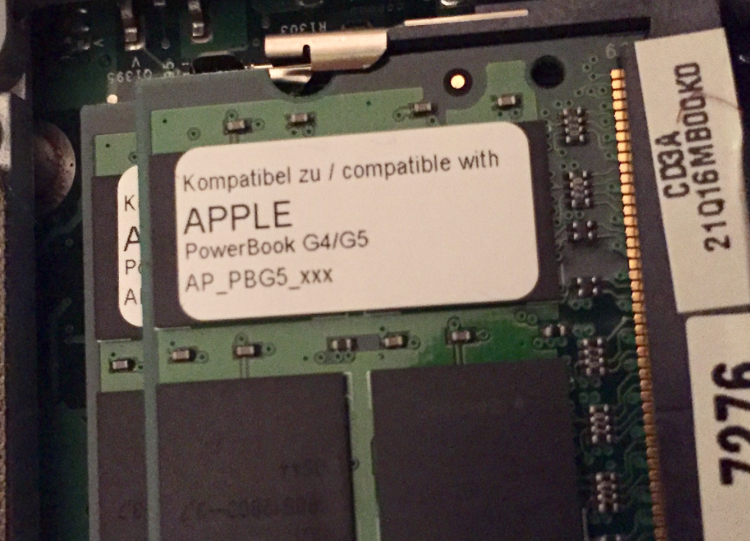

Also totally off topic, but I picked up my new (German QWERTZ) DLSD PB G4 15” during the week and found an interesting sticker on the RAM modules...
Seems the reseller was prepared for the imminent release of the PowerBook G5 and labeled their DDR2 SO-DIMMs accordingly :apple:

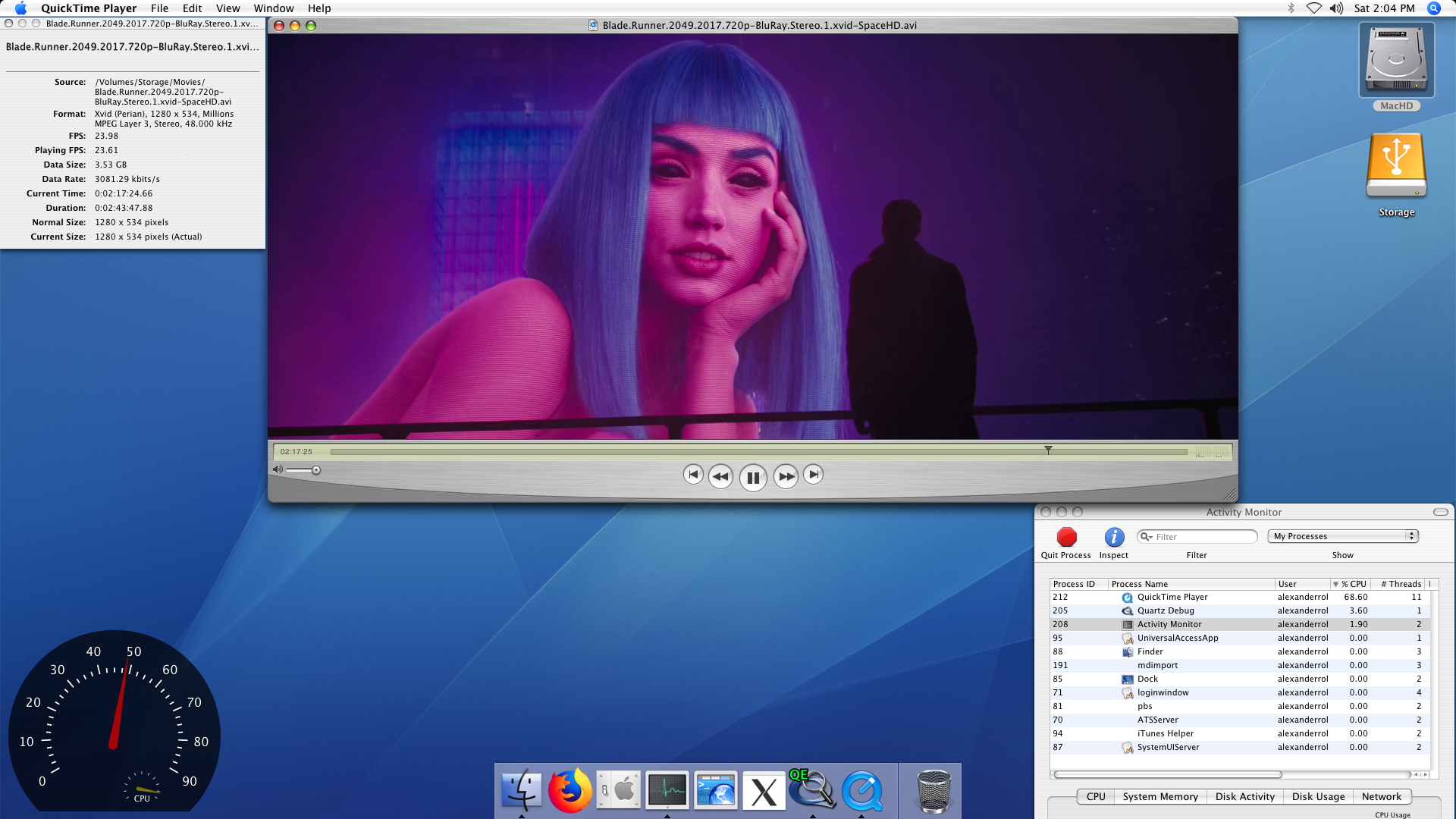

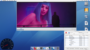

Did CoreVideo 1.4.1 on 10.4.11 make for any performance improvement? Are you able to check FPS readings with Quartz Debug?

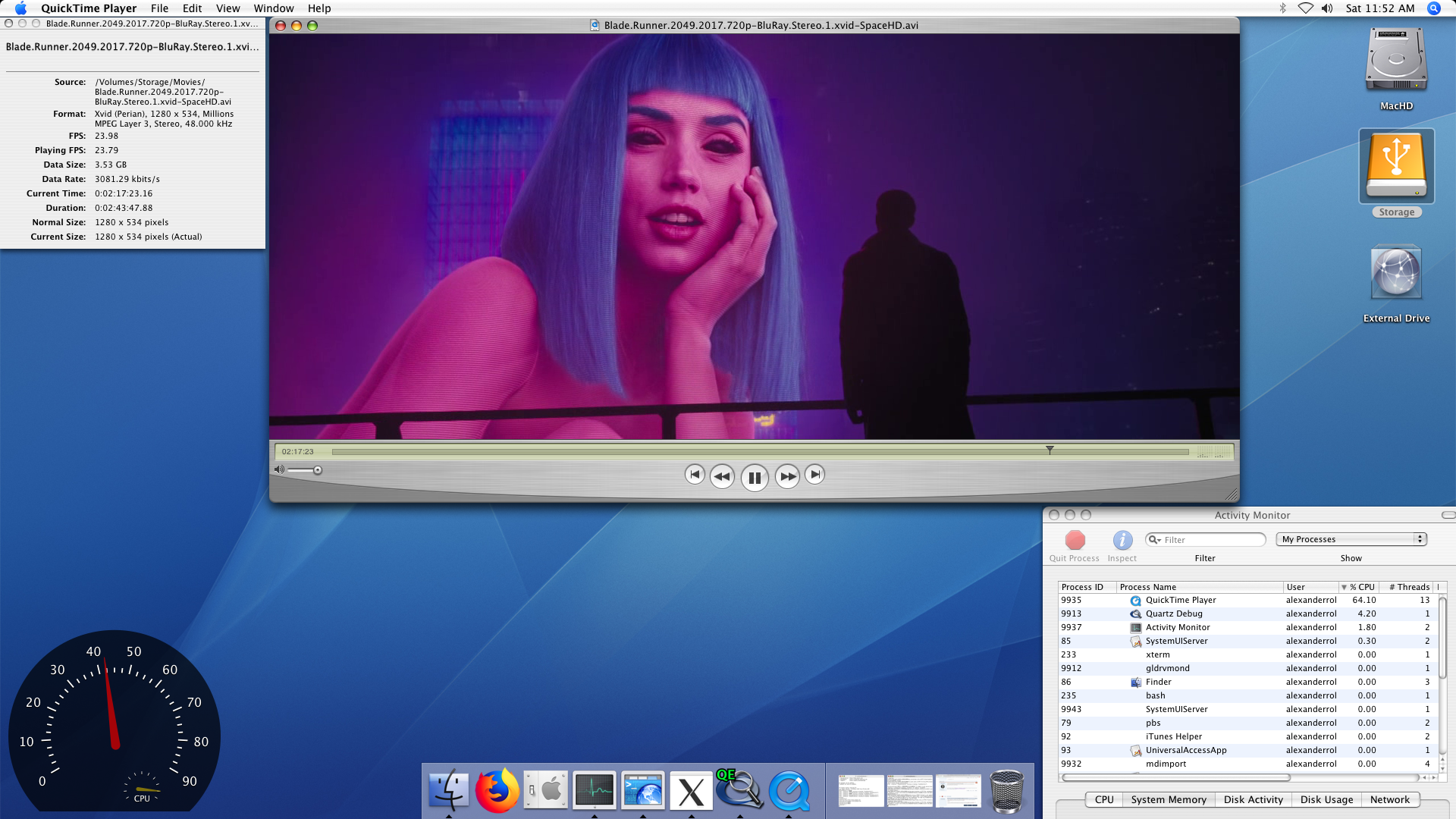

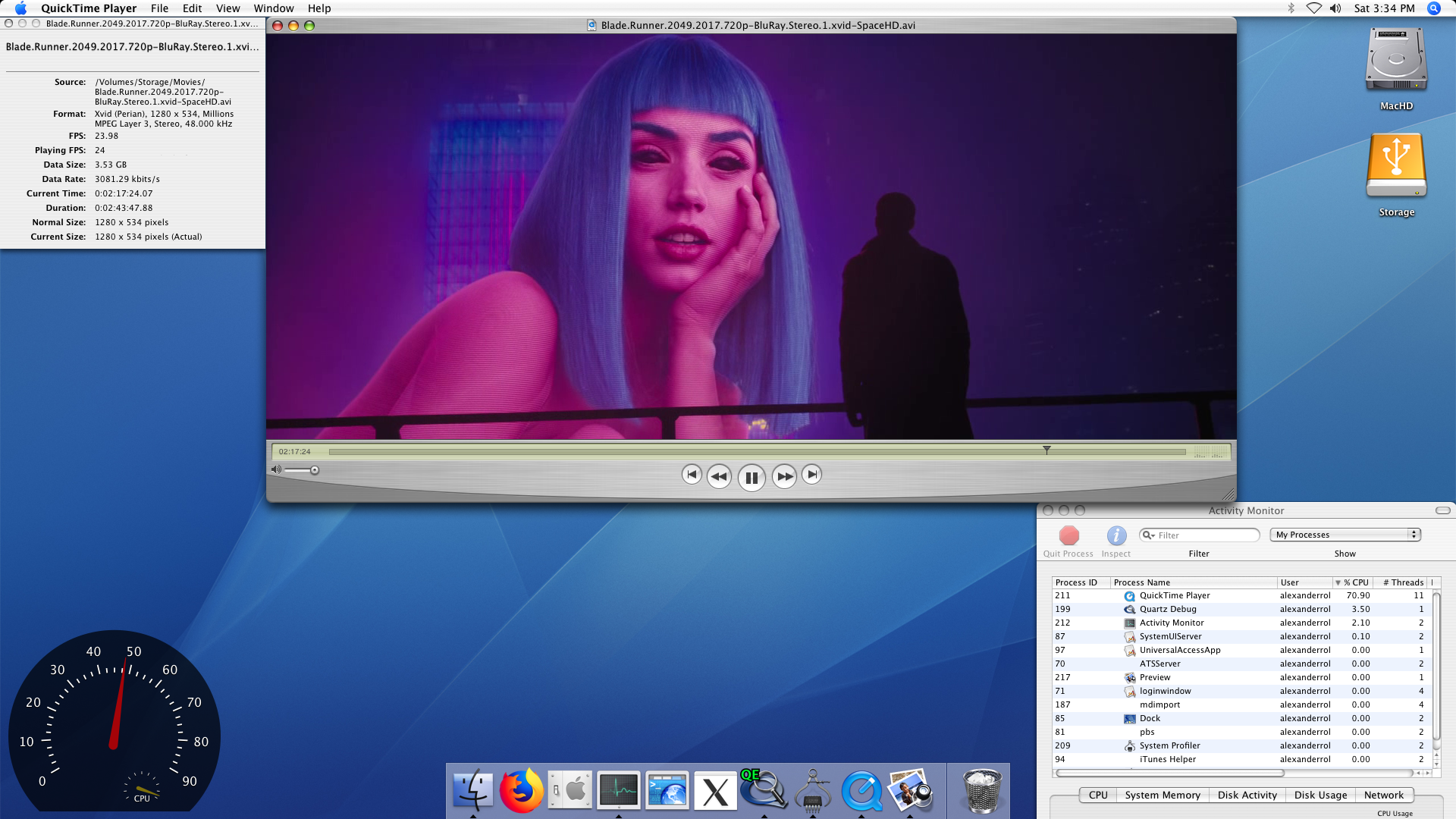

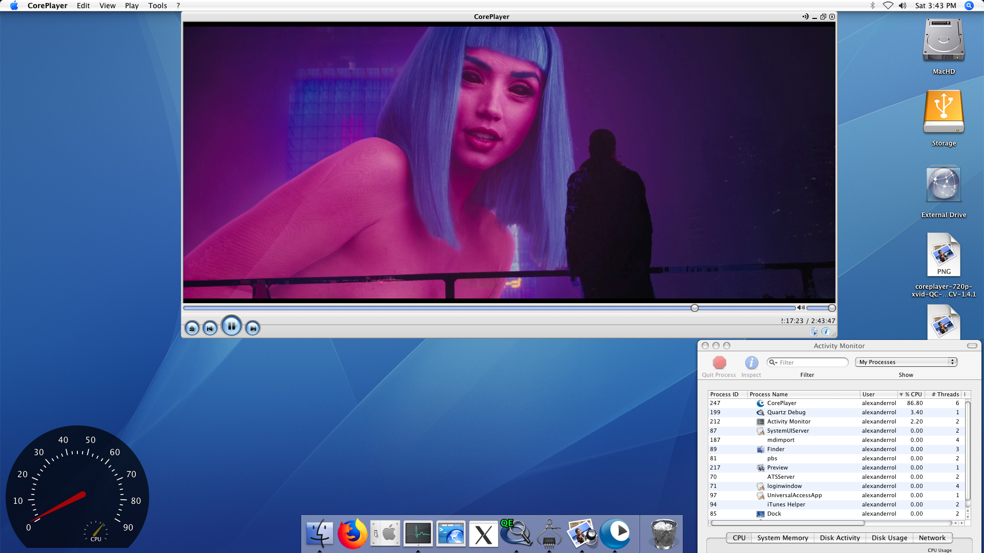

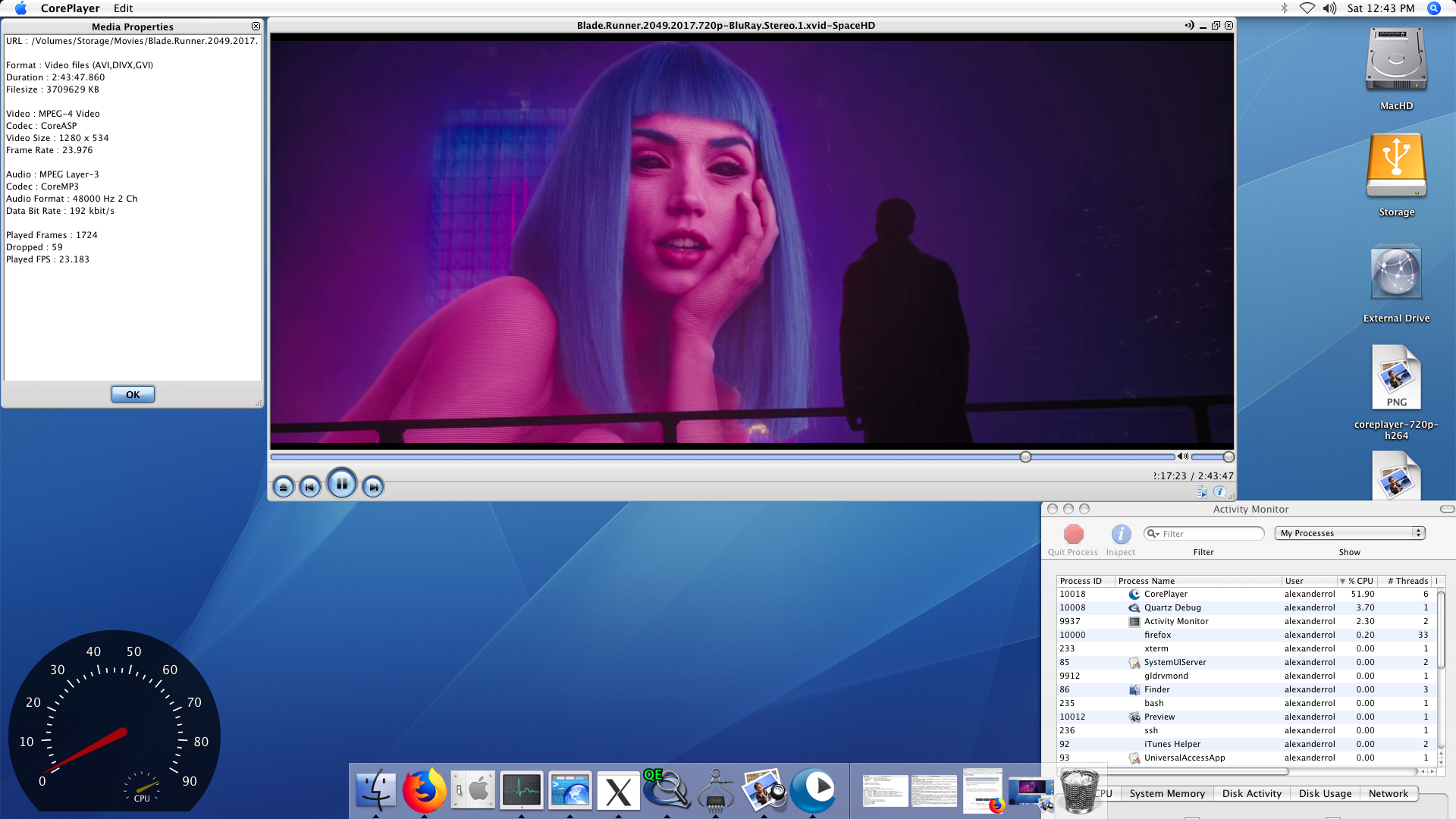

I've been using CoreVideo 1.4.1 on 10.4.11 this entire time actually (using QuartzCore 10.4.9). I did try running without CoreVideo on 10.4.11 for a bit but certain applications refused to start without it being Installed (TenFourFox for one)

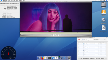

I tried some playback tests while Quartz Debug framerate tool was going. I'll try running them again using the latest versions of CoreVideo and QuartzCore in a bit. Running on a MacMini G4 (1.5 GHz overclocked) 1GB RAM, ATI Radeon 9200. Note: Quicktime would just crash when opening my sample file (h.264 in an mkv container) so i couldn't get a reading on it.

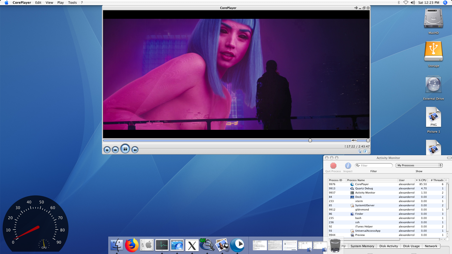

[doublepost=1523133460][/doublepost]QuartzCore 10.4.9 && CoreVideo 1.4.2 (on 10.4.11)
Quicktime still crashing when trying to open the h.264(in an mkv) version of this file. Noticed an increase in FPS, along with an increase in CPU utilization (for the quicktime xvid playback test). BeamSync was disabled for all current and previous tests.
edit: Oh my posts were merge for some reason. I'll have to make sure to name my files accordingly

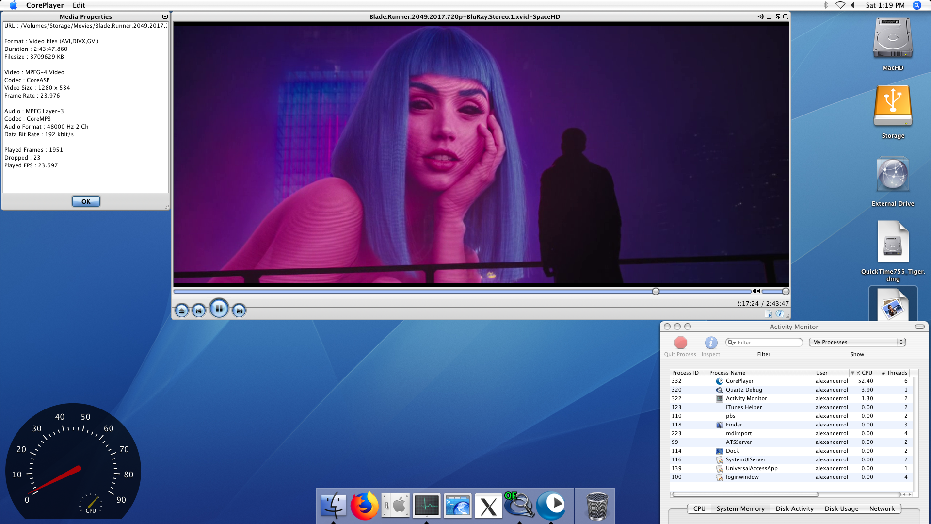

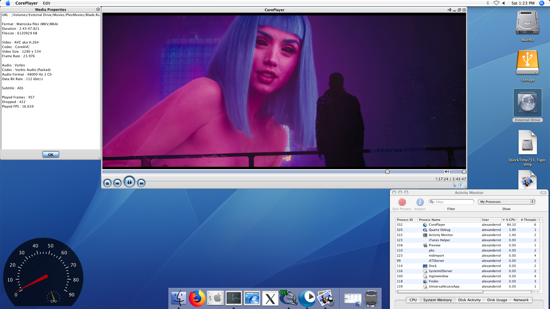

QuartzCore 10.4.12 && CoreVideo 1.4.2
Results were similar to previous test with regard to xvid 720p playback. Quicktime was now able to open the 720p h.264 file but as you'd expect it played back at around 0.5 fps. Coreplayer seemed to struggle more with my test file this time around, but it was also struggling in the previous tests as well.
I just need to try the combo of QuartzCore 10.4.12 && CoreVideo 1.4.1 to wrap things up.

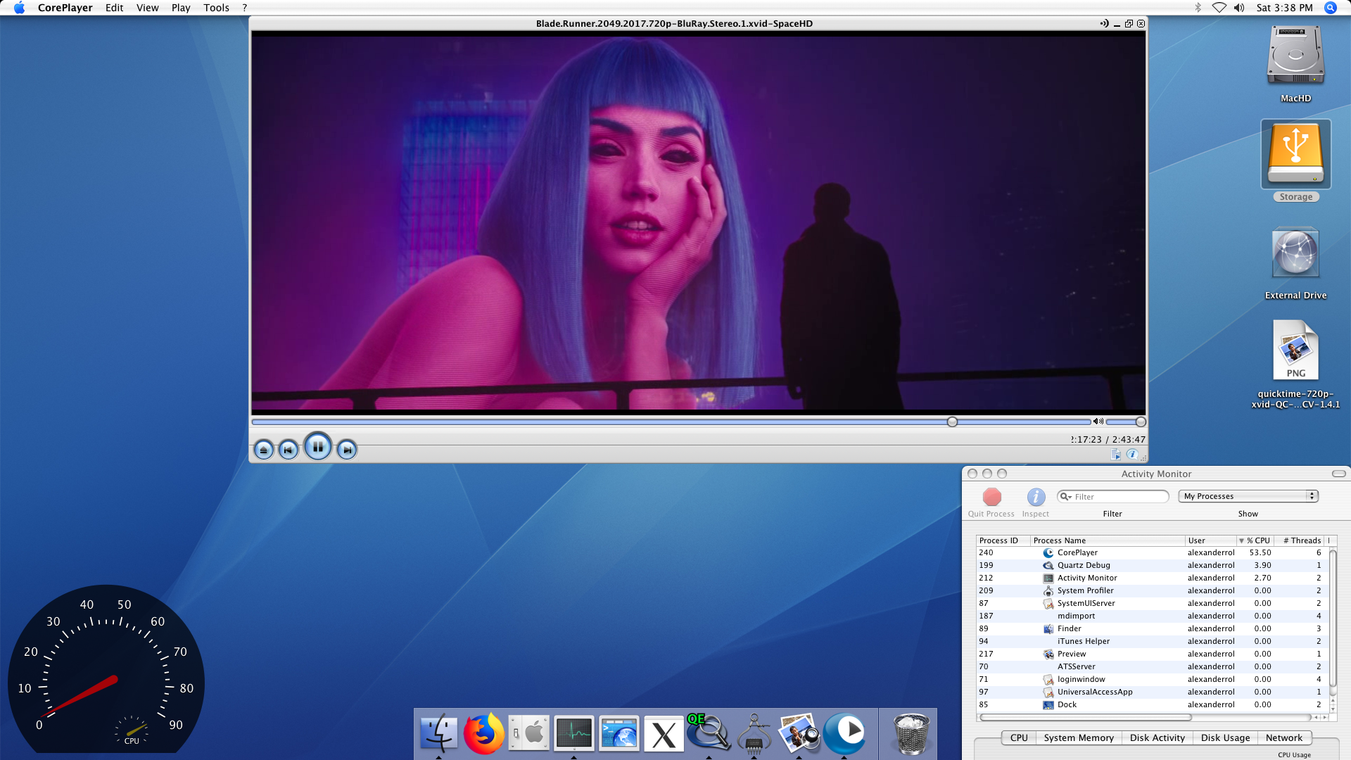

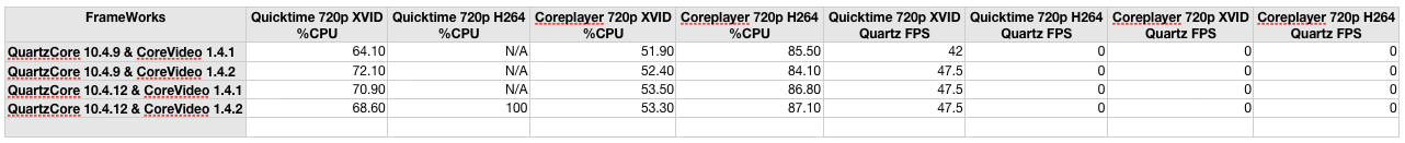

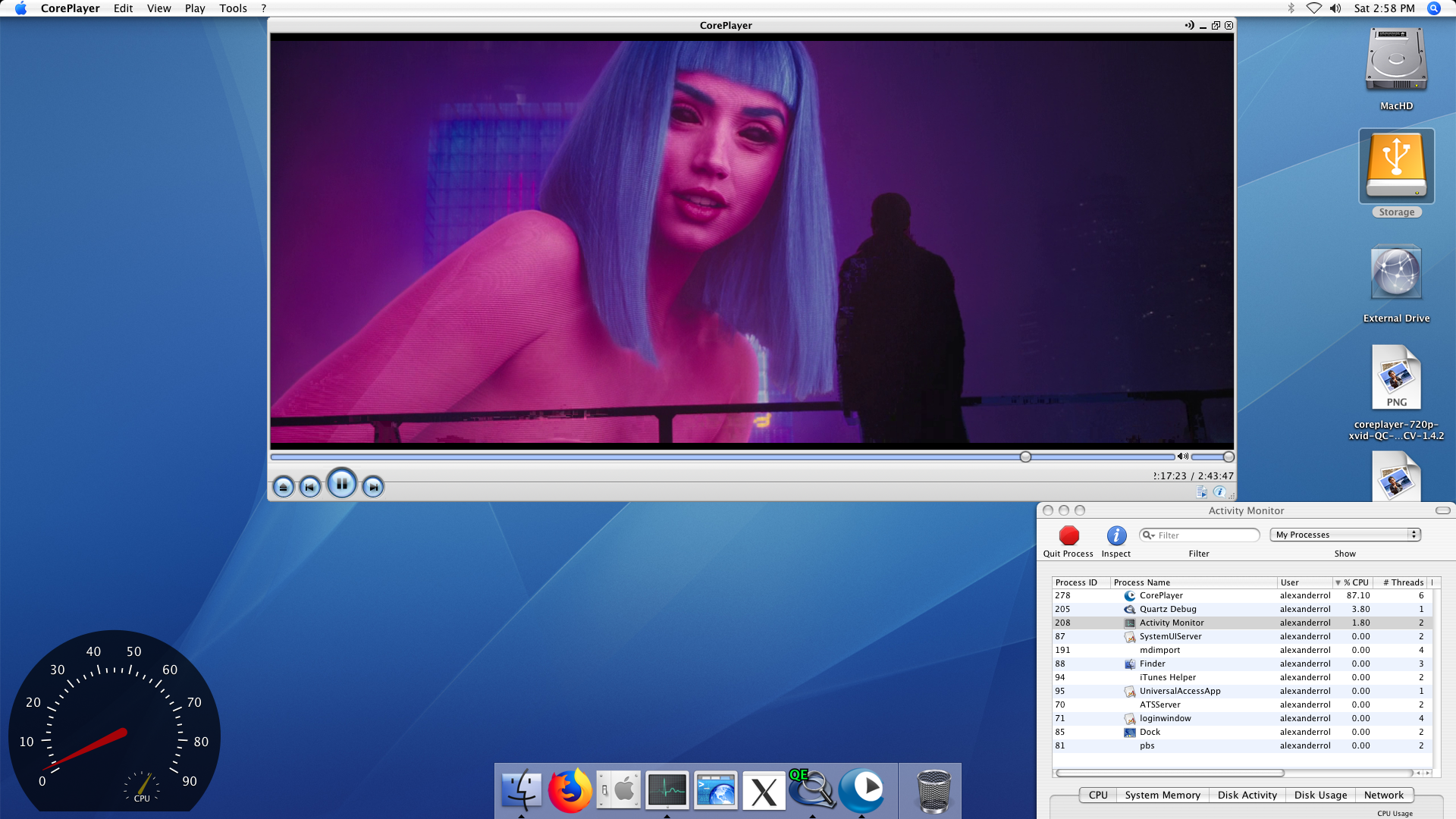

Pretty much the same as the QC 10.4.12 & CV 10.4.2 from previous. Quicktime was unable to open the 720p h.264 file.
Like SkyCapt noticed, the combo of QuartzCore 10.4.9 and CoreVideo 1.4.1 seems to be the least taxing on the system, but only marginally. You gain about 5.5 FPS according to Quartz Debug Frame Meter at the expense of about 6% more CPU utilization according to my tests going with other combos of QC and CV.
Edit:
Completely annecdotal evidence, but I found the smoothest video playback under FrontRow was with QuartzCore 10.4.9 and CoreVideo. 1.4.1
