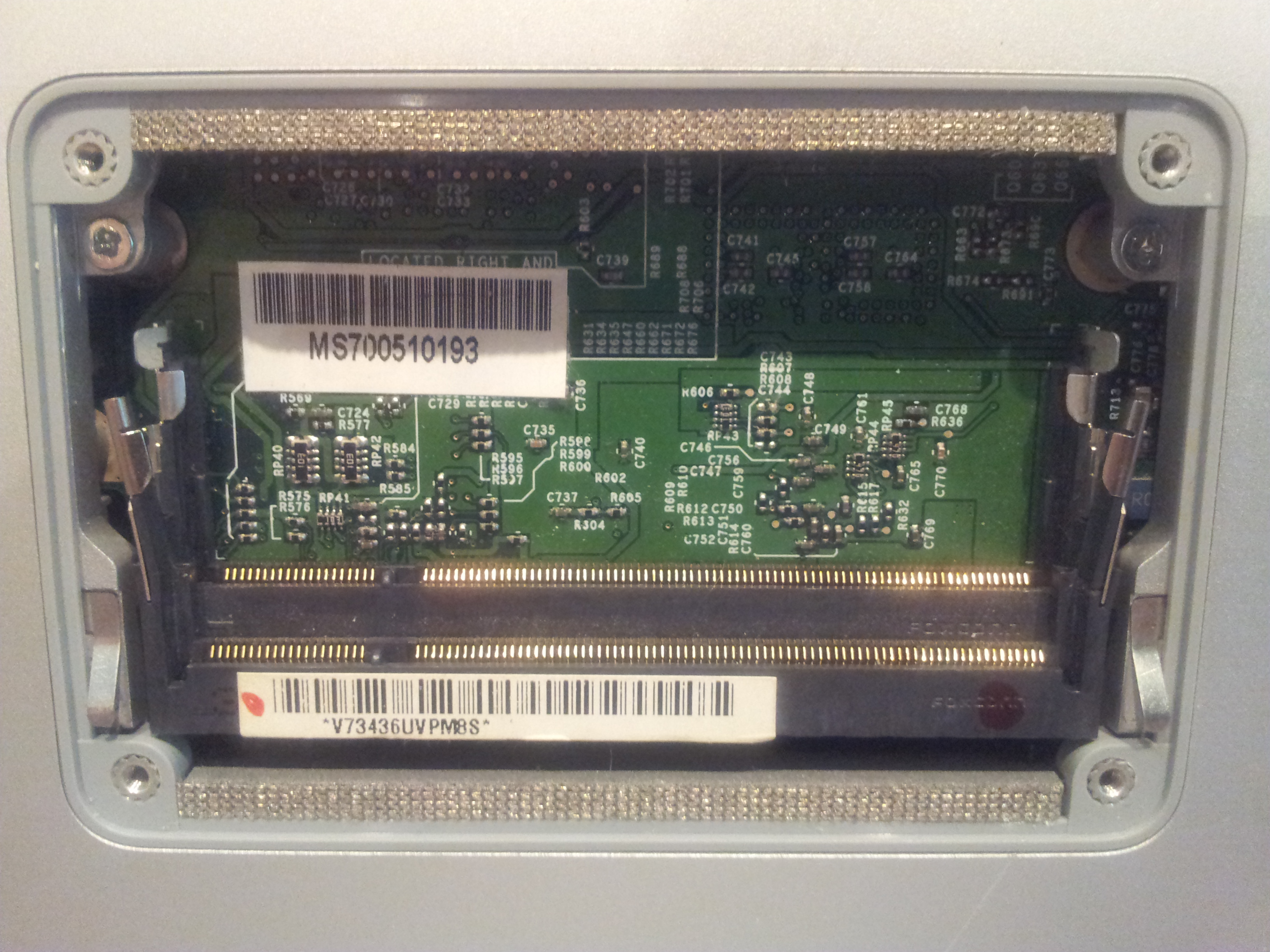

I mention problems with the slots because I'm now having physical problems getting the ram back in. I'd be surprised if the reason im having trouble replacing the ram has something to do with the kernel panics but I am absolutely no Yoda.

here is an image of the ram slots.
the one on the right hand side does have a little crack in it, which may be preventing them from springing back into place or something. I have no idea if I did this or not or how I couldve as I was careful and didnt feel like I was forcing anything
Are you having problems slotting the ram sticks in apart from the retainers? Perhaps a bent or broken contact somewhere? The only other thing that springs to mind, bearing your comments on hot chips, are the internal temps. Is the heat sink properly seated and are temps in the expected range? Might be worth checking with iStat Pro.

Basically it seems that the <empty> ram slots are flat, back in their "closed"/ down positions. However the top slot, its arms are splayed out, the way they are when you pull them apart to lift them, angle them up to remove or insert the chips
ram slots
this should be the image attached
