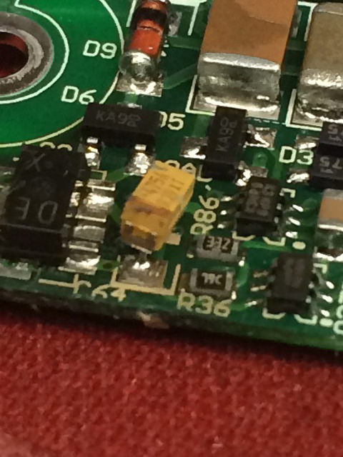

new idea
I just posted on 68kmla about my 1.25 powerbook and my kernel panic issue.
I took the hard drive out and the board under it (not the hard drive I think its the modem) was burnt, both sides. Capacitors and resistors heated up enough to flow the solder and cross mount them on the board. The tantalum caps on one side were "legged" for lack of a better term to the pad rather than flat on it.
This mac that kept locking up seems to have been totally tied to this board. No idea how that much heat happened there but just a suggestion to look at other places than the motherboard. With that board removed the powerbook has been stable almost 24 hours now without issue.
