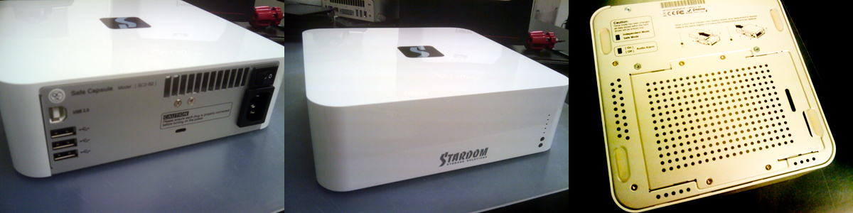

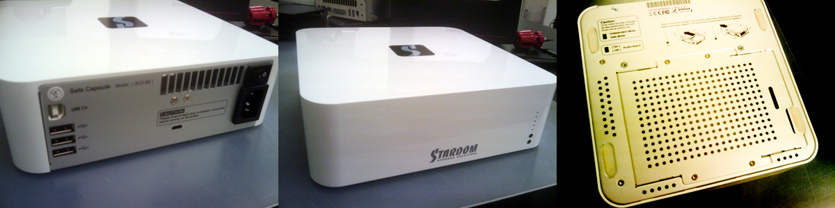

Safe Capsule product from Stardom
I've been using the Safe Capsule product purchased through www.macsales.com & it's been working like a charm. With 2 drives in a RAID 1, I've got all my data backed up & the product has an internal power supply. Awesome product which I highly recommend.
I just received the 4TB Safe Capsule that I ordered on newegg.com the other day. It looks pretty cool, a large fan, internal power supply and a lot of openings to bring down the heat. It did not mention on stardom's site but I assume it will work with airport extreme base station as well.
Follow up on Stardom Safe Capsule
Ok guys, it's official, this is a great product, it's trouble free, it runs cool & I'm happy with 1TB mirrored inside. I'll post more later as the drives fill with data. I'm very happy with the workflow with this product.
