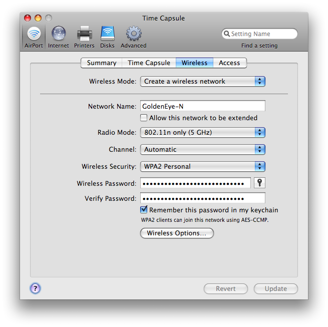

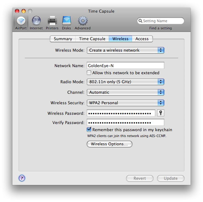

In Airport Utility, go to manage the TC. With the Airport Section open, go to the Wireless Tab. As shown in the attached picture.
You want the Radio Mode dropdown.
