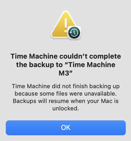

Just got the message with the updated Mac OS 15.5
Yeah, me, too. After a couple of months of smooth sailing, it looks like updating to 15.5 set me back again.
I swear, this is the most annoying bug...!

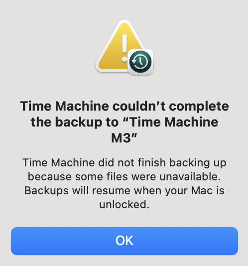

This version of Mac OS 15.5 is actually worse for Time Machine. Every morning now when I use the iMac M3, which is not sleeping, but the screen is off and locked, the Time Machine failed backup alert comes up. Every Morning now. Before it would be ok for days or weeks but now it's every day. I can't understand how Apple Engineers are not seeing this or don't care at all. 🙄

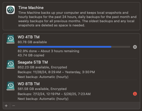

Not only are my Time machine backups failing overnight when my M1 MBP isn't being used, but it looks like backups aren't completing during the day, either!
The top backup that's running now never finishes. The time remaining gets longer and longer, then it fails over to the Seagate drive. I don't even know why the other one hasn't backed up fir a few days now.. This is pretty lame.
