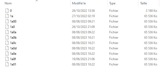

I plugged my TM disk into my Windows PC, and since the disk is NTFS formatted, the TM content is visible.
As the backup is encrypted, the saved files are split into 65536 Kb files... unusable as they are.

You can't access the files from Windows as the TM backup is an encrypted sparsebundle and Windows has no idea what to do with it.
