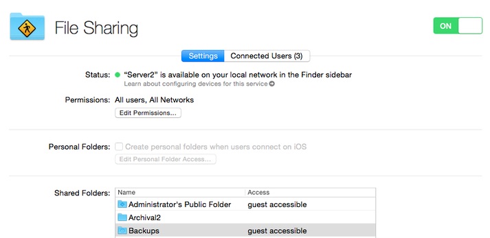

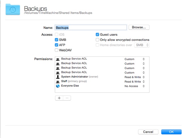

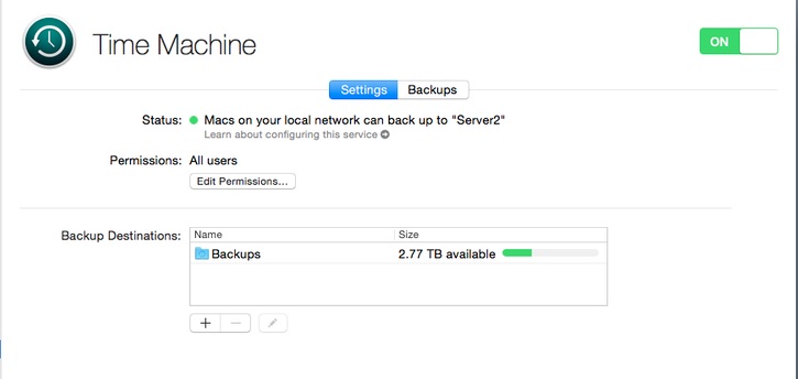

Just saw this thread. I've been running Time Machine Server for years and am on the latest version now. Backups are allowed to all users but access to the drive being used is not except via the backup service. I would have thought that all these settings were done automatically when I first set up the server. Here are the pertinent screenshots:
Reactions: Mad101daN
