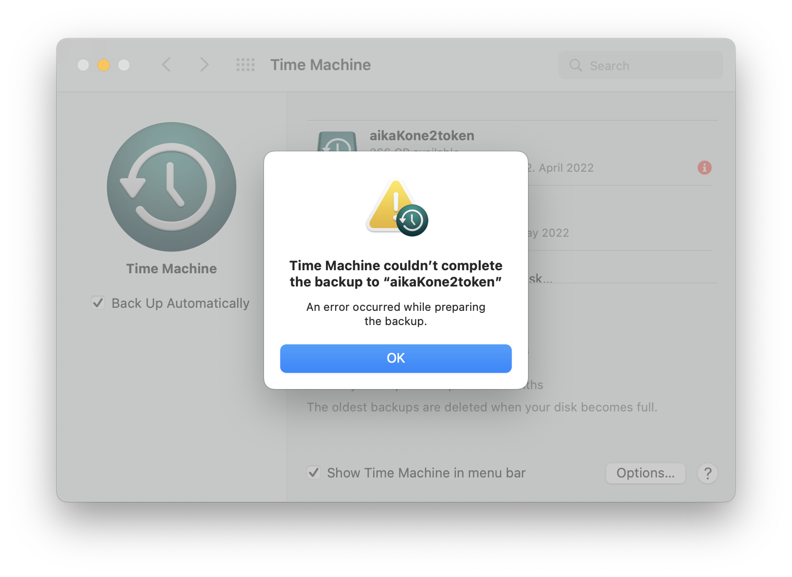

Apple doesn't offer much info about this.
I've downloaded Consolation3 and T2M2 from https://eclecticlight.co/consolation-t2m2-and-log-utilities/ .
If there are people "in the know" and willing to help, I'd like to know what next?
My TM disk is almost full, but it shouldn't break TM as it should just free some old backups from there.
Disk Utility uses a lot of time when trying First Aid, but founds nothing.
The physical TM disk is constantly spinning with reading sound, is Spotlight at work?
2022-05-14 14:10:12.693425+0300 Unmounted local snapshot: com.apple.TimeMachine.2022-04-22-201225.local at path: /Volumes/com.apple.TimeMachine.localsnapshots/Backups.backupdb/Toke’sMini2018/2022-04-22-201225/HDDhomeDir source: HDDhomeDir
2022-05-14 14:10:21.403164+0300 Backup failed (304: BACKUP_FAILED_PREFLIGHT_STAGE_SNAPSHOT_DIFFING)
2022-05-14 14:10:21.443064+0300 Starting automatic backup
2022-05-14 14:10:21.444135+0300 Backup failed (18: BACKUP_FAILED_TARGETVOL_NOT_FOUND - The backup disk could not be found.)
2022-05-14 14:29:00.020145+0300 localhost backupd[5503]: (TimeMachine) [com.apple.TimeMachine:EventCollection] Failed to enumerate snapshot diffs, error: Error Domain=NSPOSIXErrorDomain Code=92 "Illegal byte sequence"
2022-05-14 14:29:00.020901+0300 localhost backupd[5503]: (TimeMachine) [com.apple.TimeMachine:EventCollection] Failed to collect events for "HDDhomeDir" (device: /dev/disk7s1 mount: '/Volumes/HDDhomeDir' fsUUID: DE4B9586-ED5A-48FB-B94A-669A77C8FB0D eventDBUUID: 22B6D95B-D5ED-439B-8EC1-AFA55181083B), strategy: snapshotDiffing(liveVolumeMountPoint: file:///Volumes/HDDhomeDir/, earlierXID: 827418, laterXID: 865185, startDate: 2022-04-22 17:23:37 +0000, previousCloneCacheURL: Optional(file:///Volumes/aikaKone2token/Backups.backupdb/Toke%E2%80%99sMini2018/2022-04-22-202447/.DE4B9586-ED5A-48FB-B94A-669A77C8FB0D.clonedb)) , error: Error Domain=com.apple.backupd.ErrorDomain Code=304 "(null)"

Found a fix to TM problem:
Renamed “Latest” to “LatestX”. Then made a new alias to 2nd newest backup and named to to Latest.
Fired up the TM and it has happily done it’s duty since that. 2 hours and 20GBs later I have a fresh backup.
So the last backup was corrupted and by making TM to forget-about-it, it made a new a new incremental based on the 2nd newest increment.
This has happened now twice to me after last xmas, when I upgraded to Monterey.

Update:
Alias naming trick didn't work for the 2nd time.
Now I have another hfs+ TM disk, that I can't use anymore:
1663514773353-png.2070875
I guess TM backupping to hfs+ in Monterey is so broken, that this will eventually happen with any drive.
Quite sad, the state of Apple's software quality these times.
They stopped documenting things, maybe because how many things are broken.
If anybody's interested why "an error occured", here's a log from Consolation3:
