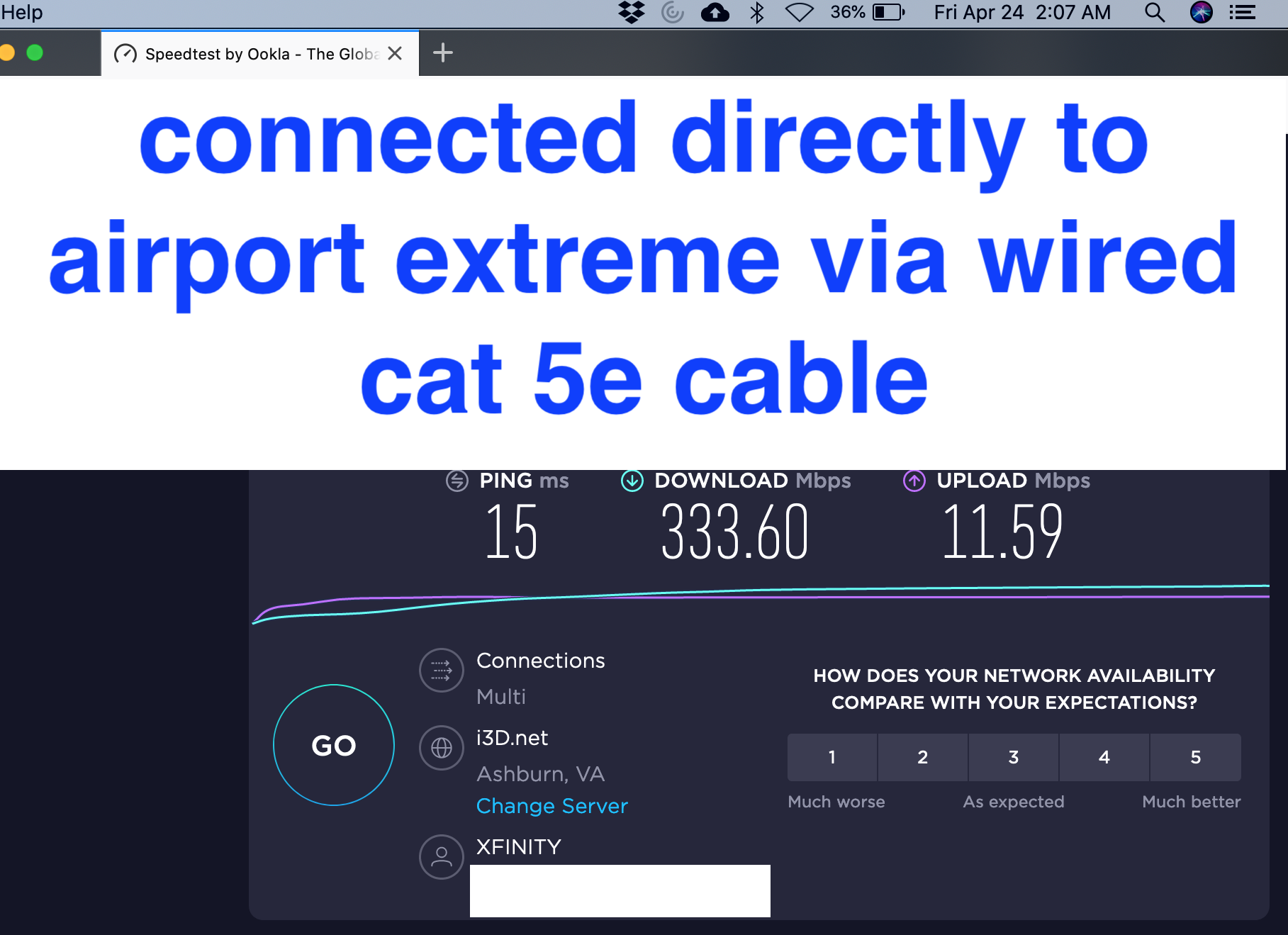

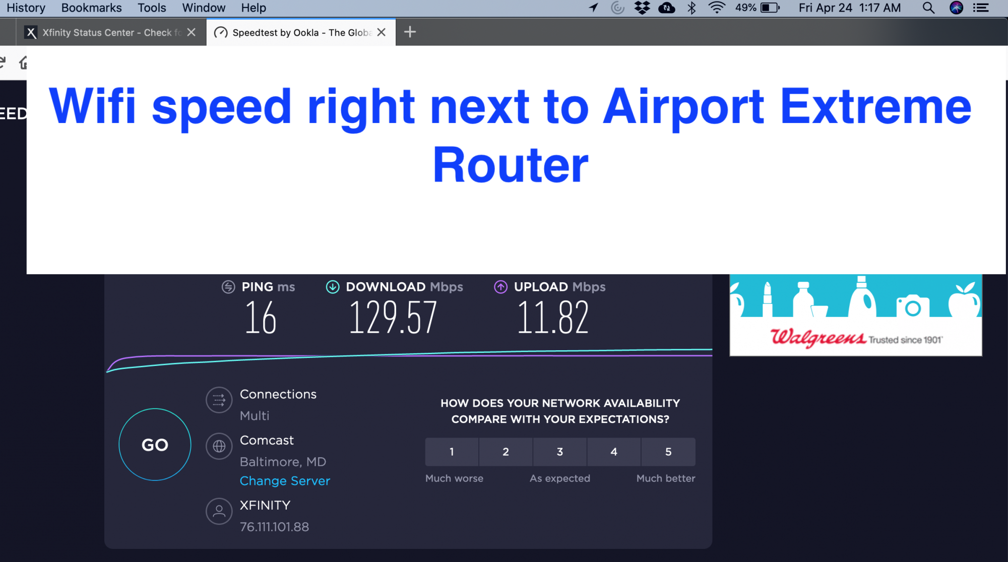

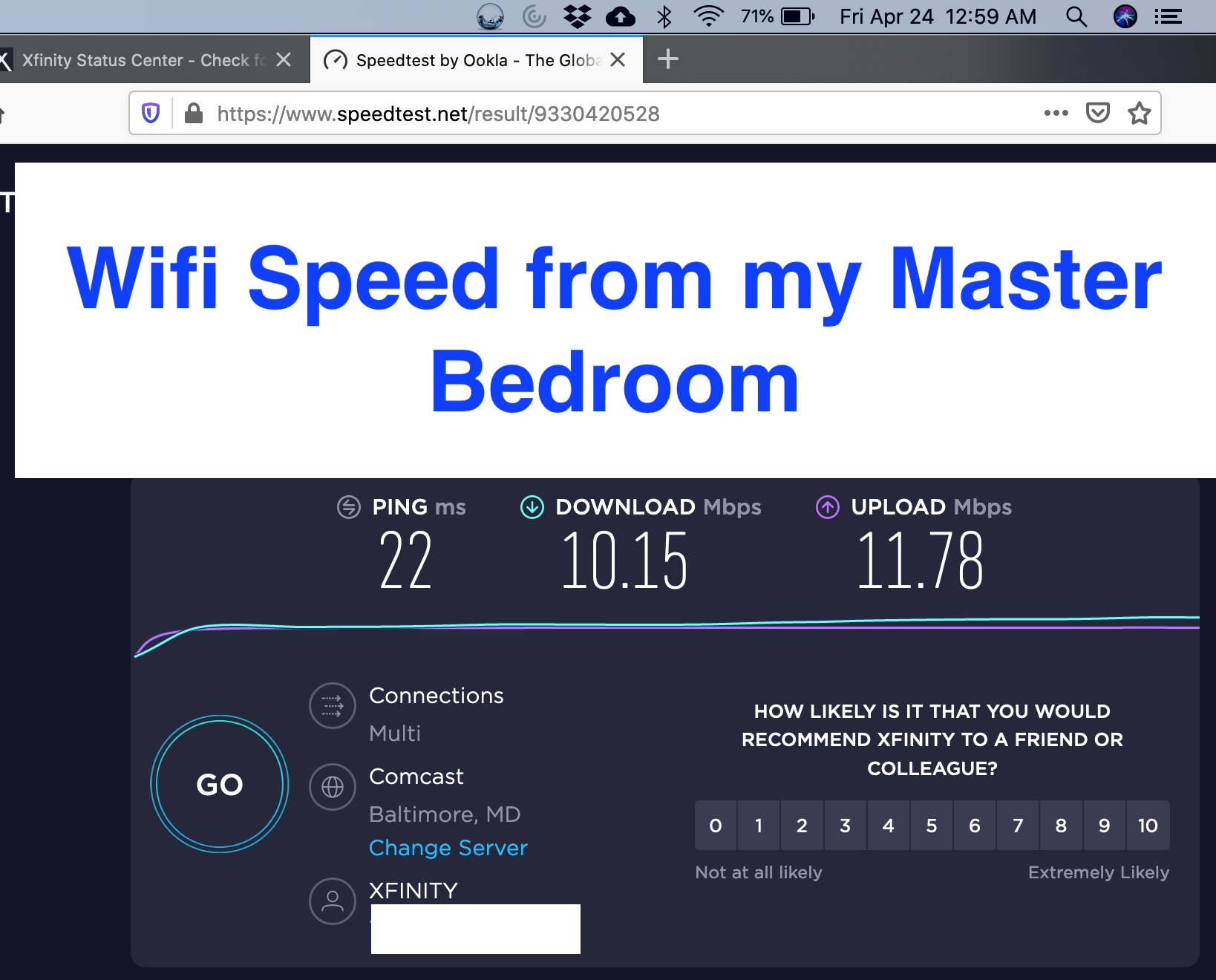

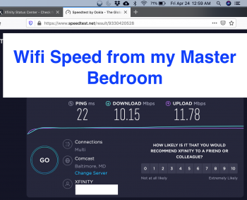

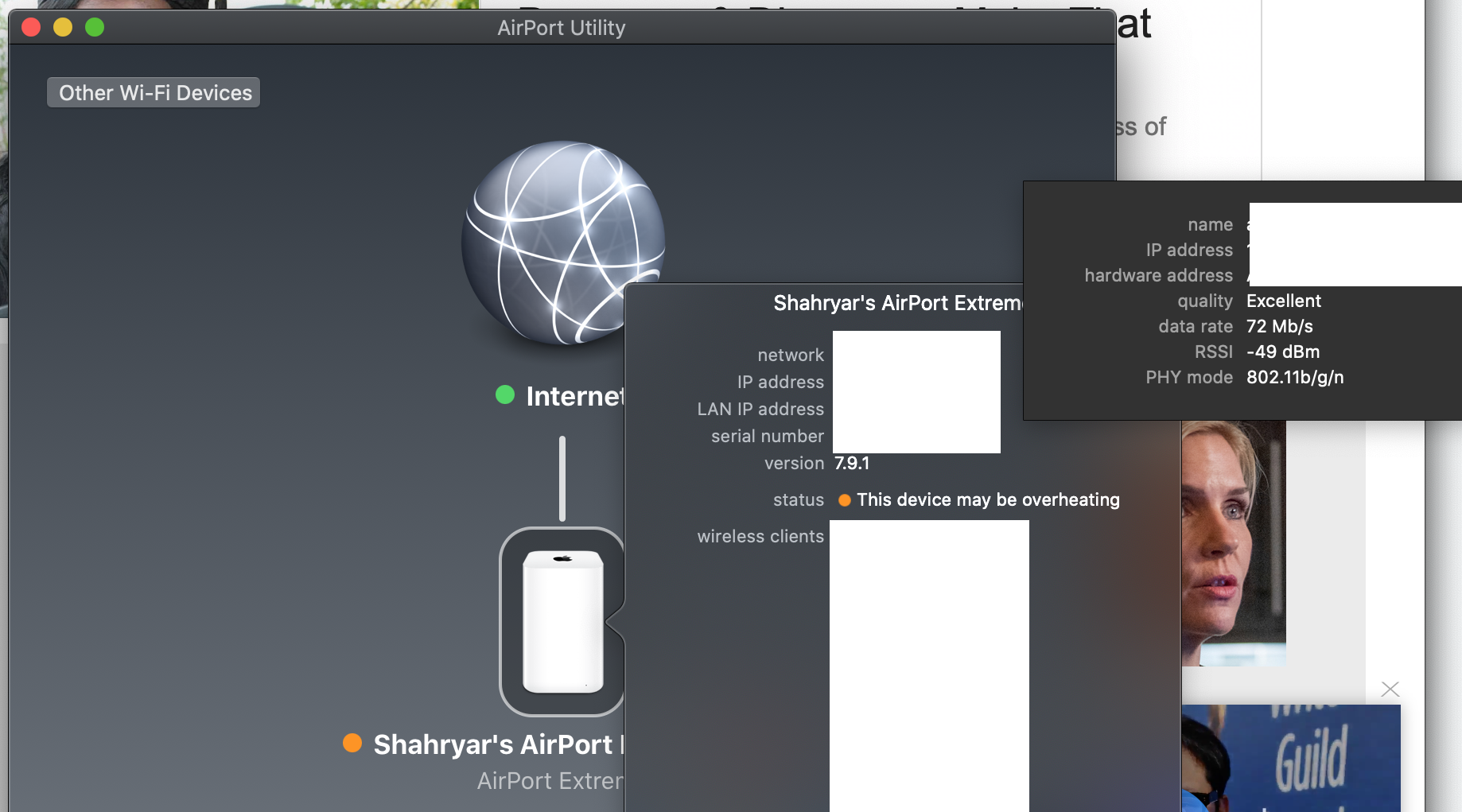

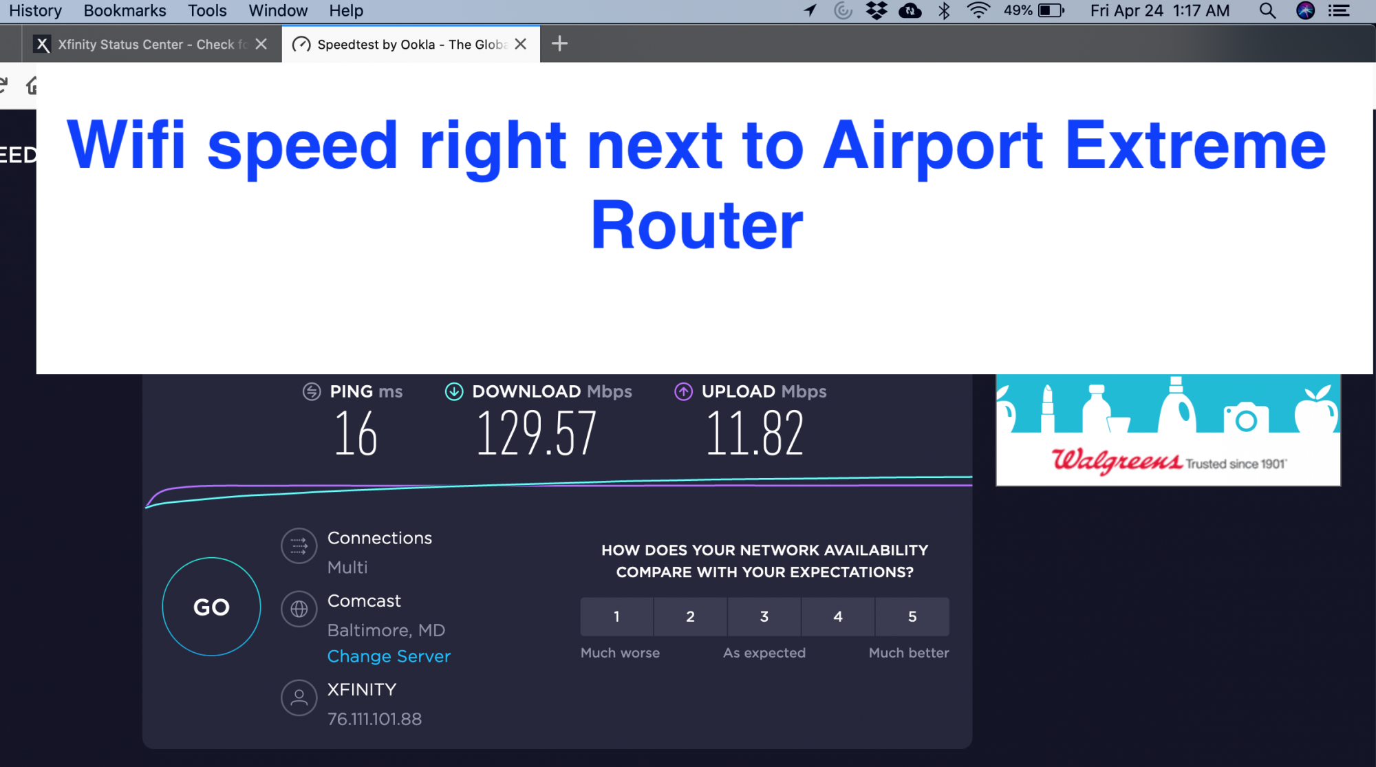

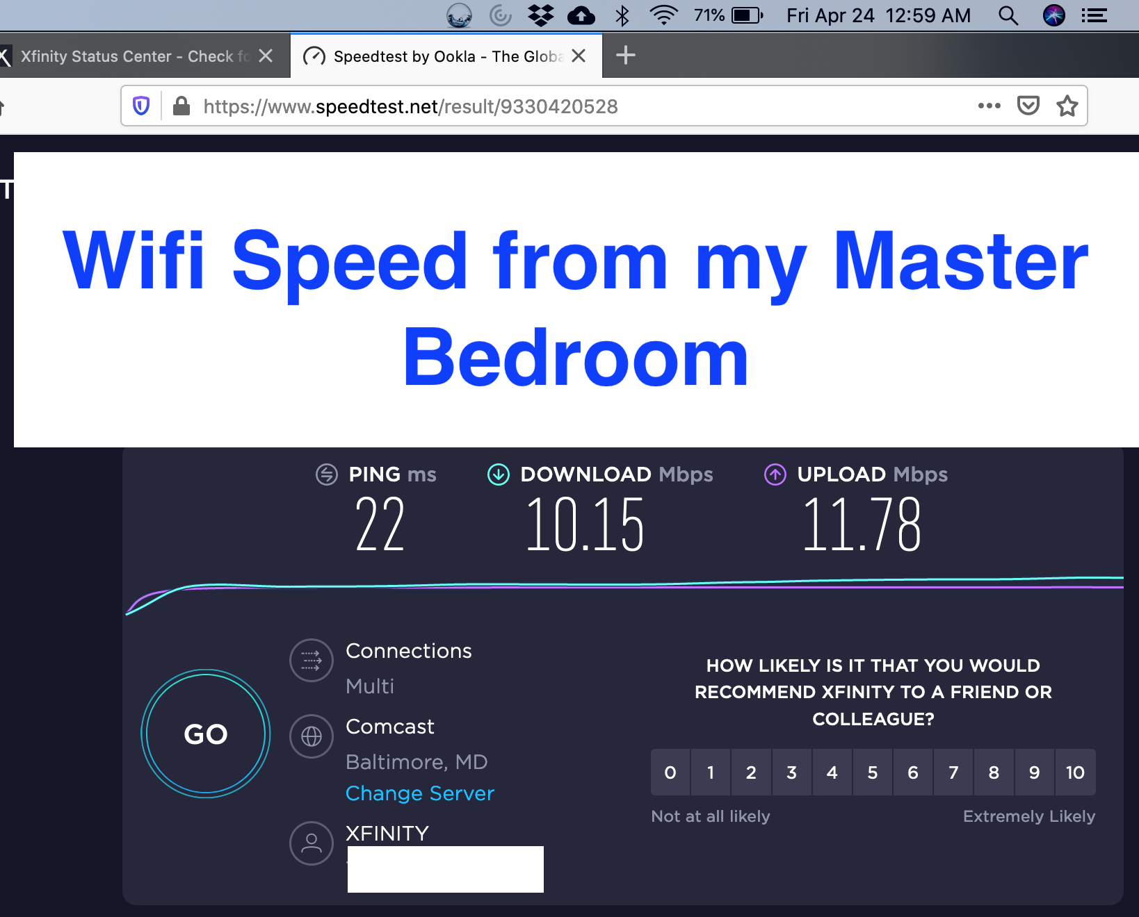

I bought my current Airport Extreme Base Station (ME918LL/A) A1521 6 years ago when the comcast xfinity plan I was using it with was at 50Mbps/down. At that time, seemed no issue with getting my full speeds. But now the Xfinity speeds of my same old plan are at 300 Mbps and I did some speedtests with my laptop and best I'm getting off wifi right next to the router is around 135Mbps. When I connect via an ethernet cable, I'm getting the full 300+ Mbps speed - both to and from the airport extreme. So it's the wifi alone that's the bottleneck.
Looking at the specs it seems the Airport Extreme should be doing up to 1.3Gbps/down without issues. So I'm not sure what's going wrong. One issue of late I've noticed is that it seems to have an overheating issue now so maybe that's the reason? This could mean I have to replace it unless there's an easy fix. If I'm replacing, this post stood out:
I would get the best Ac router that has Time Machine Server software inside it the Synology RT2600ac. Then if you want mesh with that router get the Synology MR2200ac!
This way I could keep my wireless time machine back-ups going on our macbooks.
Whether I get a new wireless router or somehow fix and get proper wifi speeds out my current airport extreme, I do need to get an extender or mesh system or something going because the signal gets weak in my master bedroom. For anyone in here with a mesh system and real fast internet - 200 Mbps + - are you guys getting full speeds off your wifi all around the house?
For now I've changed my internet package to a slower one so I'm at least getting my money's worth from that. Once I fix this all (or opt for the ISP's rented equipment), I'll look into faster speeds because I could def use them for my normal use.

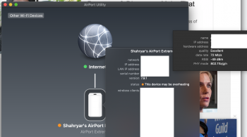

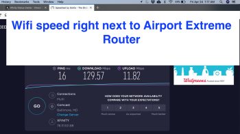

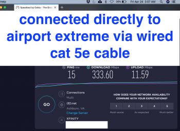

Every home is different in terms of layout, construction materials, presence of interference, etc. But the short answer is yes, you’ll be much more likely to get full or near full speeds with a properly sized mesh system.
It’s worth noting that rated wifi equipment speeds are entirely theoretical, in a lab, under ideal conditions. It’s common to peak at ~half the rated speed in practice. Any good modern mesh system should be capable of 200Mbps+ within reasonable range, however.
