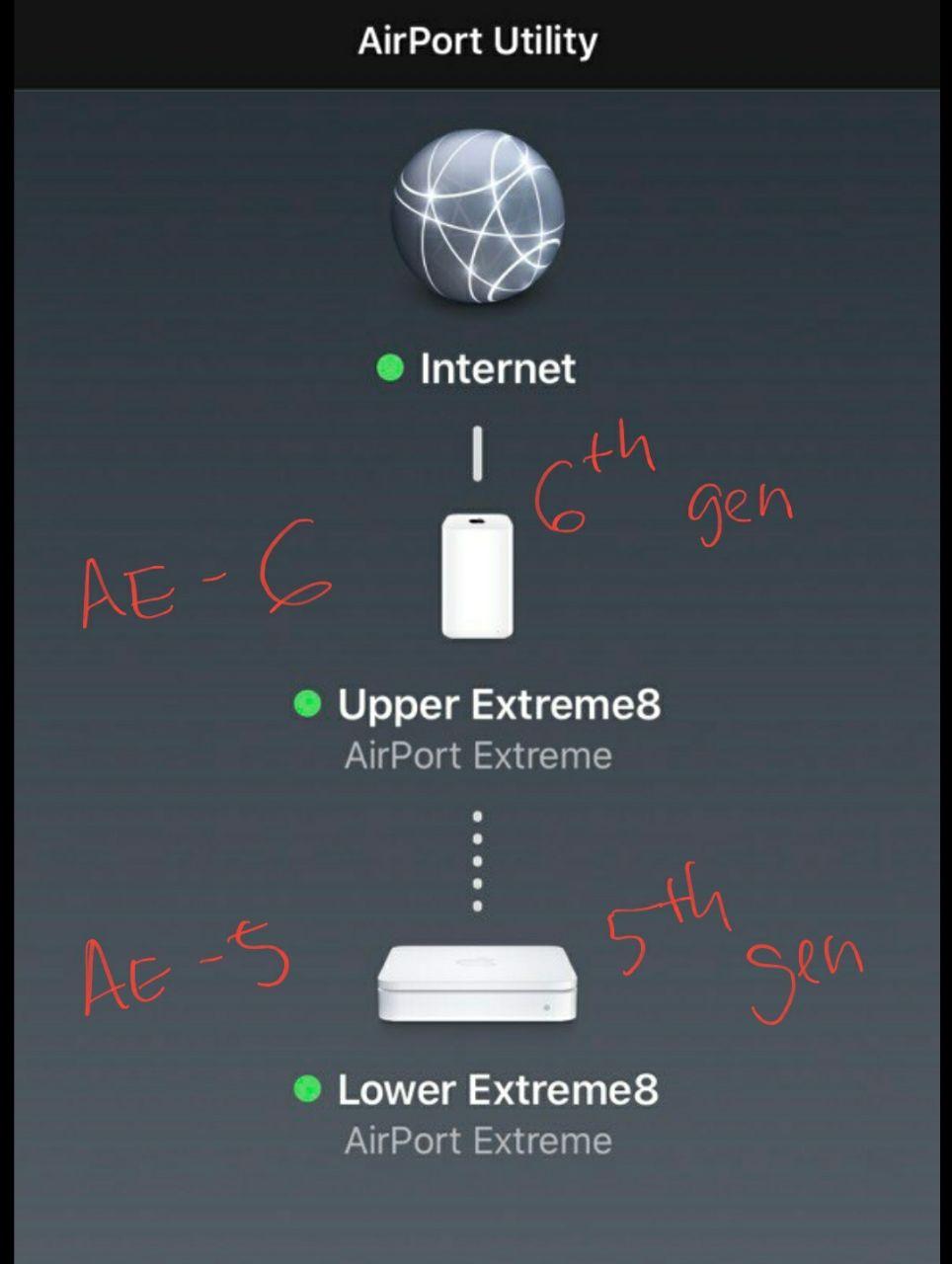

hi @xraydoc
your post inspired me as I have the 5th-gen AE at that time.
I tried to replace AE with Tenda Nova Mesh MW6 last week (3-nodes) and use LAN cable as the backhaul; Tenda Mesh covers all areas with good signal, however the performance was not stable, throughput is always up & down, especially the upload (I have 100mbps internet, and stream my cctv to other location 24x7).
When I was using AE the upload is stable, around 85-95 mbps all the time. Switched to Tenda MW6 it was down to average 70mbps and sometimes got cut off totally, similar case when streaming Netflix the first 1-2 minutes is at the lowest resolution.
After reading your post, I decided to go back to AE, and bought myself a used AE-6th gen

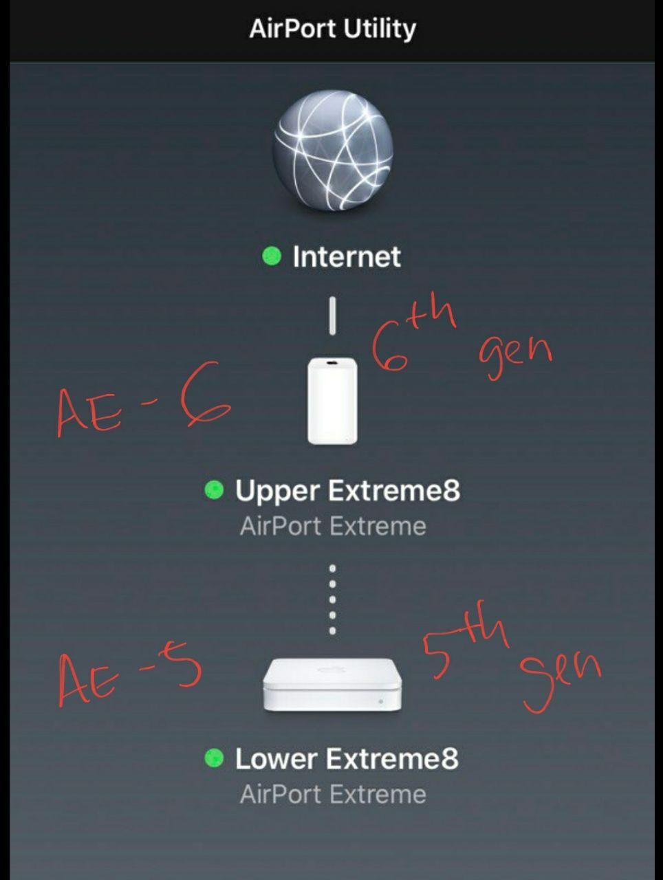

I like to understand more of your setup here since I have 2 AE (one 6th gen/ac version + one more 5th gen/n-version), currently my setup is as below:
1st AE/ac version (called AE-6), setup as a BASE/ PRIMARY (located upstairs where my internet connection came in), all set and run properly
2nd AE/n-version/5th gen (called AE-5), tried to setup as the EXTENDER:
(a) hard reset the 5th gen, and the turn on the power, then get my iphone open the airport utility & connect to the AE-5
(b) found the AE-5, and it automatically offer me to extend to existing wireless (which powered by the AE-6)
(c) all done automatically thru the wizard, and few mins later all done, my AE-5 become the wifi extension (then I connect a gigabit LAN cable to serve as the LAN backhaul; plug into LAN port on AE-6 and WAN port on AE-5
notes:
* AE-6 is located around 7-8 meters from AE-5 but on 1 floor below
*both AE-6 & AE-5 are on the latest firmware
problem that I found:
(1) if I'm using LAN cable as the backhaul, after few minutes the internet connection will stop to function (both AE-6/base & AE-5 Extender)
(2) if I'm using wifi as the backhaul, the setup is working but the 5GHz will not functional (can be found but no internet connection)
what do I need to setup these properly? tried to find some info/videos on the internet, all referring to the "bridge" menu" which no longer available anymore on the latest firmware
thank you

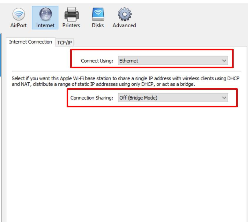

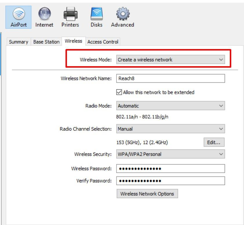

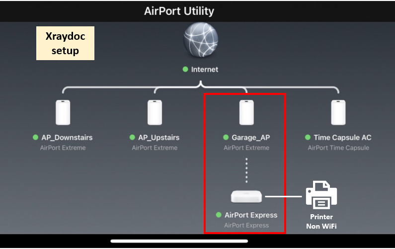

If you have Ethernet as a backhaul for each, you don’t need to set up either one as an extender. Just set each one as a normal wifi base station and give each one the same SSID and password.
Now, I don’t know what will happen with your individual devices since one Airport is not 802.11ac and the other is (they might try to hang on to a weak signal).
But otherwise, mine are not set as extenders. The extender mode is only if the far base station can’t be plugged in to Ethernet and instead must itself communicate over Wifi.

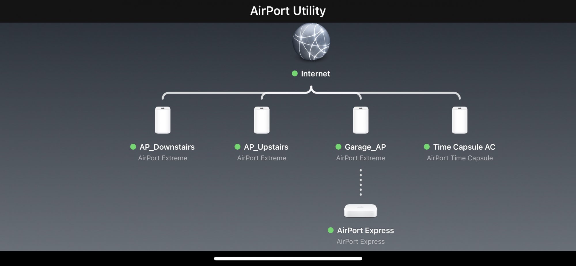

I’ve attached a picture of my network in the Airport app. Note that the Airport Express that’s shown is being used as a wifi-to-Ethernet bridge only, to feed Ethernet to a non-wifi printer that’s not near an Ethernet jack.

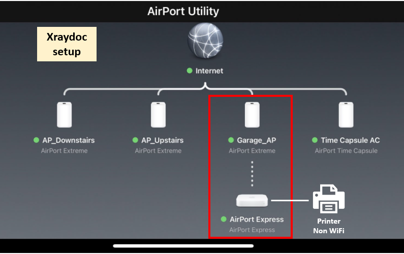

I’ve attached a picture of my network in the Airport app. Note that the Airport Express that’s shown is being used as a wifi-to-Ethernet bridge only, to feed Ethernet to a non-wifi printer that’s not near an Ethernet jack.View attachment 960156

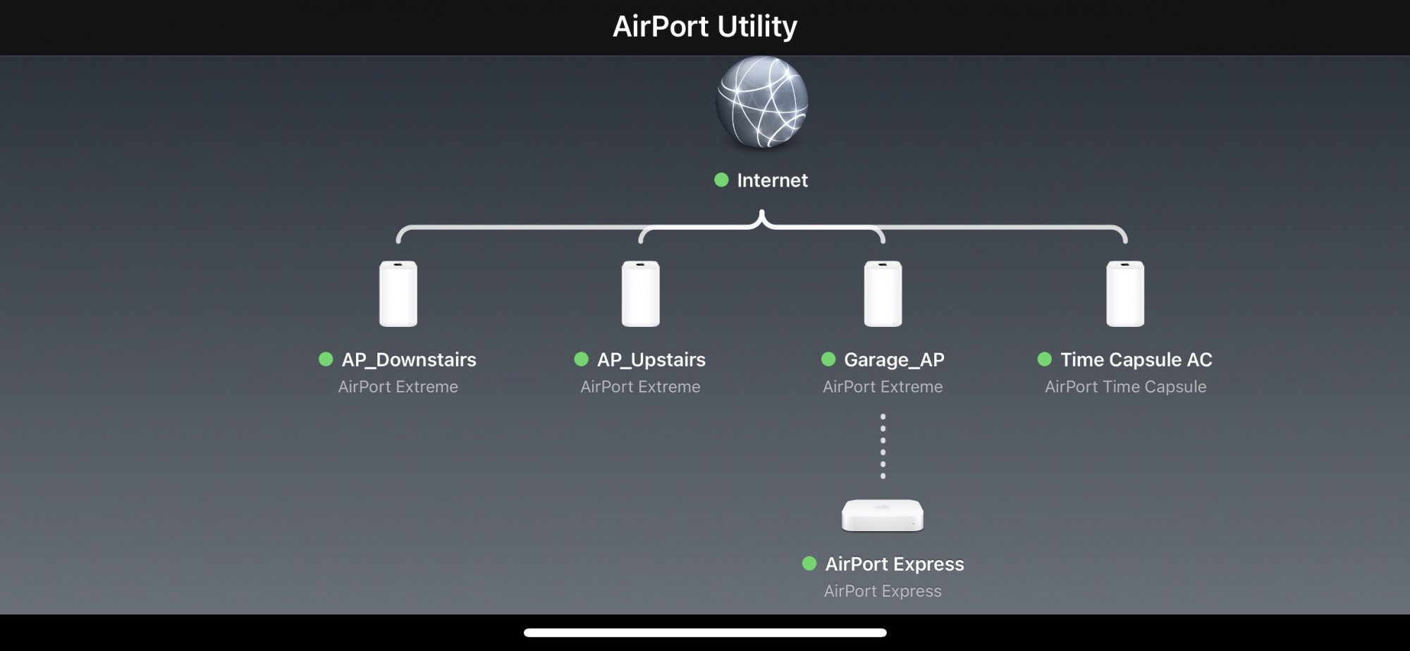

hi @xraydoc
THANKS! rework as you noted above, and seems that all are working now 😀
just testing now whether it's stable or not, but 5GHz is working on both floors now
just want to do a quick check with you on the setup, whether I got all thing in place
here are the final screenshot on the app now, it's using LAN backhaul

Looks right I think.

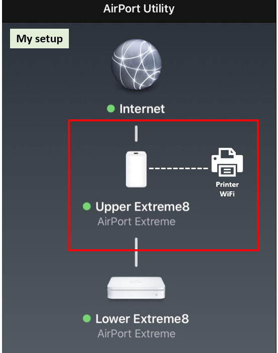

@xraydoc
referring to your post
"Note that the Airport Express that’s shown is being used as a wifi-to-Ethernet bridge only, to feed Ethernet to a non-wifi printer that’s not near an Ethernet jack"
are all other users within your network can access/print to the "non-wifi printer attached to the Airport Express" ?
or only limited to those users within red box?
in my setup below, only users within red box can print (printer is WiFi connected to the Upper AE)
thank you

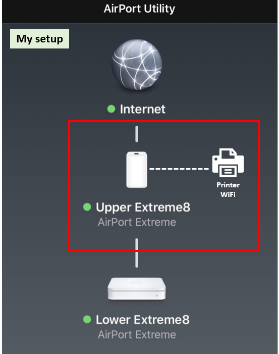

@xraydoc
thank you
Everyone can access the printer, regardless of which Airport basestation they happen to be connected to, which, generally, isn't known to the user since they all have the exact same SSID and password. The only way to tell is to look at the list of devices connected in the individual Airports' settings.
In fact, the Airport Express (to which the printer is wired by ethernet) itself occasionally changes which Airport basestation it connects to (since it's connected via wifi). It's equidistant to the ones called Garage and Downstairs, so it will connect to either one or the other and changes once a week or so.

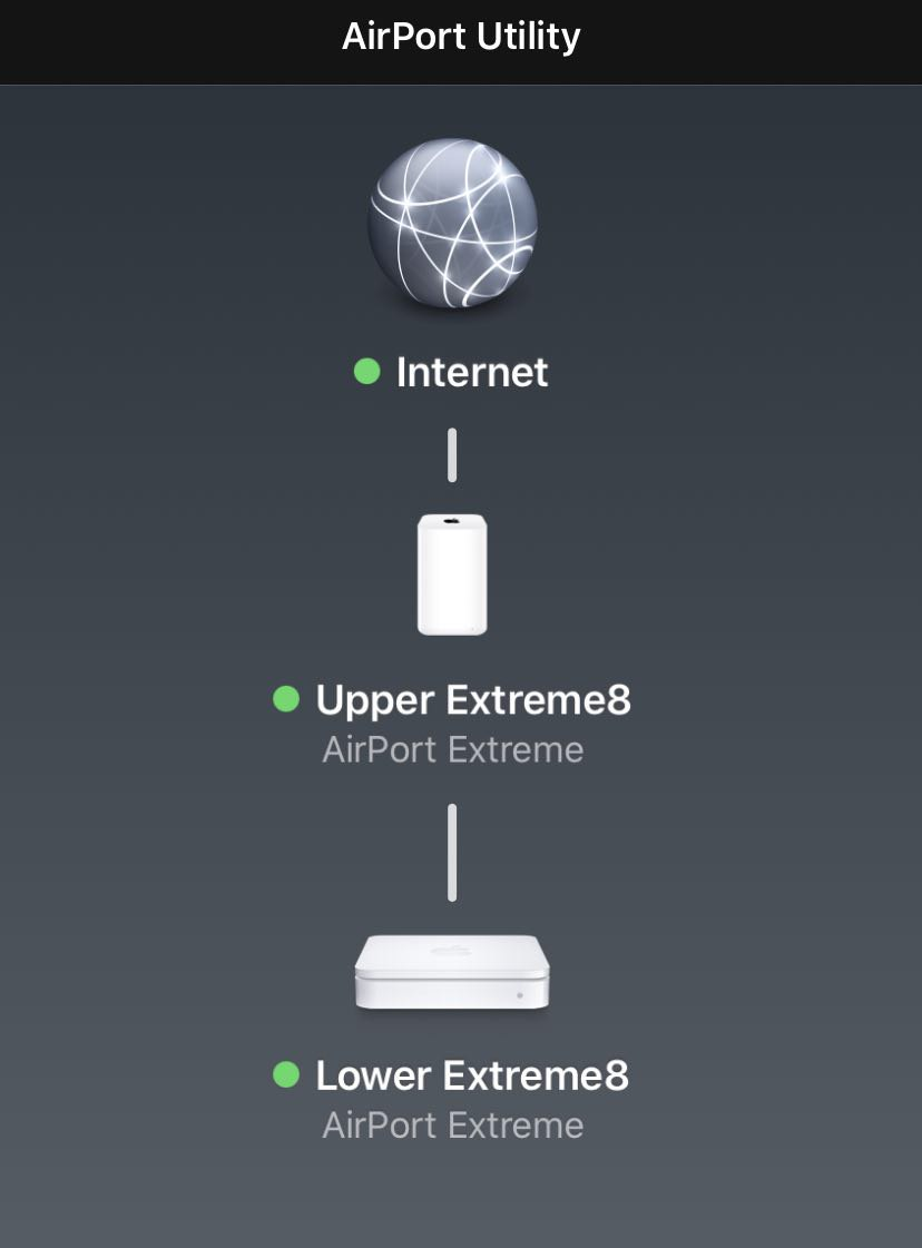

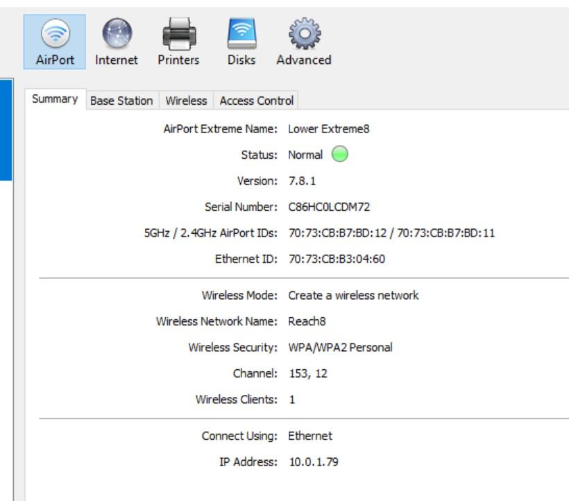

I have a cable modem, to which a 24-port gigabit ethernet switch is connected. The cable modem is responsible for the NAT and DHCP ethernet address assignment. To that, all the ethernet cable in the house is connected (and thus each Airport, plus tons of other hardwired devices). Each of the 4 Airport basestations, plus the printer's Airport Express, are in bridge mode (thus they do not provide their own NAT or DHCP assignments).
In your picture, it looks like the Lower Extreme8 is strung off the Upper Extreme8. Make sure you don't have a double NAT happening, which may be why you're having trouble accessing the printer.
