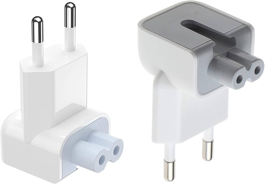

I'm using the included usb c MagSafe adapter (EU 230v) with the MacBook Air M3. Apparently from what I've read online, MacBooks and other metal laptops can produce a slight tingling sensation when ungrounded, but using a grounded plug fixes it. One thing I couldn't find out is whether the orientation matters when plugging the ungrounded adapter into the outlet. It does in my case as the issue is simply gone when I rotate the adapter. I called an electrician in my country who didn't even understand the question as he just said "AC power doesn't have an orientation, so it doesn't matter". Then I asked him about American outlets which apparently do have an orientation and he just repeated what he had said.
I guess my questions are why does rotating fix it and could there be any issues with my electrical system?

Are you plugging the adapter in with a two prong plug or three prong? If you are using a two prong it won't be grounded. If you are using a three prong - have you tried a different outlet?
Two prongs. I've tried multiple outlets in different rooms.

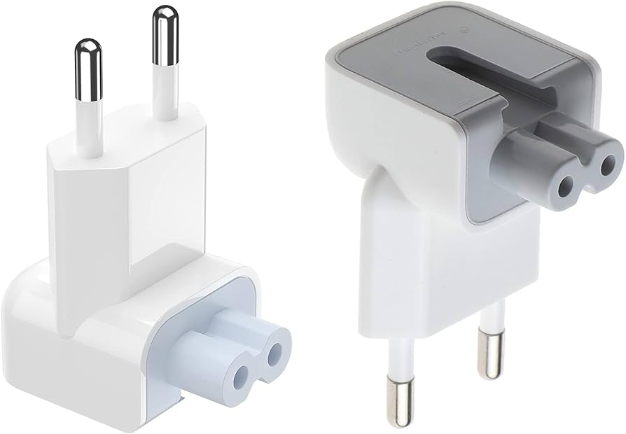

The orientation shouldn't make a difference, at least it doesn't for me in the US when using the two-pronged plug our MBAs/MBPs ship with. I feel the tingling when it's plugged in either orientation, but only when I'm touching the floor. If I'm insulated (wearing shoes, sitting in a chair, etc.), then I don't feel any tingling. Nor do I feel anything when using the grounded extension cable while touching the floor.
Since you only feel it when it's plugged in a certain orientation, I wonder if your neutral might also be wired to ground. Your electrician should be able to determine that, and know whether that's legal or not.
Some countries, like Japan, don't use a third prong for ground...they only have two prongs, and ground is built into the neutral prong. As far as I'm aware, I think Japan is the only country that does that though. Here's a video explaining it, if you're interested.
Just for more context... I'm guessing what you've read online was largely based on North American outlets. In North America, our outlets have two prongs for power (hot and neutral) and a third for ground. The plug we receive with our MBAs/MBPs only has two prongs so it can flip up and be compact. If we want to ground it, we need to use this extension cord to get the third/ground prong. (The ground contact is around the button/pin on the adapter that the connector slides onto.)
You might want to see if there's an equivalent version for your country. For example, here's one for Germany:

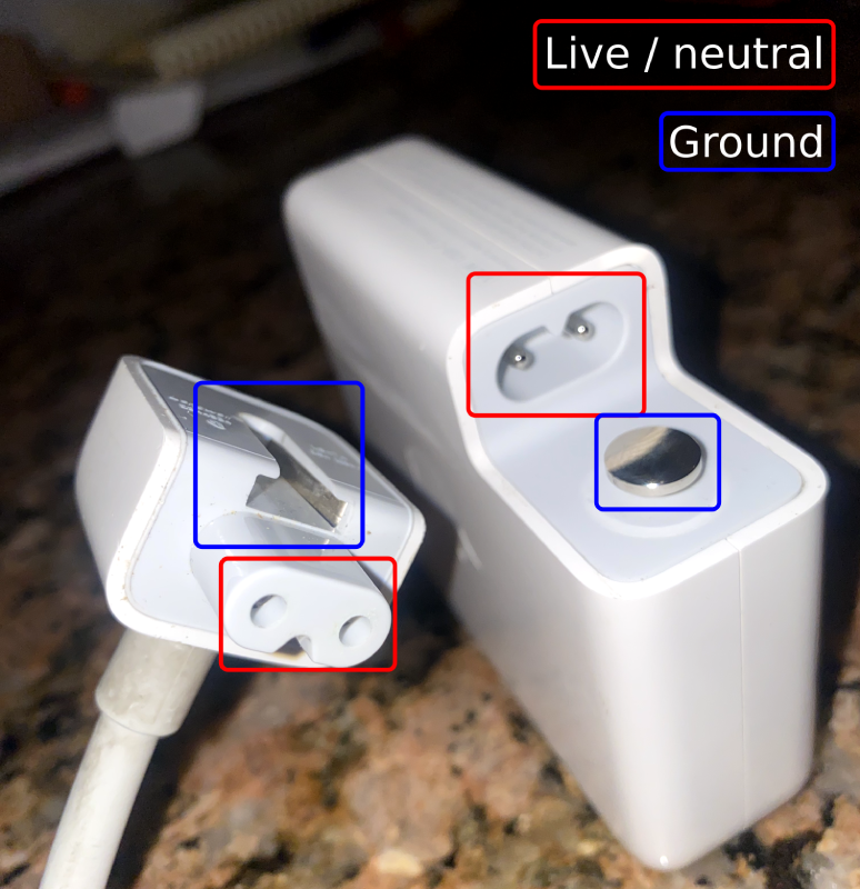

There are still just two power connections to the power supply from the cable. There is no ground connection in the power supply plug. What may be happening is that internally within the cord Apple has electrically connected the ground to the neutral.

This one. My old MacBook Air and Pro from back in the day came with a grounded cable as well that was longer.

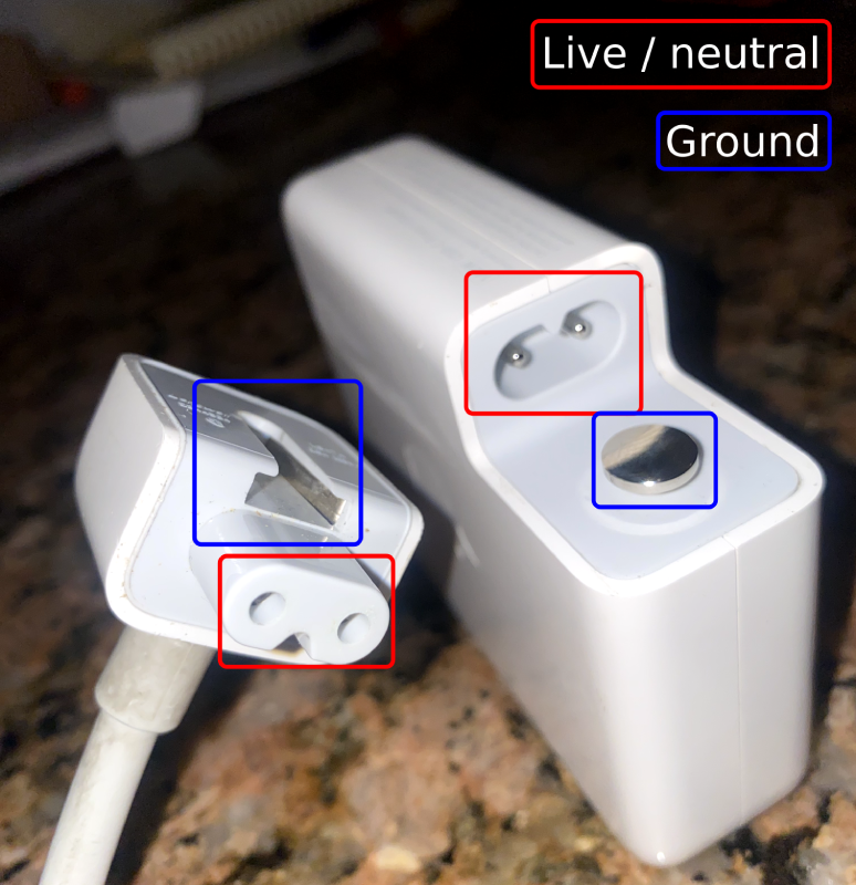

There is a ground connecter on the adapter. Like I said, it's the metal pin that the duckheads slide onto. The two-pronged duckheads don't have the metal/ground contact in the groove, but the one on the extension cable with the ground prong does.
Yeah, that one isn't grounded, nor would Apple ground it internally (since you have no way of ensuring which prong goes to neutral...which still isn't exactly safe unless you're in Japan).

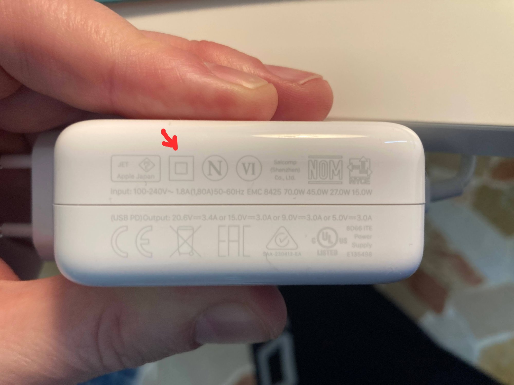

The photo in message #7 is a plug without ground, it should have 3 prongs where central one is ground.
I have what is described as ground connector on the power supply as in the image in msg #8 but this is not connected to anything metallic, just plastic.
Plot twist: but this is fine as this is not needed: on the power supplier there's the symbol of a square inside another square signifies "double insulation" or "Class II" and indicates that the appliance does not require a connection to electrical earth (ground) for safety. Here is last 70W Apple piece of HW:
Genuine Apple extension cables will use the metal peg as shown in post 8 as the ground, and the cable will have metal contacts that connect to the ground. When using those cables in a properly grounded outlet, you don't get that tingling sensation.
Reactions: arc of the universe
Mine is a genuine A product and still no metal contact.
Anyway it would be useless as the cable (in the same A box) has a 2-pronged plug instead of 3, exactly the same as in image in msg #8 (I live in EU).
