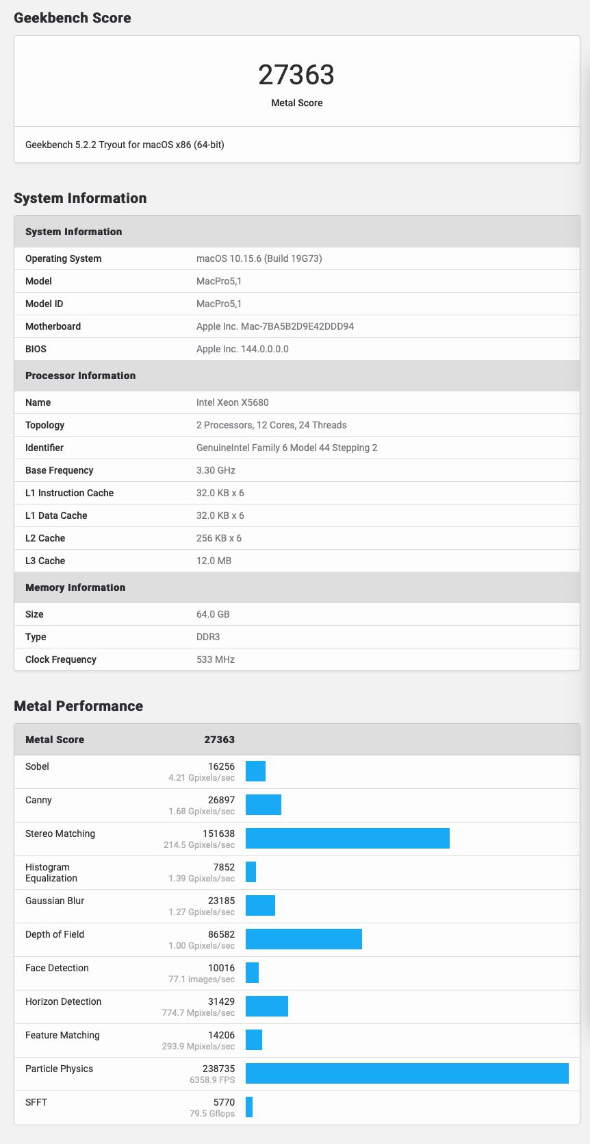

Hi. Any particular reason I can only get around half the normal score running Radeonboost 1.6/OC .59? Seems all my geekbench scores are pretty dismal.
