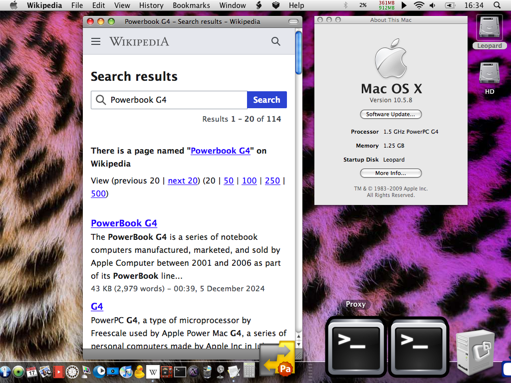

After being unable to find a solution which doesn't rely on having a second machine, I made my own basic proxy program for PowerPC OS X.
My program uses OpenSSL 1.1.1w to upgrade Webkit and other TLS/SSL connections to TLS 1.2/1.3, as needed. While I have only tested it with HTTPS with Leopard-Webkit, it presumably could work for other protocols and programs.
To set-up the program:
(a) download aproxy-0.0.1.zip
(b) unzip the program on your Desktop
(c) configure your Mac / Leopard-Webkit to use localhost:8080 for HTTPS proxy
(d) open a Terminal, go to the folder where you unzipped the files, and run ./aproxy
When you run the program for the first time (and whenever proxy-ca.pem expires), the program will generate a temporary CA root certificate that it will use. The certificate is set to expire every 90 days. The certificate generated will be stored in the file proxy-ca.pem, with the private key stored in proxy-key.pem.
The program will open Keychain Access and prompt you to add it as a trusted certificate.
However, if you prefer, you could also generate your own CA X509 certificates and import them manually, instead.
Note: If you don't add the CA certificate as a trusted root, you can still use the proxy, but Safari will prompt you multiple times to accept certificates and there will be some errors on webpages (most often images will loading).
Let me know if you have any questions.

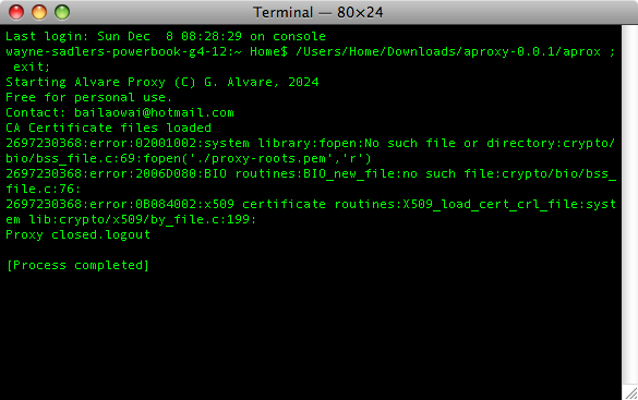

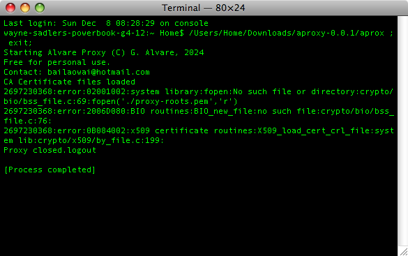

@GA204 Running aproxy generates the certificate but LWK won't connect. Running aproxy again gives the attached error.
Thank you for letting me know, I think I can see what's causing that bug.
Since I have only been using the program in Terminal, version 0.0.1 is expecting to run in the same directory that it's located and needs the root certificate store ./proxy-roots.pem to run properly. So, what's probably happening on your computer is that it is mistakenly searching for ~/proxy-roots.pem rather than /Users/Home/Downloads/aproxy-0.0.1/proxy-roots.pem This is because when you double-click on an executable, it runs it from the home directory rather than the directory the program is located.
In any event, I've updated to version 0.0.2 which should hopefully fix this bug. Please let me know if it still persists.

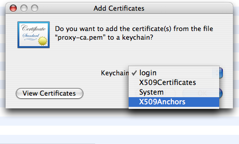

Yes, I've just compiled a beta release for OS X 10.4 Tiger.
However, unlike Leopard, whenever you are prompted to import the certificate on Tiger, you need to select the X509Anchos keychain. This will normally happen the first time you run the program and whenever the proxy's certificates expire and need to be regenerated (by default every 3 months). I've included a screenshot of the prompt below for clarity.
