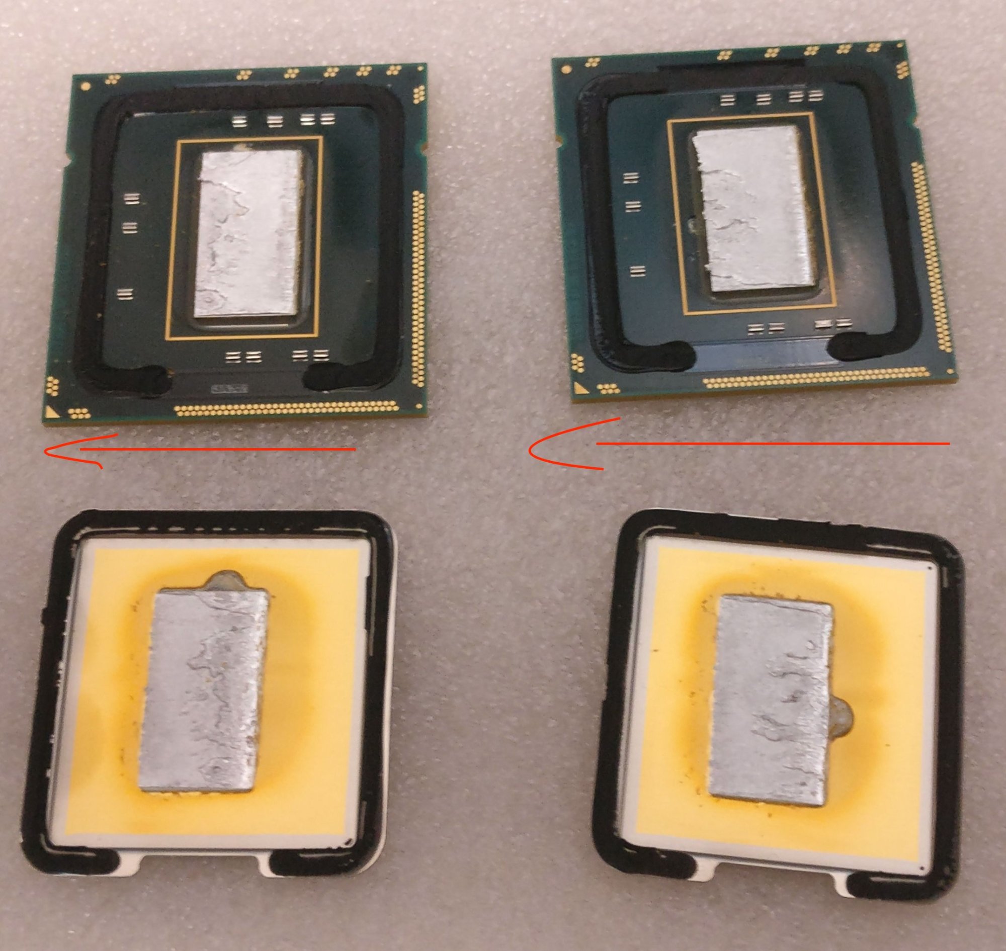

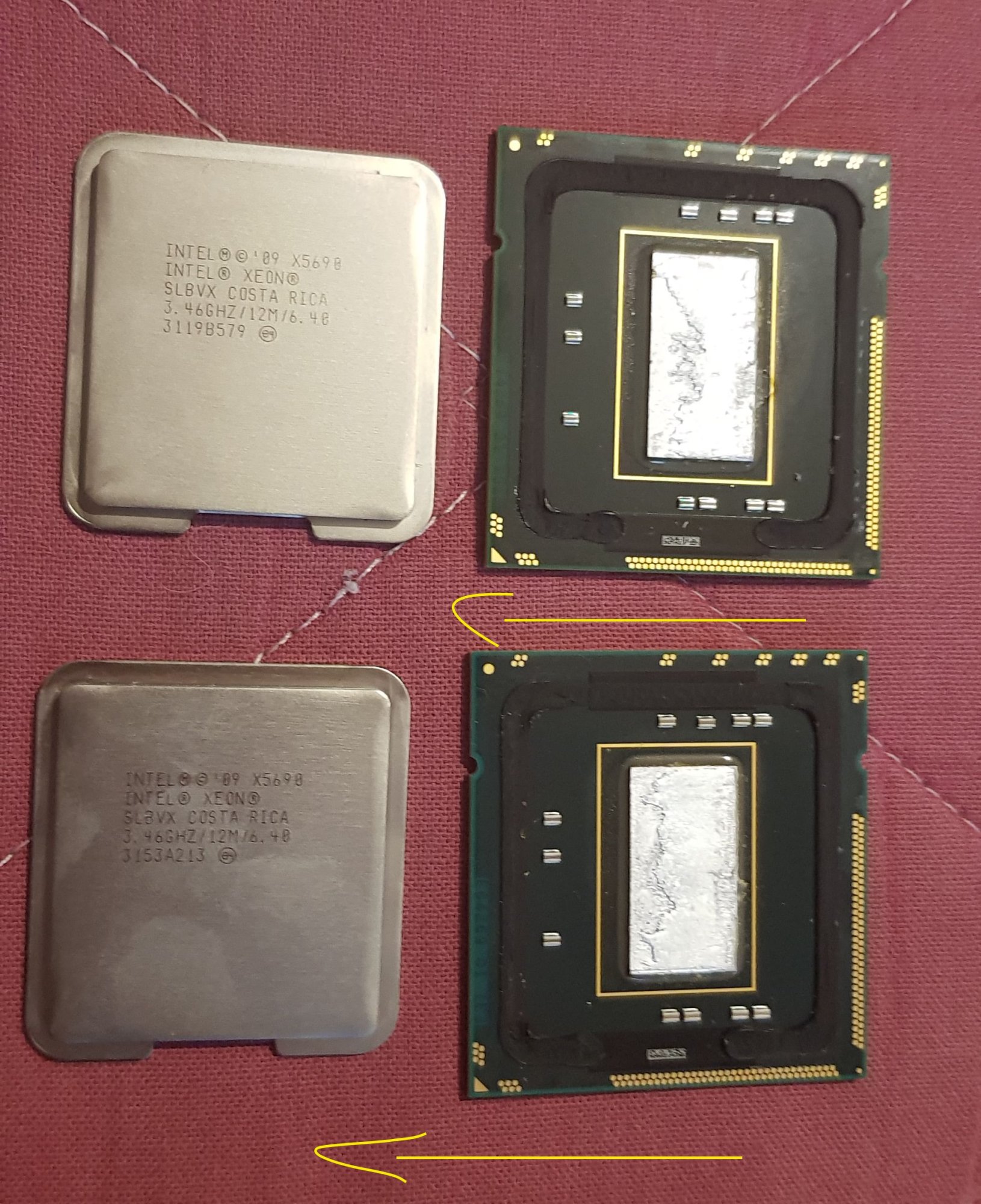

I would always delid other than risking damaging the CPU sockets. The procedure is not complicated, you just need to be extra careful about the SMD components on the CPU and slide the heat spreader in direction of the arrows.
I'v done this at least 6 times without issues.
