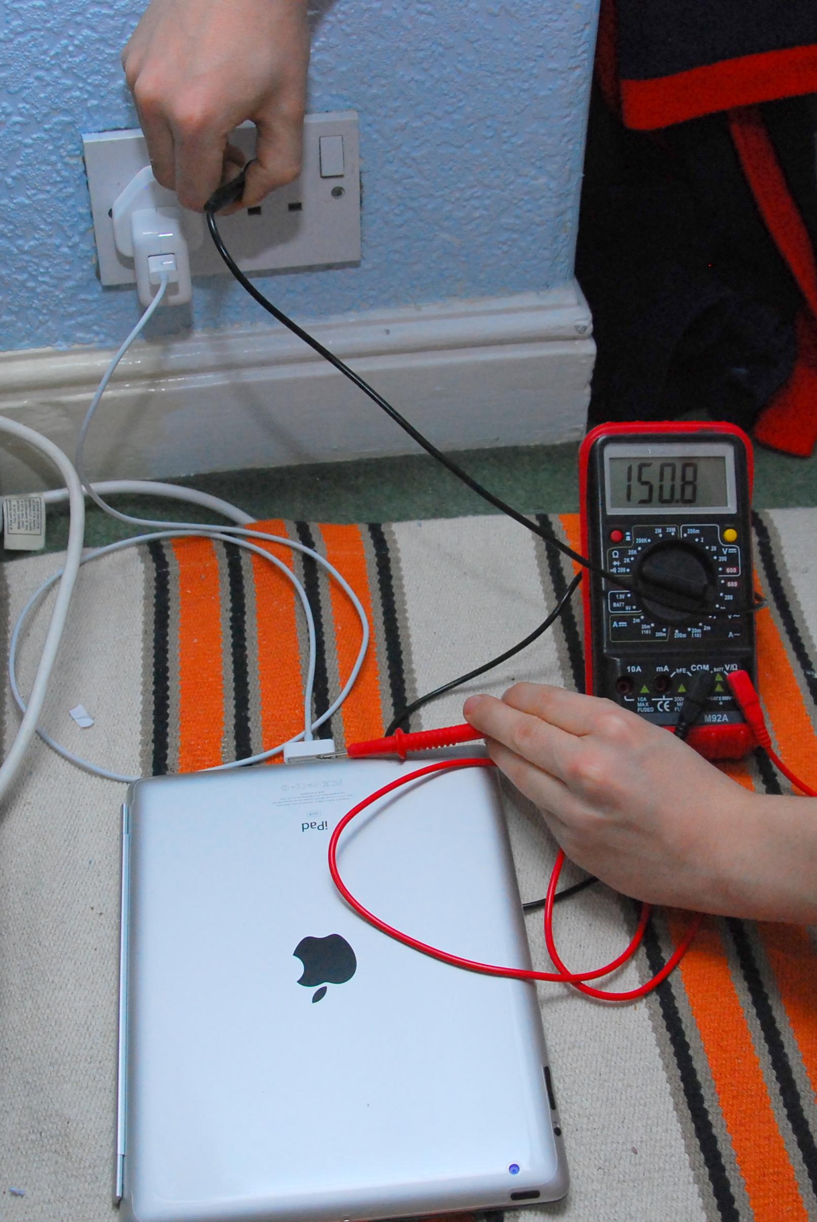

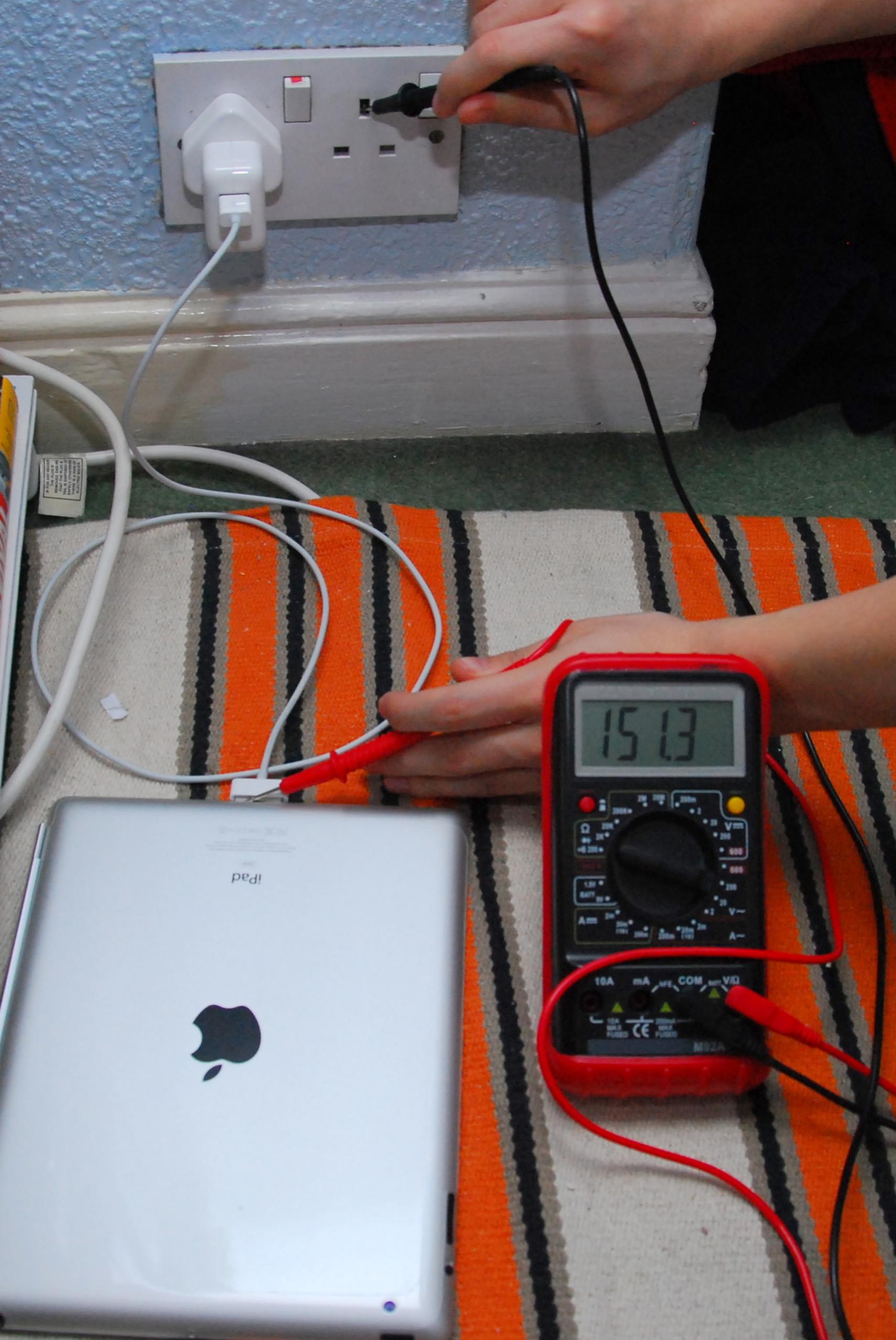

I get a "shock" like this if I touch my USB keyboard on my PC and the case of my MacBook at the same time. I'm pretty sure it is due to a slight difference in the ground voltage on the two devices. Nothing to worry about.
This brings me back to my MacBook Air, whilst it is charging. Try grounding the thing and see what happens. Same thing happens with an iPad 2.
See attached images.
Not great, and not really the same situation.
Your reading on your meter is set to resistance. The earth ground on your home and the chassis ground of the iPad could have 150 ohms of resistance. The chassis of the iPad is connected to your home outlet via a USB charger which carries a signal ground, so it is possible to have some resistance because earth and signal grounds are isolated. If you had 150V difference of potential, then I would be a little more worried.

I live in the US and don't know how your AC mains are wired but it looks like there is a problem with your outlet. Either that or you are measuring the wrong conductor.
If the case really did have 150+ volts on it relative to ground you could not touch it.
It's on the V100 selector, so it's about 1.503V going through it.
I've actually tested this at work and at someone else's house - no changes there.
Yes. That is reasonable and normal. It is common to have the neutral about 1.5 volts above ground. It is more common to see this in a larger building but it could happen in a house if you have a lot of stuff running on the branch circuit. The 1.5V is cause by voltage drop along the wire in the branch circuit.

This is an interesting experiment. It does show that you can measure a voltage differential, but it does not give an explanation of why or if it has any ill effects.
The first test I would do is to check the Usb wall wart for manufacture markings. There are people out there not really taking proper care when manufacturing things. Wall wart power can be dangerous and things manufactured the wrong way can cause harm. A usb wall wart should be double insulated, the sign is a double square. It should also be tested by something like UL. The testing for security includes things you cannot easily measure yourself without destroying the wall wart. I am not sure but, is it an Apple wall wart?
Secondly, this voltage is probably totally normal. My bet is that if you change to measuring to Ampere instead, you will not be able to measure any current at all. The voltage you measure is possibly induced and carries very little power. And the voltage measurement instrument is designed with a very high impedance input in order to not influence the measurement. Not beeing able to measure any current is a sign of a high impedance source which makes the voltage you measure non harmful.
