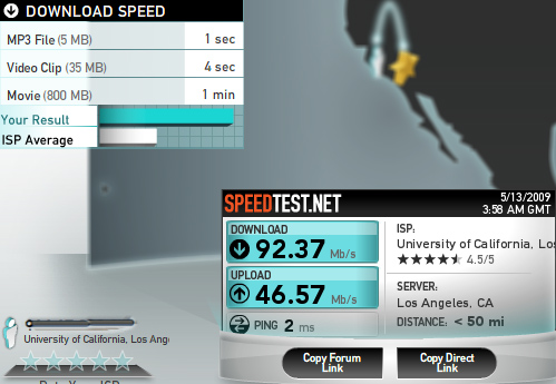

    Consider this a best case scenario ( my school throttles our upload speed for some reason, but download is unlimited )
    gigabit ethernet card on a T3 line
    [​IMG]
    iPhone on Dlink 80211 G
    [​IMG]
