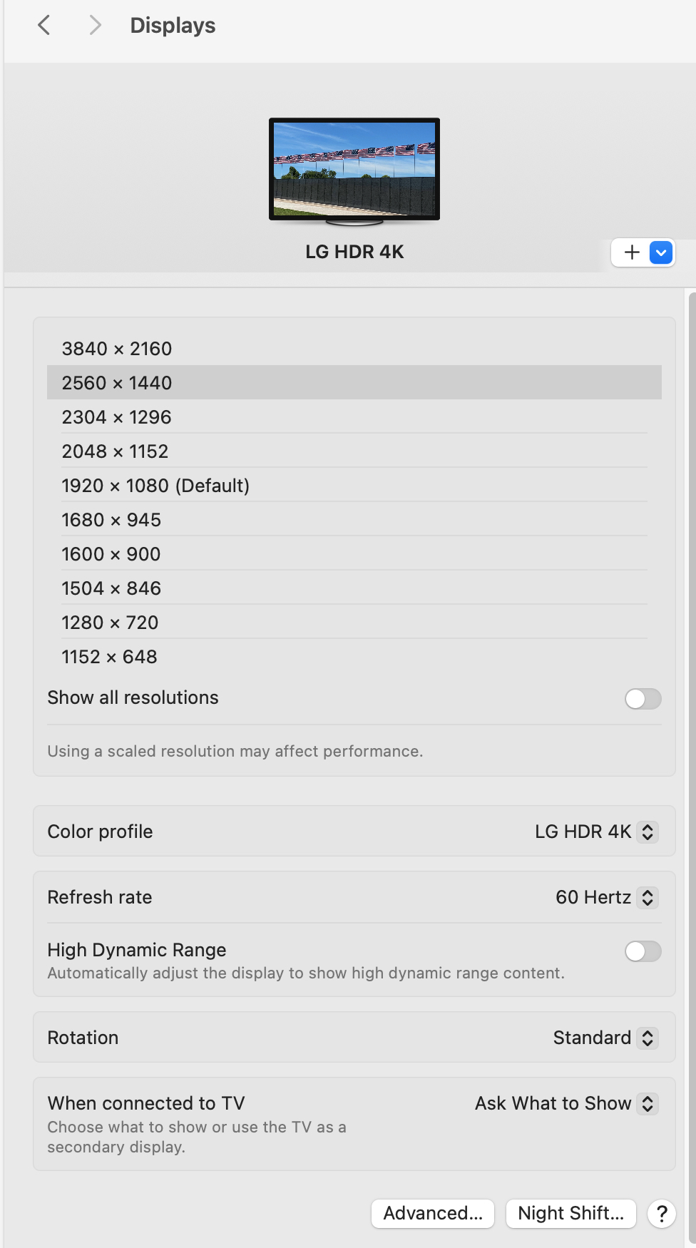

after setting up the Mac with HDMI cable the default shows 1920 x 1080 should I change to 2560 x 1440? when I changed it looked fine but saw some places recommending to leave on 1080 on a 4K monitor despite the fact that the icons look bigger is that true? is better to leave in 1080?
The reason 1920 x 1080 is recommended on a 4k monitor is due to the awful way macOS handles scaling. If you set your resolution to 2560 x 1440, macOS renders at 5120 x 2880. On a 5k monitor, this results in a perfect 1:1 pixel mapping. But on a 4k monitor, the image is scaled down to 3840 x 2160. This results in artefacts, blurriness, tearing etc. Unfortunately, to get 1:1 pixel mapping on a 4k display, you need to select 1920 x 1080.
Having said all of this, if 2560 x 1440 looks good to you, use it.

On a 4K 27" display using 2560x1440 is perfectly fine and gives an ideal UI size (if you do pixel art, you might want to switch to 1920x1080 to have the sharpest image possible and avoid scaling issues - but this is mostly irrelevant for normal desktop use).
No need to enable HDR on your display model (although it can technically decode a HDR signal, the contrast ratio and brightness is not suited for HDR content).

First thing, the way Mac OS describes resolutions is a bit misleading. Put simply:
“1920x1080” is really 4K (3840x2160) - but with double-sized system fonts, icons etc. which some people feel wastes a bit too much space on a 27” screen. If you jump through a few hoops you can choose “true” 3840x2160 mode, but you’ll probably find icons, menus etc. too small to use.
“2560x1440” is really a 5k (5120x2880) image “downsampled” to 4K. This way, system fonts, icons etc. end up the same physical size as they would be on a 5k iMac or Studio Display - which many users feel is “just right” (your mileage may vary). The downsides are that since a 4K display can’t reproduce all the detail of the 5k image, the result looks slightly “soft” and there may be some artefacts, or less-than-glassy-smooth scrolling if you try and look at single-pixel details. Also, the “downsampling” process (plus the fact that graphics apps etc. are effectively rendering in 5k) puts a bit of extra load on the GPU/Video RAM. This may have been an issue a few years ago with weedy Intel integrated graphics, but a M4 shouldn’t break a sweat.
As for HDMI - with a bog-standard 4K 60Hz display it makes sense to use HDMI and leave your Thunderbolt ports free for other things.
HDR - try it and see, but again - with a bog-standard display (no OLED, miniLED, quantum dots etc.) there’s probably no point.
Ultimately - all that matters is that it works for you and suits your workflow. Many existing Mac users have been spoiled by 5k screens (which used to feature in relatively affordable iMacs) which are probably optimal for Mac but come at a hefty price premium and limited choice - 4K UHD is a good compromise.

1920x1080 is "looks like 1080p", which I believe the Mac OS will use as the default setting when connected to a 4k display.
This is how it's supposed to be.
What the Mac is doing is "cutting in half" the full resolution of the display (3840×2160).
Thus, in "looks like 1080p", you have 4 "small" pixels representing each pixel.
In a practical sense, this produces images and text which are "at their sharpest" (the same way "retina" displays work on the laptops).
When you choose "looks like 1440p", this is forcing the Mac GPU to "scale" the image -- not "pixel for pixel" but "chopping things up" more.
The result will still look ok, but may not be -quite as sharp- as the 1080p setting above. Also, on some Macs this can tax the GPU, but I reckon that a new Mini m4 won't be bothered by it at all.
Whether you want "looks like 1080p" or "looks like 1440p" will really be determined by your own personal tastes.
