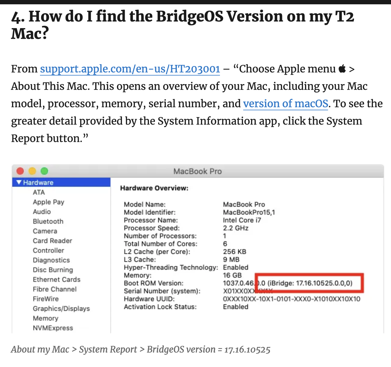

To find the version of BridgeOs on a Intel T2 mac:

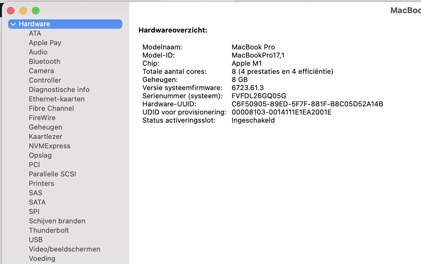

But if you have a M1 mac you may find something like this:
So no info on the BridgeOs which may humbly suggest that the BridgeOs was replaced by or integrated with Big Sur or something else on your M1 computer.
If you want to reinstall BridgeOs it is possible on an Intel Mac but not on a M1 Mac. Probably because it has what Apple calls 'Unified Memory' in which all processes are dealt with.
