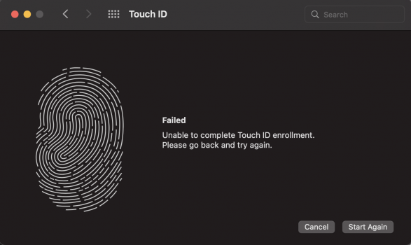

For me Touch ID also stopped working after about a week of using my 2021 16" MBP. So I tried to delete the finger print an re-add it. But when I try to re-add it and enter my computer password, I get this error:
Unable to complete Touch ID enrollment. Please go back and try again.
Hitting Try Again button, shows the same error!
