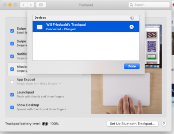

I just purchased a new magic trackpad 2, for my 2018 Mac Mini.
it works perfectly - totally wubbulous - when connected via USB, but not at all if it's not wired / connected.
is this as it should be? I was under the impression it would also work via Bluetooth. Of course, I am thinking it should also work via Bluetooth, because I have properly (I think) set up the Bluetooth in the system preferences. (see screen shot)
any feedback / suggestions / ideas?

one thing I notice - visible in the screenshot - in the DEVICES panel, there is a spinning wheel that keeps spinning, does not stop. is that as it should be?
W
That spinning wheel is normal. It's just indicating that the device is searching for nearby bluetooth devices.
