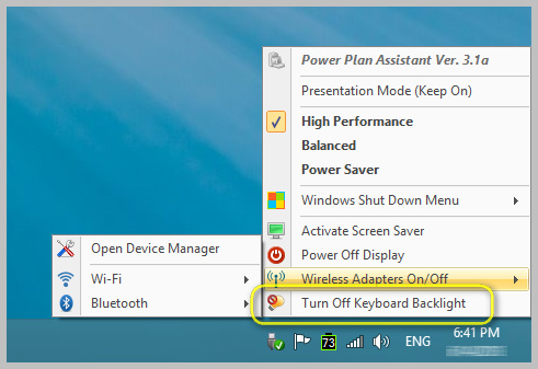

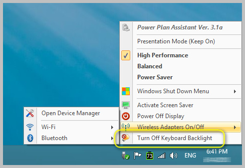

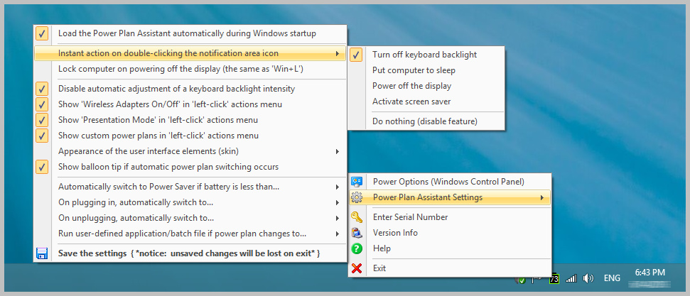

@DaveNinja: It's an ultimate manual/automatic power plan switcher with a compact yet very informative battery icon replacement option and some Macbook-specific enhancements (like the instant keyboard backlight toggle, wi-fi/bluetooth radio toggles). Here are the 'left-click' and 'right-click' Power Plan Assistant's popup menus (i.e. what you get by clicking its battery percentage icon):

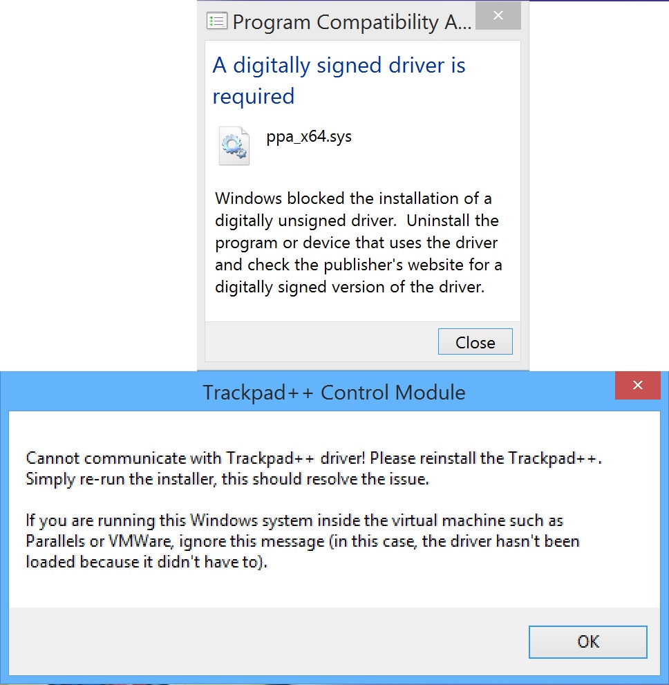

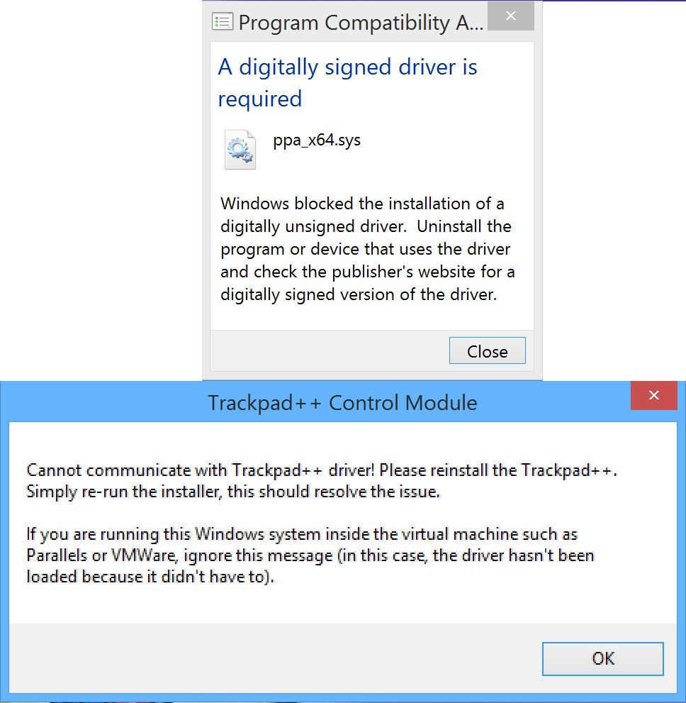

Trackpad++ Control Module Cannot Communicate with Driver
Hi Vladimir, I have been using Trackpad++ since I got my new MacBook Pro and I am very happy with it.
However just today, I received this error saying "Cannot communicate with Trackpad++ driver." It happened after my computer restarted from a Windows update. I also received the message that the installation of ppa_x64.sys has been blocked by Windows. (Pics of both message windows attached.)
I have tried reinstalling Trackpad++ first, then reinstalling both Powerplan Assistant and Trackpad++, and also uninstalling first then reinstalling both the programs. I also restarted Windows in between all of the installation.
I'm running the latest versions of both Powerplan Assistant 3.1c-x64 and Trackpad++ 3.0b (based on installation file since T++ cannot be opened now).
I am running a late 2013 MacBook Pro with Windows 8.1 version 6.3
Is there a fix to this problem? Any help is much appreciated. Thanks.
Just looks like test signing was disabled. Reinstall power plan assistant.
OK Now that you mentioned testsigning, I think I turned it off by accident. And I installed the Windows_8_81_x64_Test_Mode_Remover over it. Could it have broke something? Those were the only major things I did today.
I tried to use
Code:
bcdedit.exe -set TESTSIGNING ON
on elevated command prompt to try to turn it back on but it shows "The boot configuration data store could not be opened. A device attached to the system is not functioning."
I only have PowerPlan Assistant installed now and it's still giving me the ppa_x64.sys could not be installed.
@exclusionist: Thank you for the feedback. The fix is 100% safe and cannot affect the BCD thing. You did it right, so if testsigning cannot be enabled with such a diagnose, then something is more or less wrong with your boot configuration data store. With some EFI installations this happens on its own (and remains unnoticeable until you try to alter one of the BCD settings). To summarize: this very exotic issue is not related to PPA (and neither to testsigning fix), but it is definitely uncovered by PPA - if the BCD store cannot be accessed, then no setting can be written, including the testsigning setting, so the system gives you a message about the driver that it is not certified by Microsoft, etc.
