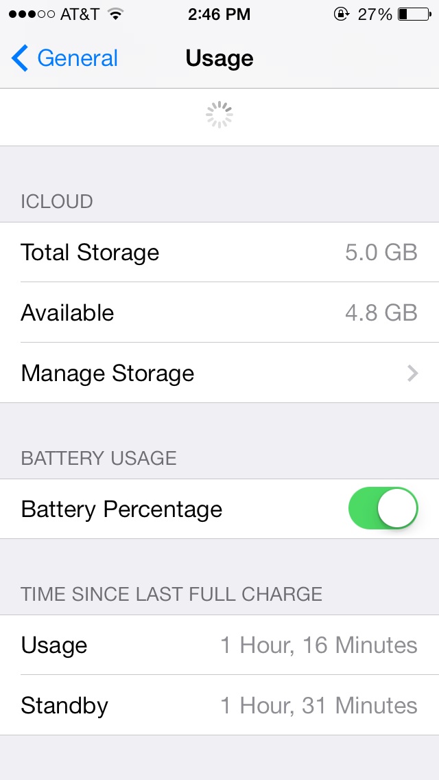

My iPhone 5, which is a pre-order from last year, has literally the worst battery life I've ever seen. I have a new replacement a battery on order (since I fix my own stuff), but I don't understand why it's this bad. This usage has been on wifi, and I have a ton of stuff turned off. I know everyone will suggest restore from new but that is not an option for me. My friend also has a iPhone 5 with similarly bad battery life. I have a mophie I use and get probably 3 hours of device usage in total with the mophie and the devices battery.

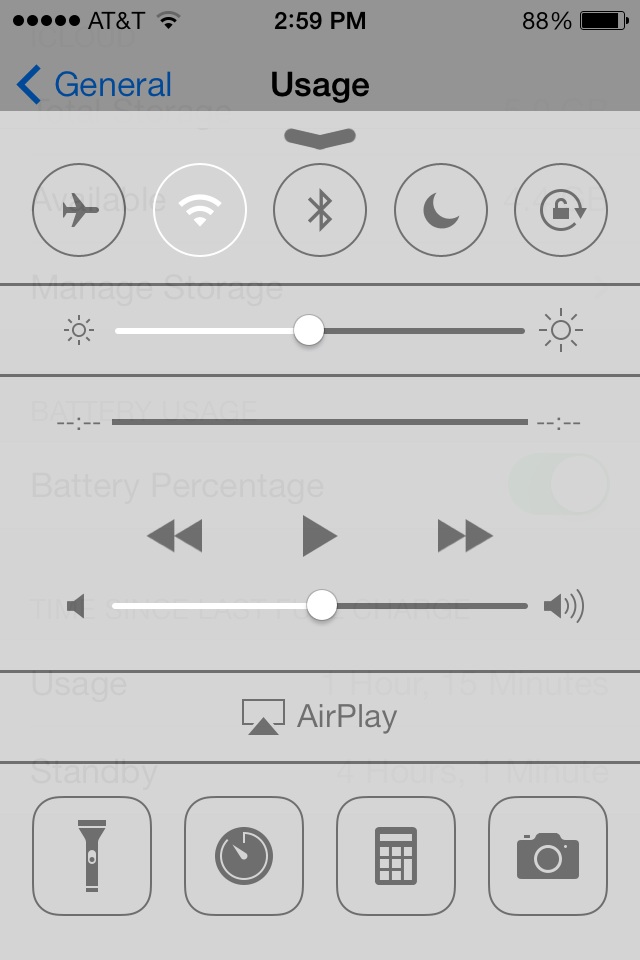

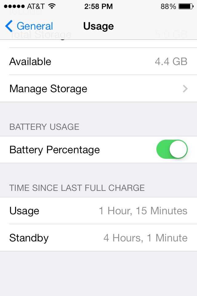

I have never had battery life issue I really think it's cuz of my brightness level

Do you have several apps open in the background?
No, it's not. I'm not going to suggest restore as new, but why is that not an option?
Anyway, you may have one of the bad batteries. Or, you have an app or process that's gone wild and you need to simply reset your phone to stop it. Depending on what it is, it may return (Facebook, etc.). Or, the battery usage is normal depending on what it is you're doing.
There only a few reasons for battery life: Location (weak signal), an app, or a looping process (authentication), or the unicorn bad battery. If you don't do anything else a new battery won't help. Because the phone is turned off when someone replaces a battery, the processes stop and folks think it was the battery when in fact it was simply turning off the phone.
Whatever it turns out to be, good luck getting it resolved!
For anyone else reading this thread, a good test is to restore as new and don't put ANYTHING or any accounts on the phone. The expectations are you won't have a battery issue and then you can play Sherlock and find out what usage or app or process is causing the issue.
Well, if you leave it a while and check the usage, and the time of usage is about the same as time of standby, you might be better off restoring it. I used to have this bad battery life with my iPhone 4S and I noticed that pattern. After restoring it the phone is having better battery life than before.

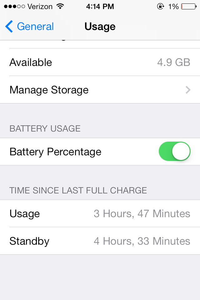

I've been having this issue since iOS6

Did you disable the most known culprits for battery drain?
http://mashable.com/2013/10/11/ios-7-battery-life/
Yes
