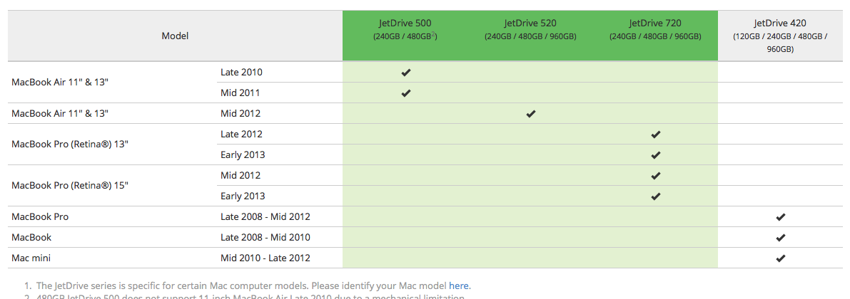

Well, I feel really stupid! I was absolutely certain that I had a Mid 2012 MBA so I ordered the 520 model - I opened the box and started the process... While that was running (about 4 hours to copy the 240Gb...) I drove back to work and started doing the math in my head.... I bought my MBA in 2011 not 2012!!!!!

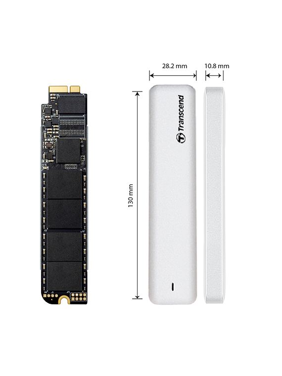

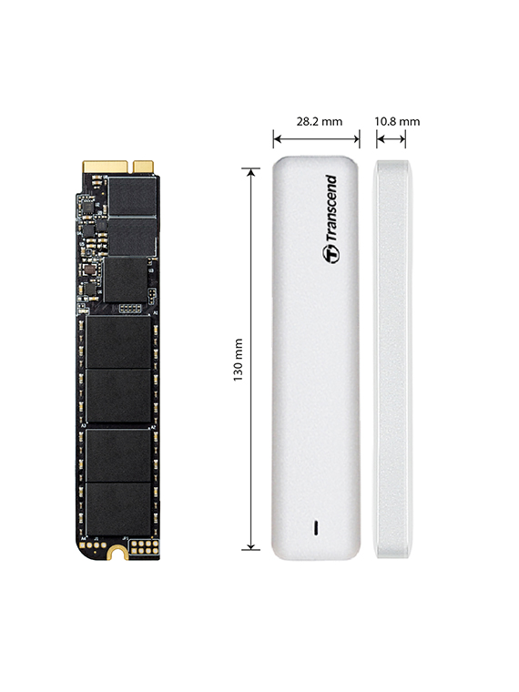

Is the 520 back compatible to 2011 MBA?
If not, any suggestions as to what to do ?
It seems OWC has reduced prices on their SSD Upgrades today. However, the reductions do not match those of Transend. I bought a 480GB SSD from OWC for my MBA last week. It has been giving me problems in Disk Utility and in TechTool Pro. I am RMAing it to OWC and I have a Transend SSD on order to replace it.
Lou
If you look at the pics on the Transend website the connectors look different. So, I would say no. Amazon has a Great Return Policy. So Return it and Reorder the correct SSD.
