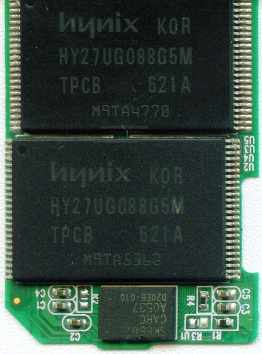

I am not sure why but micro SD cards are substantially slower than SD cards which also could be the reason for the slow transcend device.
This picture of an SD card's guts (an older card, but newer ones look similar inside) gives a pretty good idea of why they're faster:
A full-sized SD card may be small, but it still has room inside for a couple of full-sized flash chips and a controller IC, while a microSD has to cram all of that into a fraction of the volume. More room for circuitry = more speed.
I could certainly believe that inherent limitations of the flush-fit size would make it tough to max out a UHC-II bus, but there are UHC-II microSD cards on the market that are at least faster than what the UHC-I bus is capable of. Since the Transcend device is only UHS-I all we can really say about the speed is that it's pretty much maxing out its bus.
