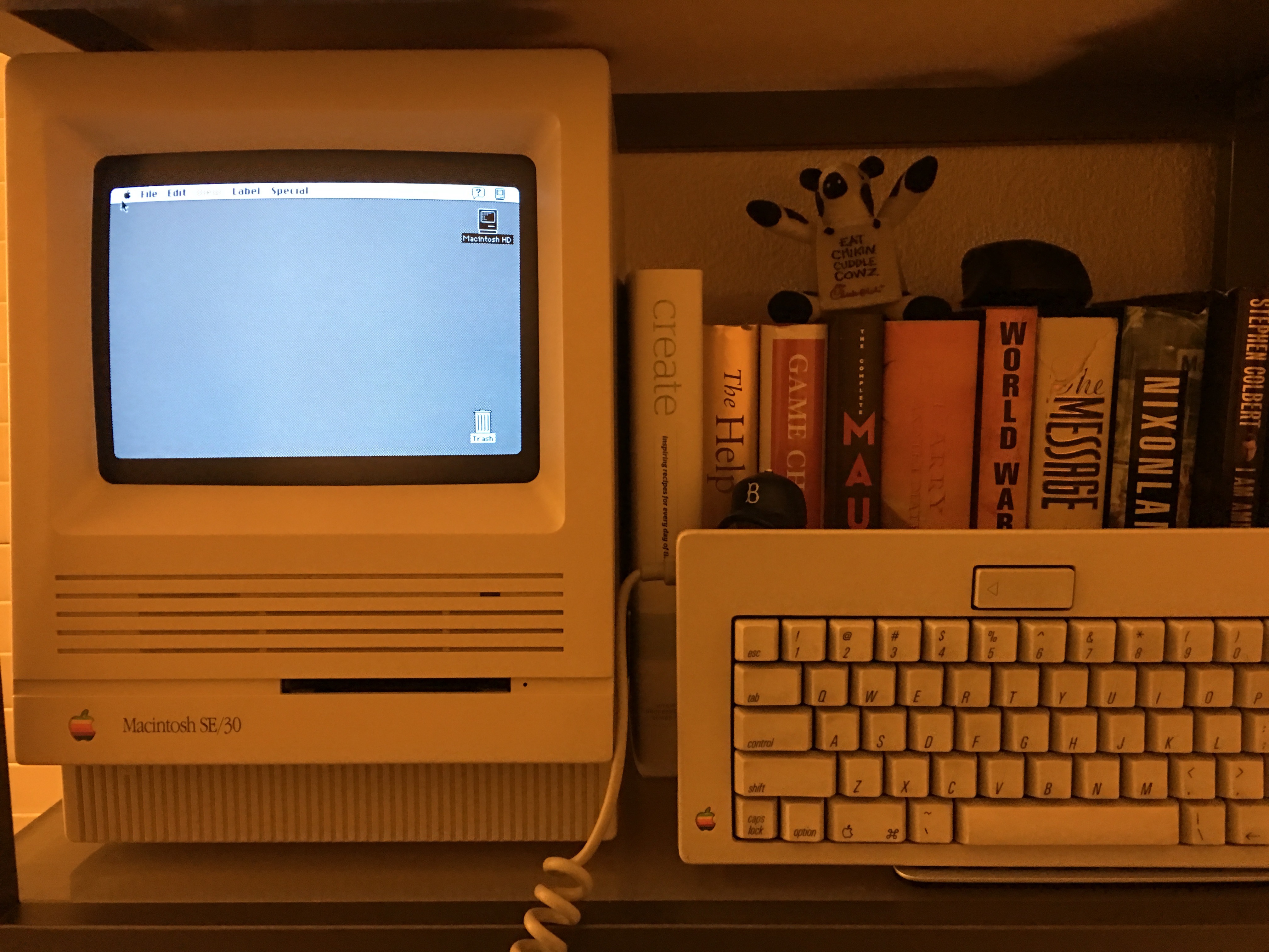

I recently bought a MAC SE/30 in great condition off Ebay. Trouble is that I can't seem to find a way to transfer some legacy 68K programs stored on my MBA over to the SE/30. My MBA is running El Capitan so USB floppy drives are no longer supported. The SE/30 does not have ethernet so networking is not an option.
I thought about using ZIP drives but OS X no longer supports that format either. I am thinking that buying an old apple CD 300e plus off of eBay may be my best shot of getting files over to the SE/30. Anyone have any other suggestions on how I can make this transfer work?

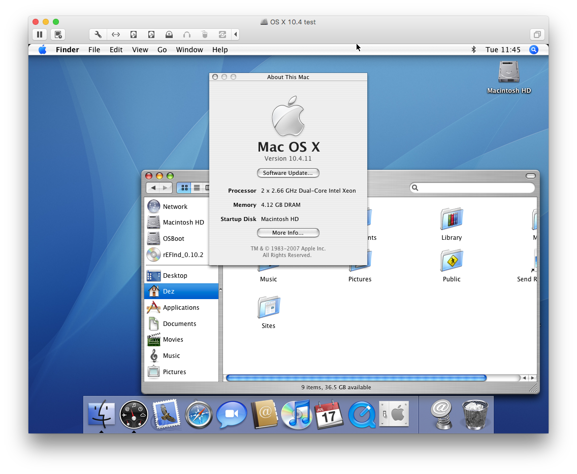

You could Setup a Virtual machine running 10.4 or 10.5 and then pass through a USB Floppy disk/Zip disk drive and read and write HFS standard

Im Just going to leave this here 🙂 (Tiger server also runs)
