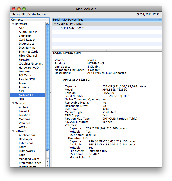

Trim mba 13"
Mine says it has TRIM enabled, don't know if it really is. I have a MBA 13" 2010 model...
