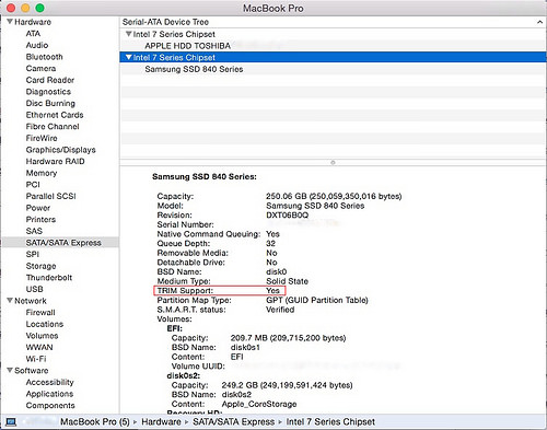

I found this thread interesting to read but wish I had read it before upgrading from Mavericks to Yosemite. I had TRIM support for my Samsung SSD and haven't had any issues. Once I did the upgrade to Yosemite, I noticed I no longer had TRIM support however everything seemed to work perfectly.
I used the app Chameleon SSD Optimizer to enable TRIM support for my SSD and haven't had any difficulties. Just wanted to put that out for you guys/gals. Here's the link: http://chameleon.alessandroboschini.com
As you can see in the below pic, I now have TRIM support with Yosemite 🙂
From what I have read in this thread, there were issues. I guess I was lucky because I didn't experience any of those issues when I did the upgrade from Mavericks to Yosemite.

The issues people are having are not upgrading from Mavericks to Yosemite... they are upgrading point releases of Yosemite AND/OR doing a PRAM reset because of a new security setting in Yosemite. You will likely encounter the same problems if/when you do one of these unless you follow the advice in this thread. The good thing is that we know what exactly Trim Enabler is doing and as a result, when it's good to "undo" it to avoid issues. Who knows what that tool you're using does behind the scenes?
