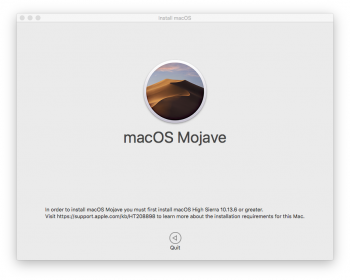

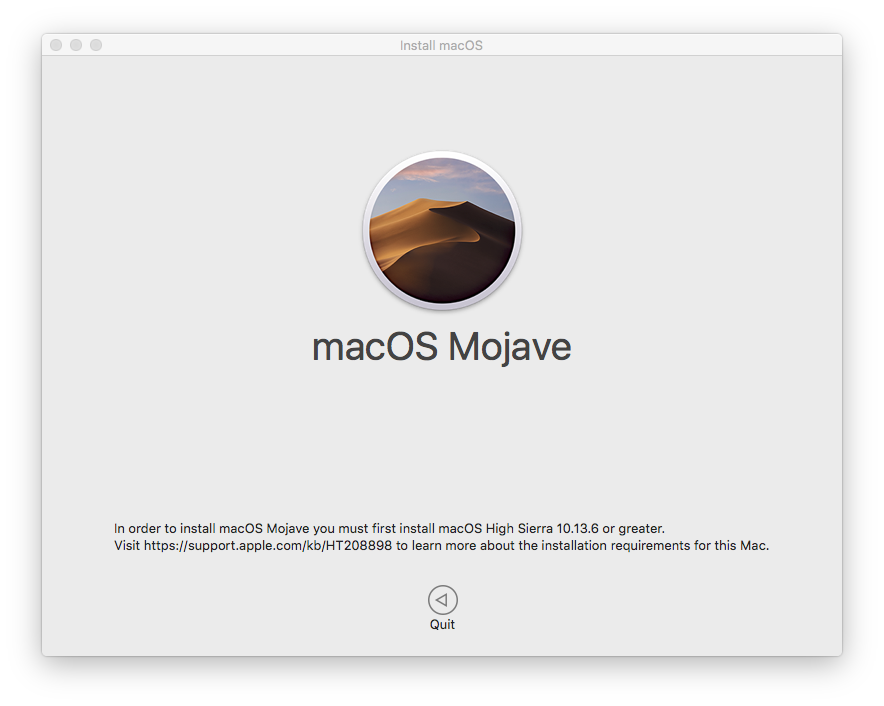

I am trying to do the same with my Mid 2012 5.1 Mac Pro currently running El Cap. When I go to get the High Sierra download via the Apple Store and click "Open" on the download page, I get a Mojave window saying I should first install High Sierra. Going around in circles with this. What could be holding this back from getting High Sierra? I've read the instructions noted in the link above several times. Any help would be much appreciated.

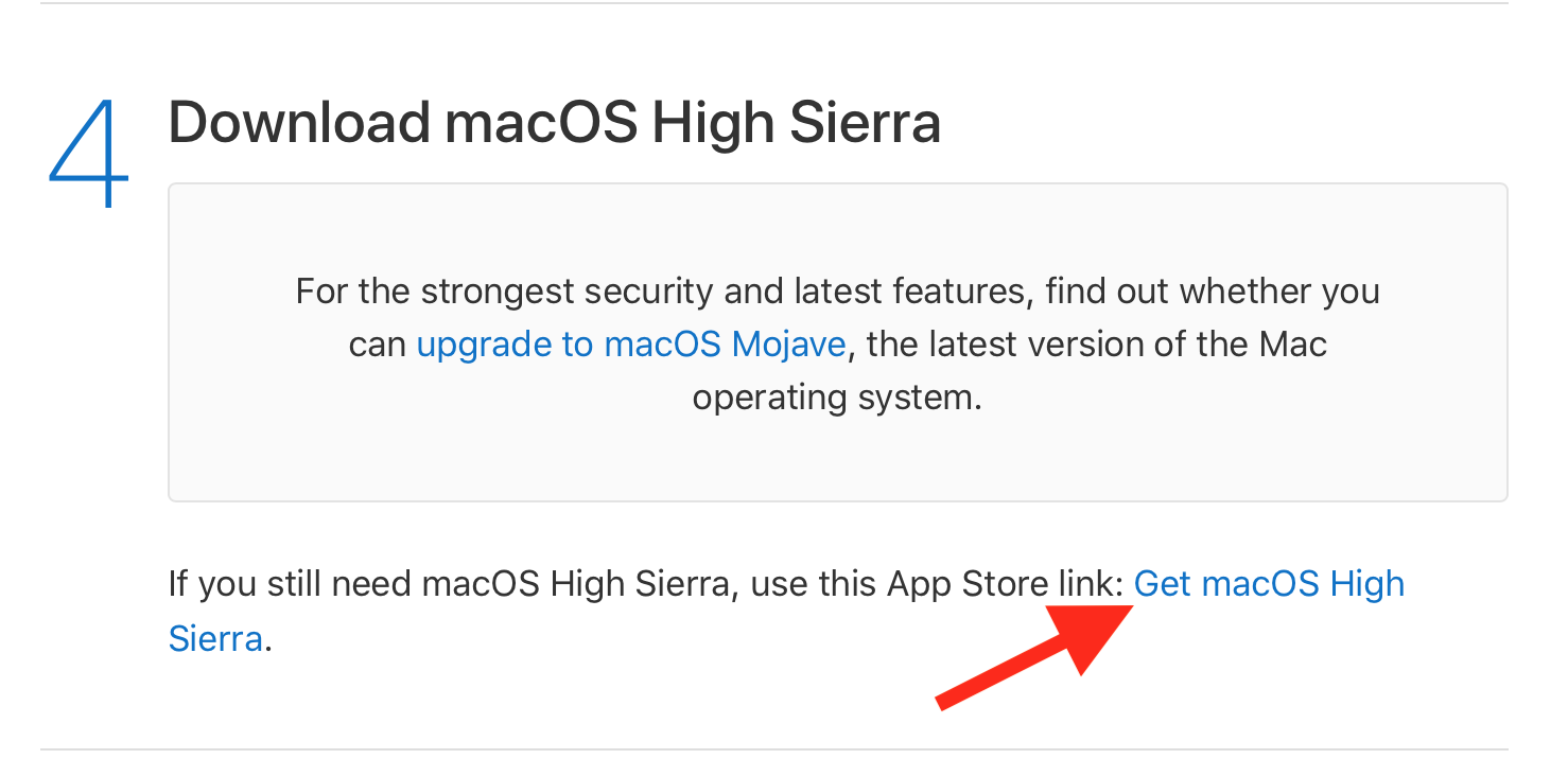

The link provided in the instructions of the first post of the MP5,1: What you have to do to upgrade to Mojave (BootROM upgrade instructions thread) thread, number 6, still works, just checked.
You can use installinstallmacos.py too, download 17G65 build:

FYI here's what occurs when I click "Open" to get High Sierra via the link on the instruction page.

So, your only other option is to use another Mac to download it.
Btw, installinstallmacos.py is developed by Pixar, gregneagle is the Sr. Systems Engineer at Pixar/Walt Disney Animation Studios, you won't ever get anything near than an official Apple tool than that…
