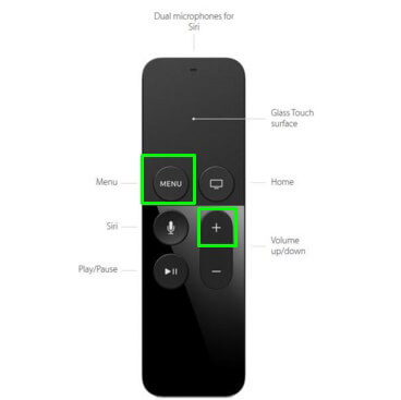

Earlier this year I purchased a refurbished 4k Apple TV when we got a 4k TV. When I first got it, if I clicked it, it would turn on the TV and select the correct input. This is also how my Roku remote works.
Now lately it has gotten lazy or it is screwed up. After it has been inactive for a period of time, clicking the Apple TV remote does not turn the TV on, and it may not even register as an input until I unplug and replug it in, or I reset it using the menu and the button with the tv icon on it, side by side.
So is this screwed up? I think it is. Is there any other way to reset it, other than what I have already done?
I have an extended warranty on it so it is exchangeable. What do you think? Talk to Apple before trying to return it to the vendor (not Apple)?
Thanks!

I have the same issue... it used to be a press on the trackpad. Now after the update, you must press buttons, and it also seems to be less narrow view getting input just to wake it up...
Dunno why that would be. Particularly when its not IR. When i get time, i might restore to factory defaults and see. It also happens on AppleTV 4 as well. However, i turn off HDMI-CEC set... its just trouble waking it up

tvOS 13 changed the functionality of the ATV. The trackpad used to turn mine on but now the Menu or other button must be pressed.

@Edd70 I just tried it and both the menu and home button turns on the TV, but it seems to take substantially longer for it to pop up on the screen, then before. Still good news, thanks!
However one time (so far) after the TV came on, the ATV interface briefly appeared, but then went to no signal. Pushing one of those buttons revived it and it stayed on.
