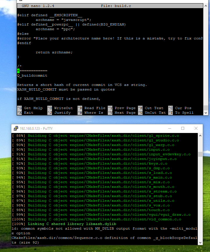

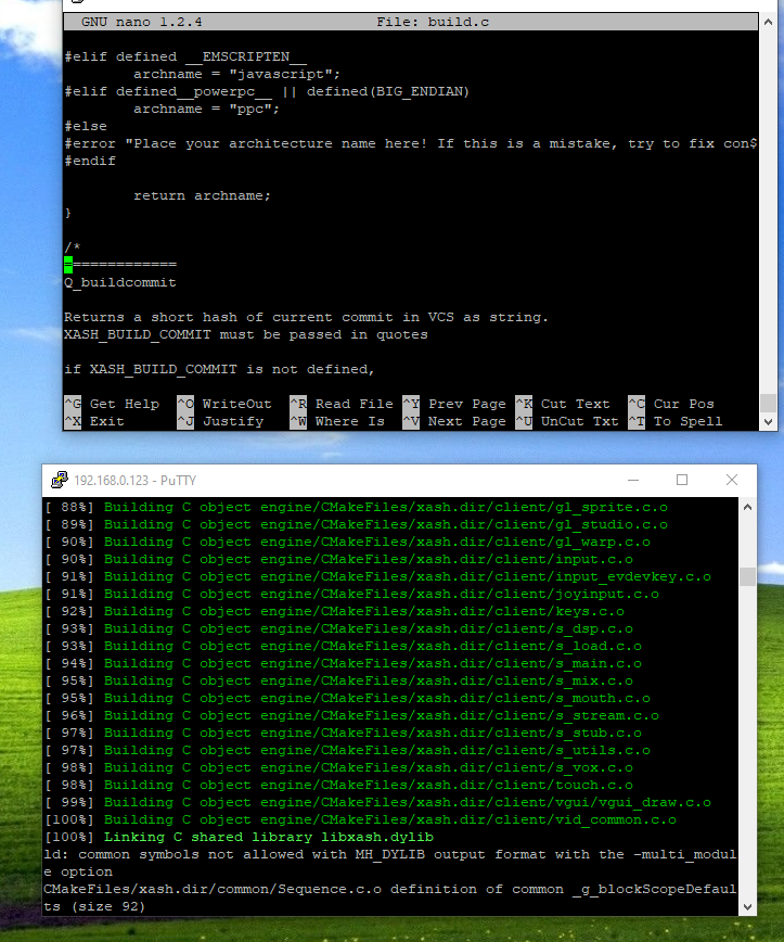

I had to define the architecture in xashfloder/engine/common/build.c:
elif defined mips || defined(LITTLE_ENDIAN)
archname = "mips";
#elif defined __EMSCRIPTEN__
archname = "javascript";
Then on another file Sequence.h I have fixed:
typedef unsigned char byte to typedef unsigned char Byte and then modified the Byte function in every usage on the header file (only two times appeard so not a big concern).
After that I had customized the cmake file (VGUI will not work for PPC) following the "archived" version of the Build and running:
cmake -DHL_SDK_DIR=../hlsdk -DXASH_SDL=yes -DXASH_VGUI=no ../ && make
Output:
[ 23%] Linking C shared library libxash.dylib
/usr/libexec/gcc/powerpc-apple-darwin8/4.0.1/libtool: can't locate file for: -lX11
/usr/libexec/gcc/powerpc-apple-darwin8/4.0.1/libtool: file: -lX11 is not an object file (not allowed in a library)
aaand failed at 23%, so I tuned it a bit more..
cmake -DHL_SDK_DIR=../hlsdk -DXASH_SDL=yes -DXASH_VGUI=no -DCMAKE_C_FLAGS="-I/usr/X11R6/include -L/usr/X11R6/lib" -DCMAKE_OSX_ARCHITECTURES=ppc ../ && make -j4
r/PowerPC - Trying to build xash3d on 10.4 Tiger (PPC)
and Failed at 100%... Both G4s failed at 100% 🙁
I tried to deep dive more and gave up eventually, because I didn't have much idea on the specific error..
Any idea how to clean that error during compilation? maybe it is the GCC Version or something releated to it..
Thank you!
I did the change but it failed again.. it is failing on the same part when it tries to link libxash.dylib
I'll keep investigating until I have something.. I want to have the binary
Hmm. Try adding CFLAGS += -fno-common to the makefile or makefiles (there may be multiple) scattered throughout the source.
Cheers

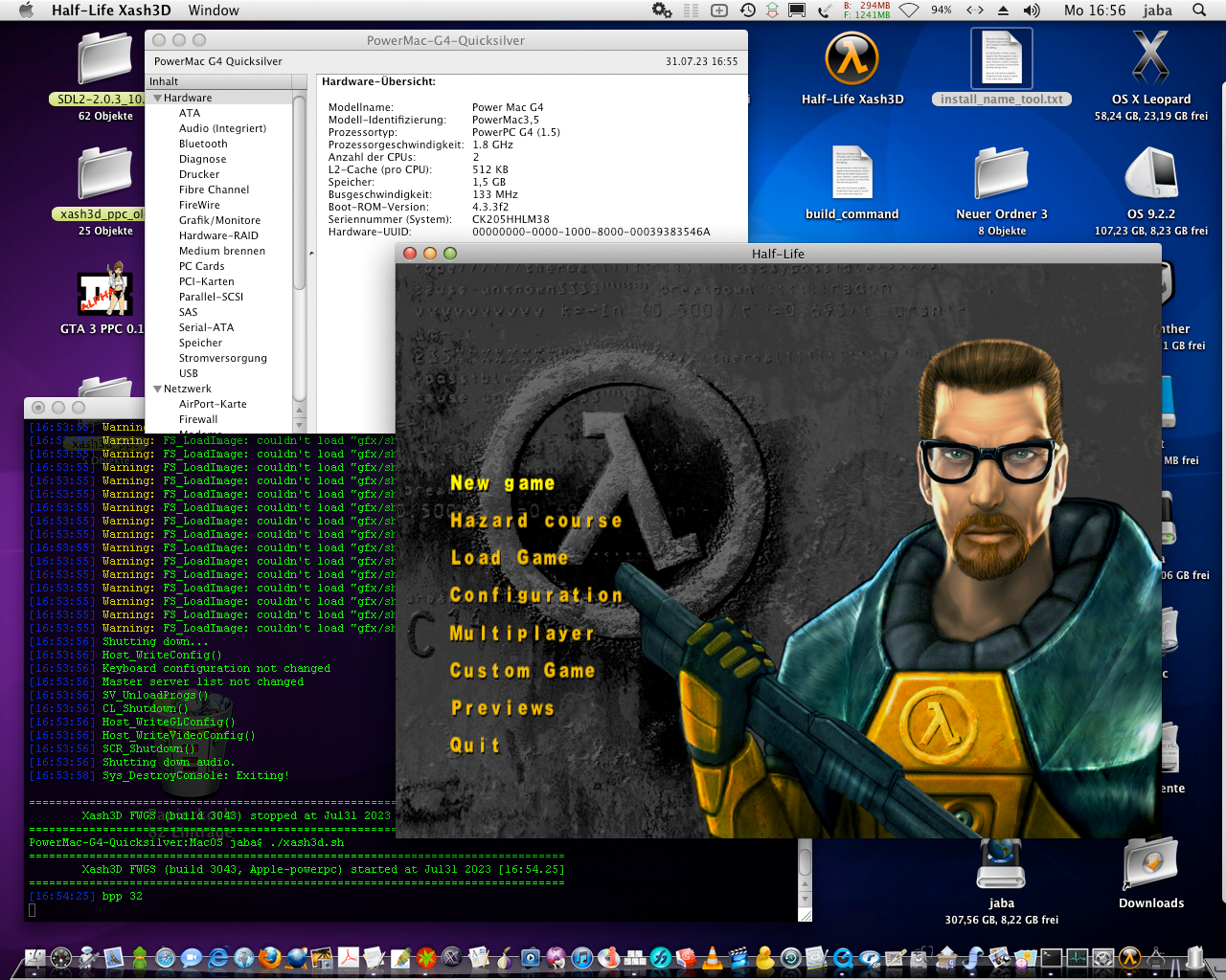

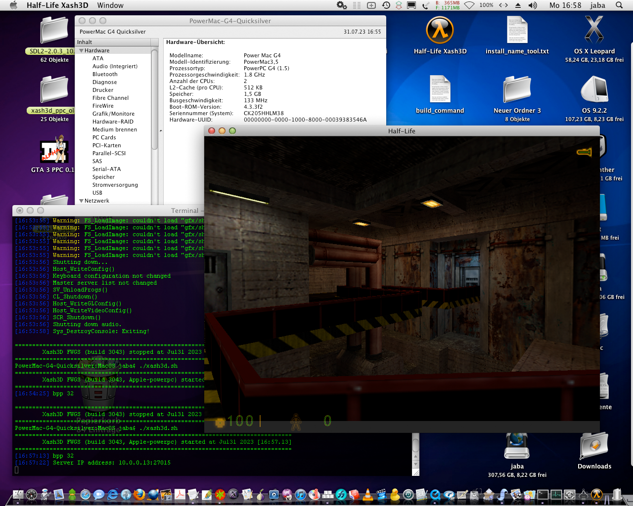

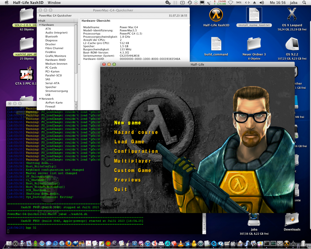

I recently managed to compile a somewhat usable Tiger compatible build of Xash3D for PPC using a big endian patched repo of the original Source I found on Github.
I've uploaded the binary here in case anyone's interested in testing it out - should work with the Steam version of the Half-Life resource files - just put them in the Valve folder located in the Resources dir of the Half-Life PPC app (without overwriting the existing files.)
Don't get your hopes up too high tho, this build is still far from playable - sound is garbled, loading and saving doesn't work, as do map transitions and random crashes are very common. I'd say it runs a little bit better than the version larbob demoed in that YouTube video so it's still the best porting attempt I've seen so far and maybe you'll be able to get some enjoyment out of it.

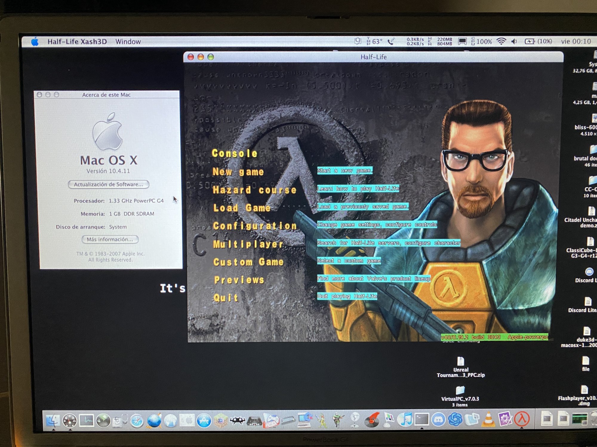

I'm speechless...I downloaded the file and used a 1999 cd version file just to test and worked at first try!!
Tomorrow I'll try the steam version, seems like its not able to read the maps, maybe due to an expected map name or something similar, since the hazard course loads the first part
You can load maps through the in-game console by typing "map mapname" the netmaps all seem to load just fine that way, c1a1c and c1a2 also seem to be at least somewhat playable - haven't really tested beyond that. You can get all weapons and ammo by typing "impulse 101" into the console btw.

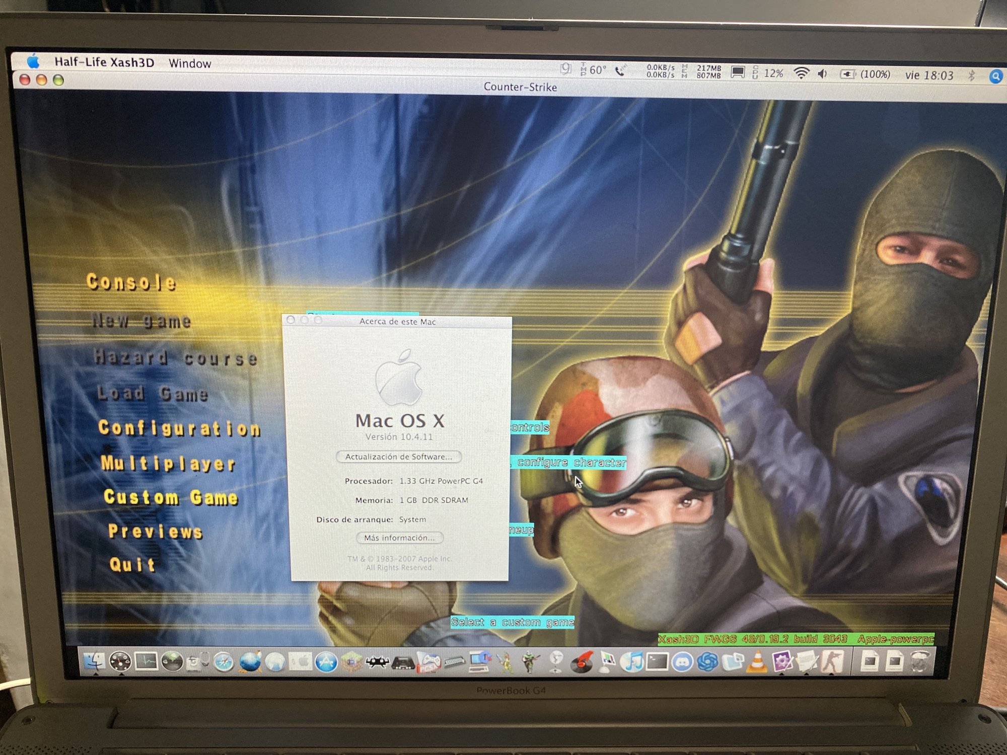

Counter-strike 1.6 works? I haven't tested yet, I just dragged the "cstrike" folder from my steam version next to the "valve" folder and the game recognized it as an option and allowed me to swap to it, we'll see soon too

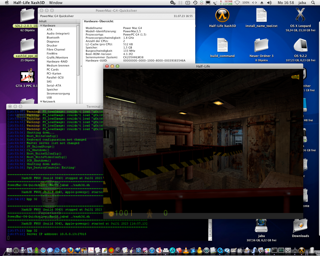

Actual gameplay in a PowerBook G4 12", after fixing the audio/ keyboard issue.
I found a solution for this issue, it's not due to the binary, it's due to a config for a default value.. seems like apple sound cards have higher gain and thus the audio sounds like hell. solution is to lower it to a value like "0.0040"
The keyboard map is in a default state, so you only have the arrow keys unless you map them manually, so I did it and now I can use a more comfortable "wasd".
Here are the two files, just replace them inside the "valve" folder and give it a try🙂
I'm still dealing with the fact of the missing textures, could be something due to the folders or buffers.. because sometimes they load and sometimes they don't
