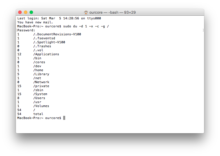

Thanks. This is what I got:

Your entire Users folder is only 8GB, so there is no real issue there.
/Applications is at 12GB. Any apps in there you don't need any longer.
Both /private and /System are at 15GB, which is a little high normally.

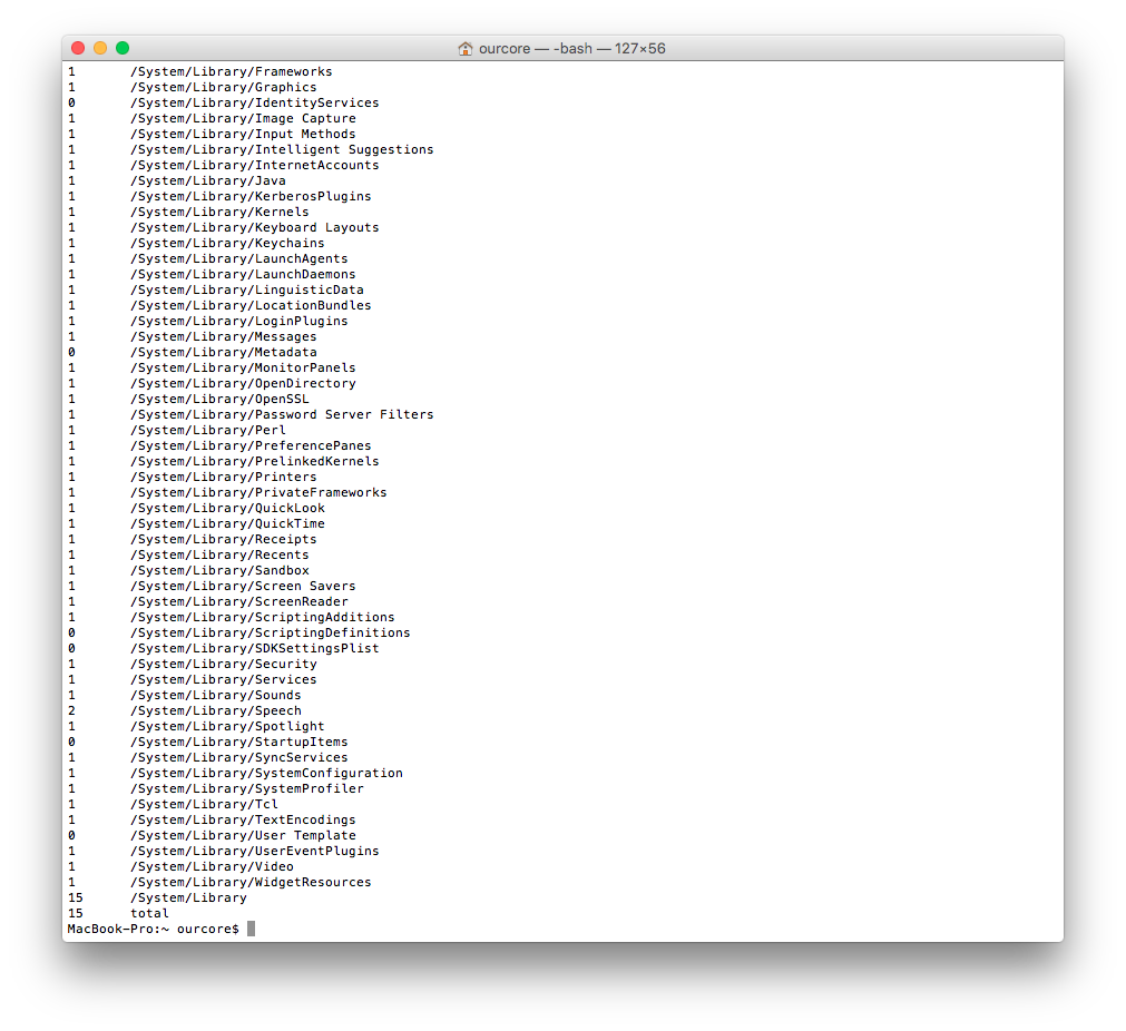

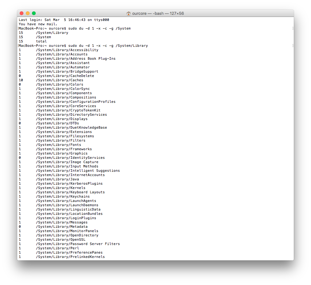

Here is the output:
I navigated into /System/Library/Caches in Finder, but the largest file in there was 20 MB, even after enabling hidden files.

Finder does not show everything. You can check with this:
Code:
sudo du -h /System/Library/Caches
Code:
Looks like the 9.4 GB culprit is /System/Library/Caches/com.apple.coresymbolicationd. Googling around, it seems relatively safe to delete and let the system rebuild it.
I had a quick look as well and I suspect that the coresymbolication daemon is related to XPC (see here). This will not be properly rebuilt on its own until you update your system. If you have not done so yet, it would be better to perform a reinstall via Recovery (this will not delete your files). Alternatively, or if you have already deleted it, the following command may help you out (but I have never used it myself):
