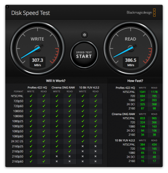

My iMac has a likely dying and slow 1TB HDD with about 850-900GB used up. I'm looking to install a 1-2TB external boot SSD that would seriously improve performance on it, and allow it to run Adobe Premiere and edit video without too much fuss. I'm not pushing it like a serious professional needs to, but I'd like to edit video on it. Is this even possible?
It's got a 3.2ghz core i5 so not too shabby with a NVIDIA GeForce GTX 675MX so I believe it can still get some life back (correct me if I'm wrong)
Considering I have USB 2 or 3, and thunderbolt v1 ports, what is the best/cheapest combo here?
I'm also ignorant on the difference between a SATA SSD drive vs strictly external here too, and I'm curious if that matters. Any advice here is greatly appreciated, and I've combed through plenty of forum responses here already to learn enough to even comment on SATA and see what sort of ports I have, but I'm confused on:
-which drive would be the right kind
- if I need an enclosure to maximize read/write speeds
- if the usb-C to thunderbolt adapters would work with my thunderbolt v1 ports and still get the "10gb write speeds" or close to that as promised, and if not - what is the best combo of drive and cables?
Last question, would an internal installation (cracking open the screen and back) be preferable considering what I'm seeking?
Thanks!

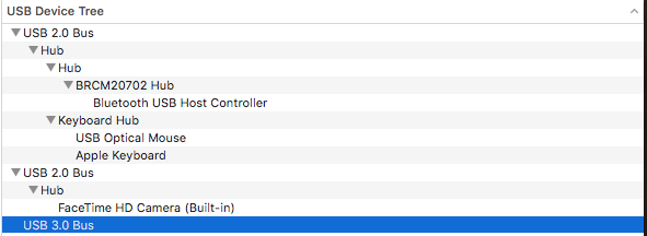

Do you have a wired keyboard with a USB port on it?
Yes - I replied with my system report screenshot for the USB portion.
Whether it's USB 2.0 or 3.0, do you have any recommendations on what drives/setup create maximum read/write speeds? Your history of replies indicates you have experience setting up external boot drives on macs.

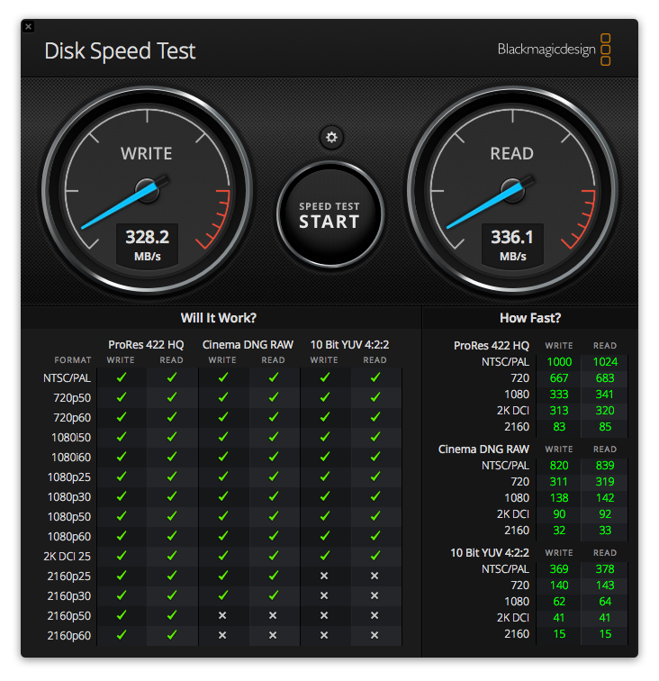

It is really easy setting up external boot drives, and I have been doing it for a while. Mostly for troubleshooting and backups, but there were periods of time that an external drive was my primary boot drive on some of my Macs.
You can use external USB 3 drives, TB drives, and others, but for speed and price, USB 3 is probably the best.
You can get an USB 3 or TB enclosure and an SSD, which would probably be the cheapest method, or just get one that is already together at a Best Buy, Walmart, Target, Amazon, New Egg..... This would be a little bit more money, but a little less work.
If you have a spare enclosure sitting around, you could use that. Most are really easy to take apart and add your own drive.
I like the Lacie Rugged Drives. I can sometimes find them for cheap on eBay. I get them used with a HDD. Take them apart, and put a SSD in it.
An advantage of using a TB drive is that it doesn't tie up a USB port, but speed wise, it probably won't have any gains on the USB3 on the Late 2012 iMac.
If looking for a LaCie Rugged Drive, I suggest the one with Thunder Bolt and USB 3. I got one with USB 3 and FW800, but noticed that it isn't nearly as fast as TB.

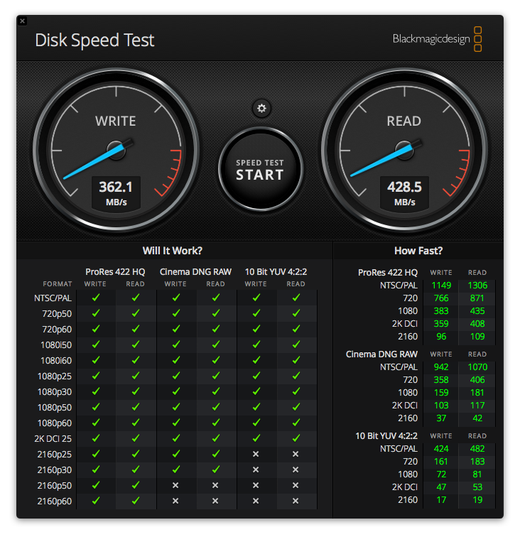

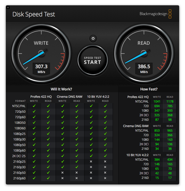

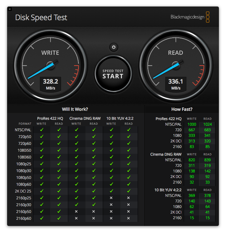

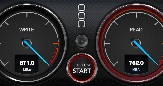

I have some screen shots of R/WR speeds of a TB, USB 3, and a software RAID 0 using both a TB and USB 3 drive together.
I will post them in a few minutes.

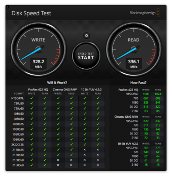

Here is a USB 3.0 with a brand new ADATA SSD:

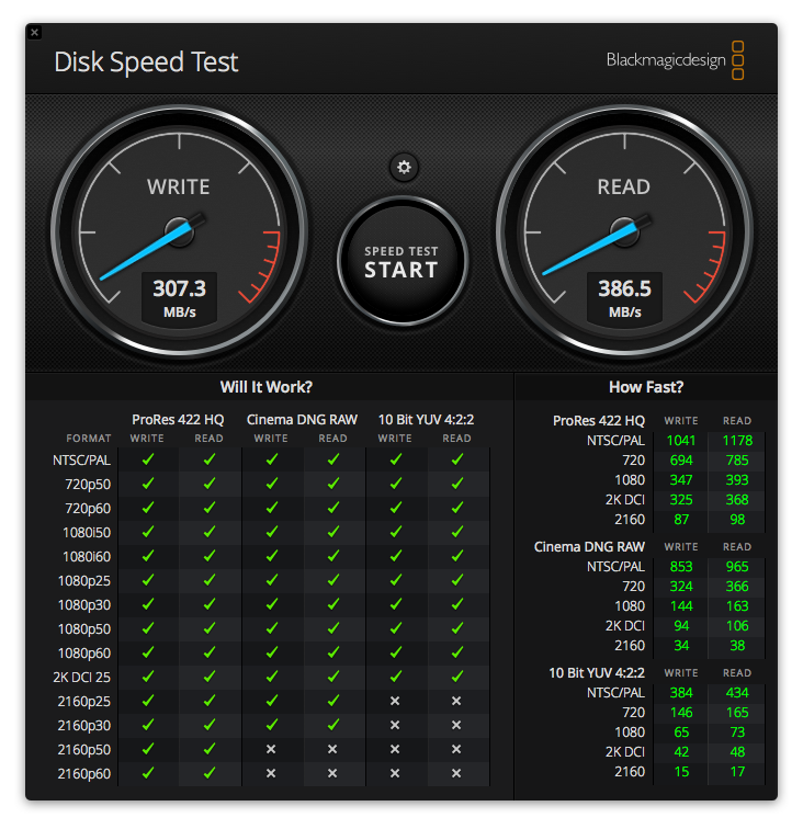

Here is a LaCie TB with a well used Samsung 860 SSD:

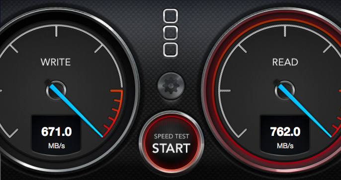

Here is the Software RAID 0 made from the two above drives together:
For reference, here is a HW RAID0 using and external USB 3 RAID enclosure and two old but good HDDs:
The reason the screenshot of the SW RAID0 looks different than the others is because I did that one a few days ago on an older OS. Apple removed the GUI to make SW RAIDs from Disk Utility, so when ever I want to make one, I just boot up to an old OS before it was removed.

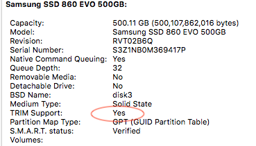

Does anyone have a firm answer on whether TRIM is supported on USB?
I double checked my system report to make sure what I said above about TRIM on external drives is correct, and for my TB drives, TRIM is enabled.
But...
My external USB SSDs are not listed under SATA, so I am unsure where to check to see if they have TRIM enabled.
Looking up the situation online, there is a debate on whether USB drives can have TRIM enabled on them.
I personally haven't noticed any slow down on my USB SSDs, but maybe I don't use them enough.
@smirk and OP, even if TRIM isn't supported on USB, I would bet that it would still be much faster, even when slowed down, than the internal HDD in your Mac.

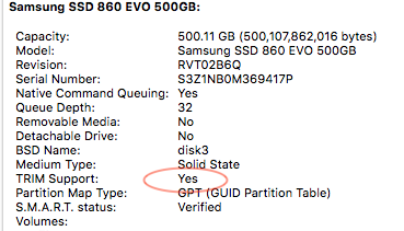

If this is a concern, then use TB drives for your boot drives, as it is confirmed TRIM is compatible:
