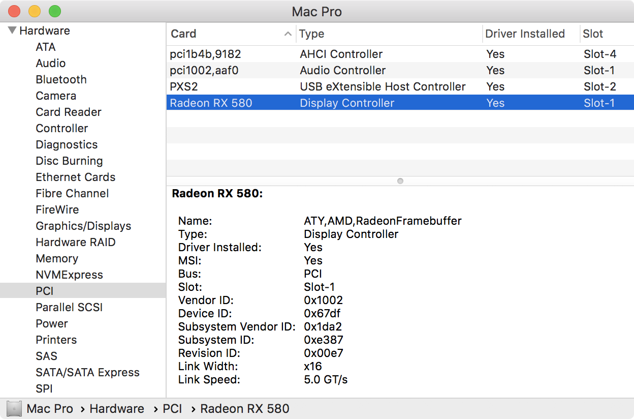

Just want to dig out this old thread.
When I wrote this thread. I didn't have the RX580, but now I have it. And I found that despite High Sierra now can correctly ident the RX580, but this mod still has some extra function.
This is the screen capture when my Sapphire PULSE RX580 8GB with original part number (113-1E3870U-O49). MacOS only assign the generic RadeonFramebuffer.

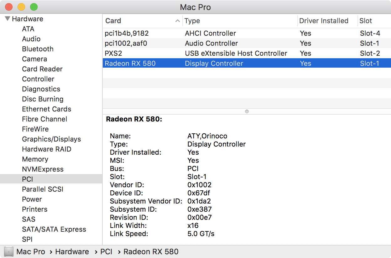

But if I mod the part number to 113-4E353BU-O4E, macOS will give me the Orinoco Framebuffer.
Not sure if this help anything in MacOS yet. However, we know the part number still means something.

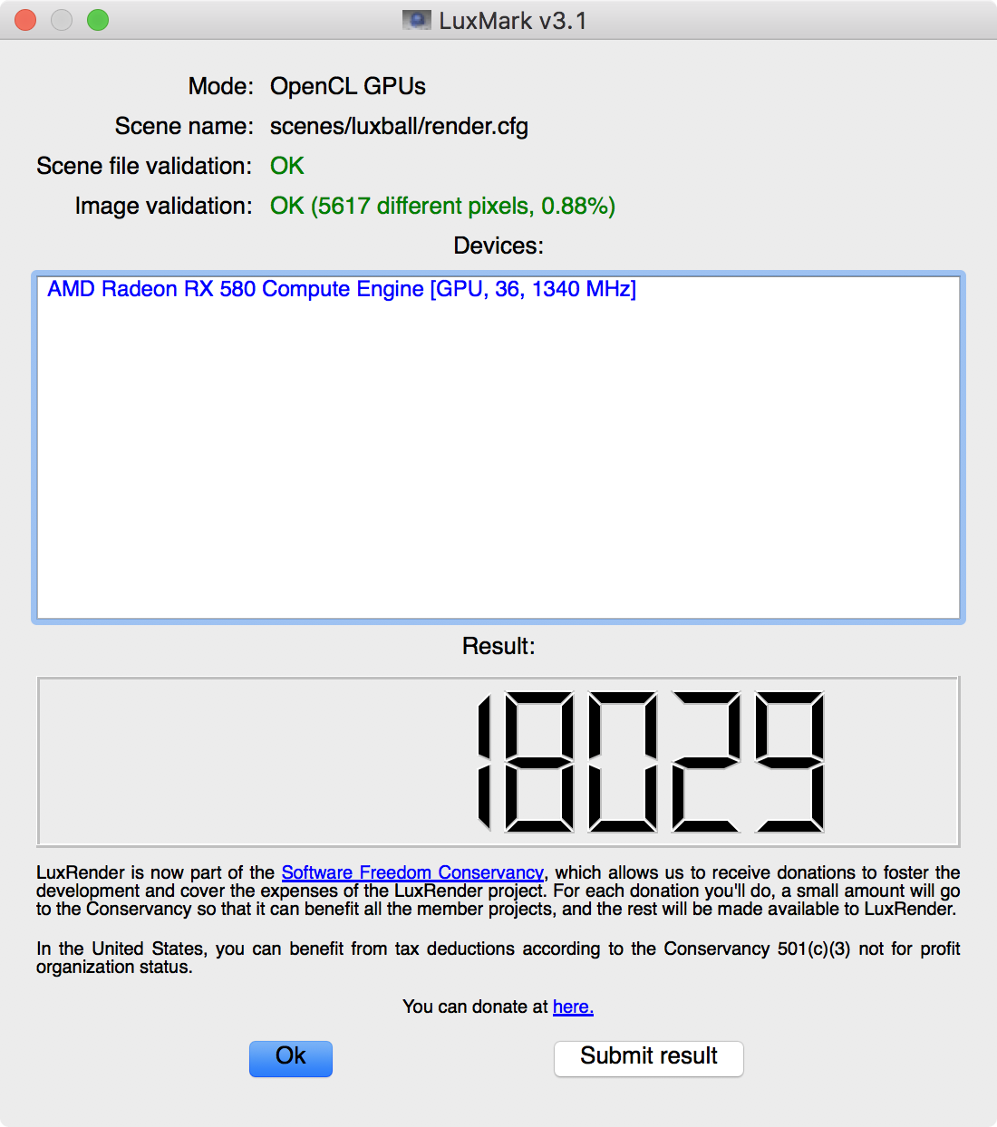

100% sure part number mod / Orinoco framebuffer won't limit the Sapphire PULSE RX580's performance now.
I just tried some different settings, and end up able to achieve this with the part number modded.
(I will update the RX580 VBIOS study thread to explain how to get this performance)
