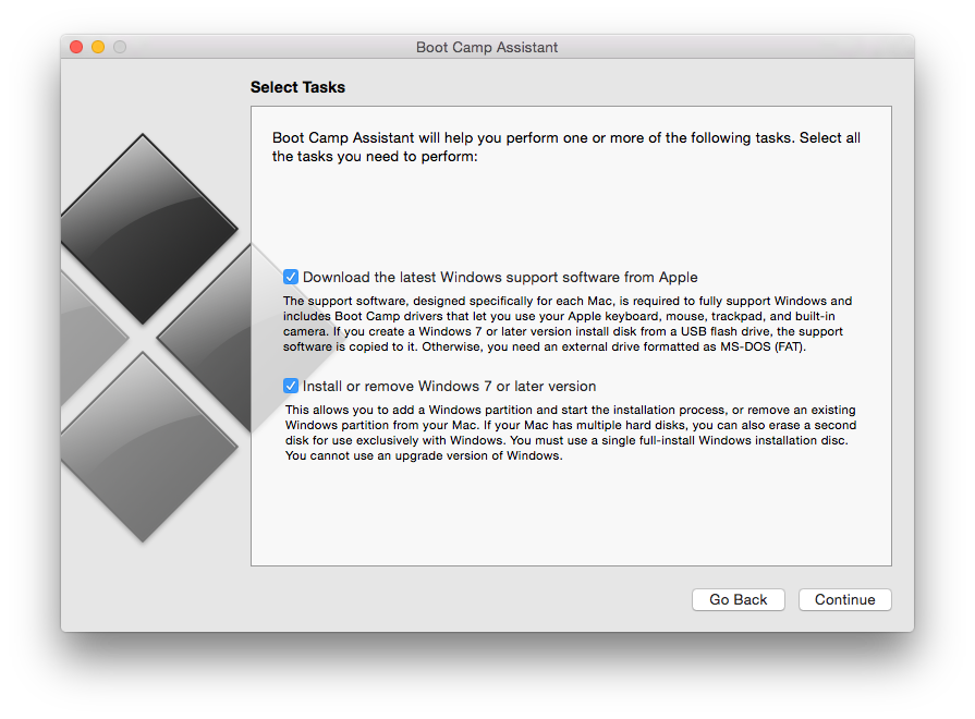

I have an IMAC 2009 running Yosemite. I am trying to install windows 7.
I followed your instructions and I got the check box for create windows 7.
I cannot select the check box for install or remove windows 7.
Any Ideas???
Guy

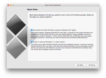

I know this thread was made a long time ago, but I just did all this and worked well until boot camp showed an error when making a partition. I have a mac book pro late 2011 and was trying to boot windows 8 installer from a USB. So I checked another threat that pointed out a solution for that error which was booting in single mode and repairing using /sbin/fsck -fy .... the comand line displayed an error and now I can't boot my mac. I can only access recovery mode, but I can't repair my disk or my disk's permissions. Tried reinstalling OS X but got an error that it cannot verify the disk!
Here is my problem, the first task is not showing, ive done some reasearch your forum is one them, but still I cant find answers to my problem, please help me... btw I am using Mac Pro G5, Yosemite

Code:
sudo codesign -f -s - /Applications/Utilities/Boot\ Camp\ Assistant.app/Contents/MacOS/Boot\ Camp\ Assistant
now It will ask you to read License Agreement, Hit enter to read Agreement and press "control + q" to exit the License Agreement.
after that It will ask you to agree the terms of Software type "agree" and hit enter.
7. Done, now You can install Windows using USB Flash Drive.
If you get any Error or having Problem, Post here.
Thank You
Tutorial created by RahulRulz
Hi,
I have carefully tried to follow your steps a few times and each time i receive an error message after clicking control x, y and then enter. the error message is:
[ Error writing /Applications/Utilities/Boot Camp Assistant.app/Contents/Info. ]
i am stranded for days now scouring the internet for a way out of this and seem to get none at all. what should i do?
Thank You
Finally, something that worked. Thank you! Although i've not completed the installation yet it seems to be working.
Edit: for anyone looking in the future. I had to take the usb out then in again, for some reason bootcamp said there was an error, this fixed that.
I don't have a password on my iMac, this was a problem when I was in the terminal. Changing it so my password was a space worked fine.
64bit seems to be the only one working, a bit of knowledge for anyone like me who just installed 32bit. Even though Apple say my 2010 iMac doesn't support it.
Download X Code, it's 4gb and takes a while. Even though i'm on 50mb it wasn't at it's highest download speed so took an hour and a half. It was 10mb a second at one point in the later stages.
Reactions: ifmihai
