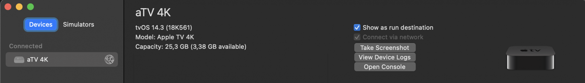

priitv8, where do I find the information you posted? Where do I find this screen?

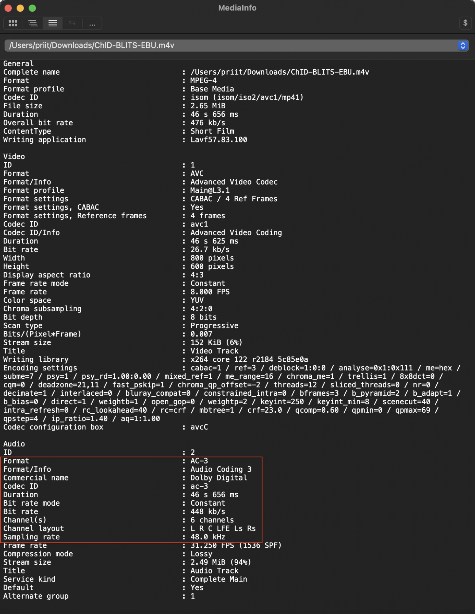

Well, the file I download from your first link up there, I get a file with AC-3 5.1 audio, there is no AAC track.
If I remember correctly, aTV does even not like AAC 5.1 soundtracks.
The image is standard view from Xcode development environment.

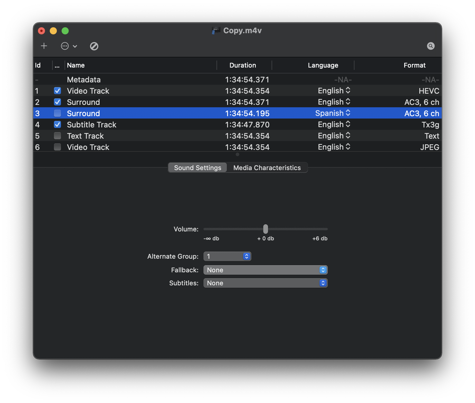

One more thing came to my mind - how does your file look like? Does the surround audio track have the fallback audio set? If I remember correctly, at one point in time this became mandatory. Subler even introduced action menu to fix this meta.
Secondly, the Surround track shall not be active, if AAC track is present.
Just regarding that - I checked that as well in Subler and even tried the naming convention where the inactive AAC track is named ‘Stereo’ and the active AC3 track is named ‘Surround’ but sadly no luck 🙁

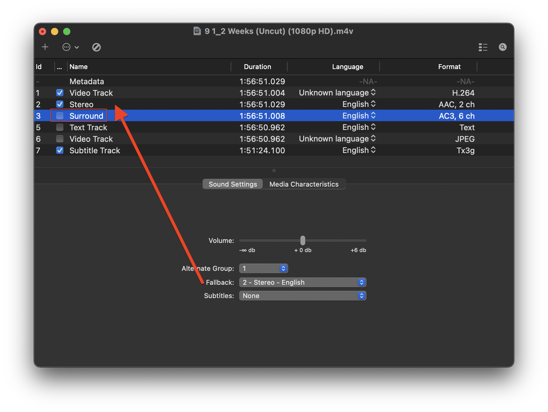

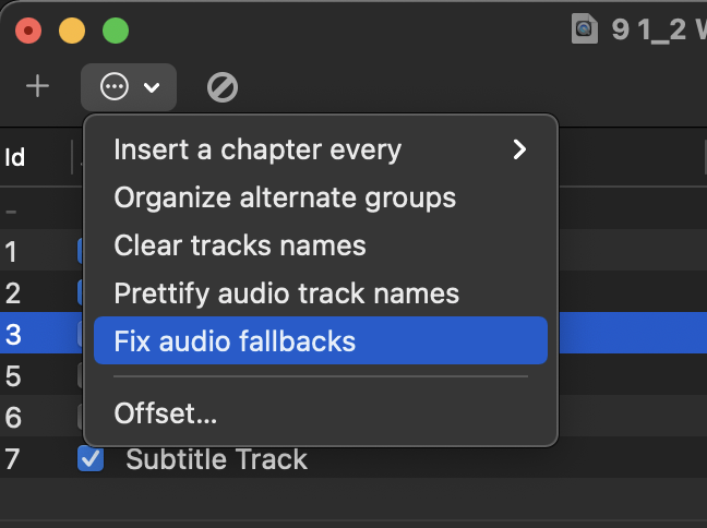

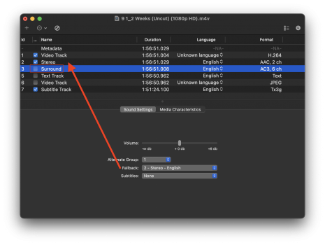

I haven't had to set a fallback; surround has always just worked. In fact, a fallback option is not available for either audio track shown.
This is an example of a movie file.
The fallback option is only available when there is an AAC track present as well, but you’re right - even files with just AC3 tracks play perfectly fine in surround in tvOS 13.
