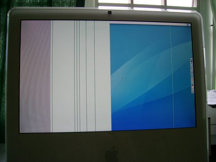

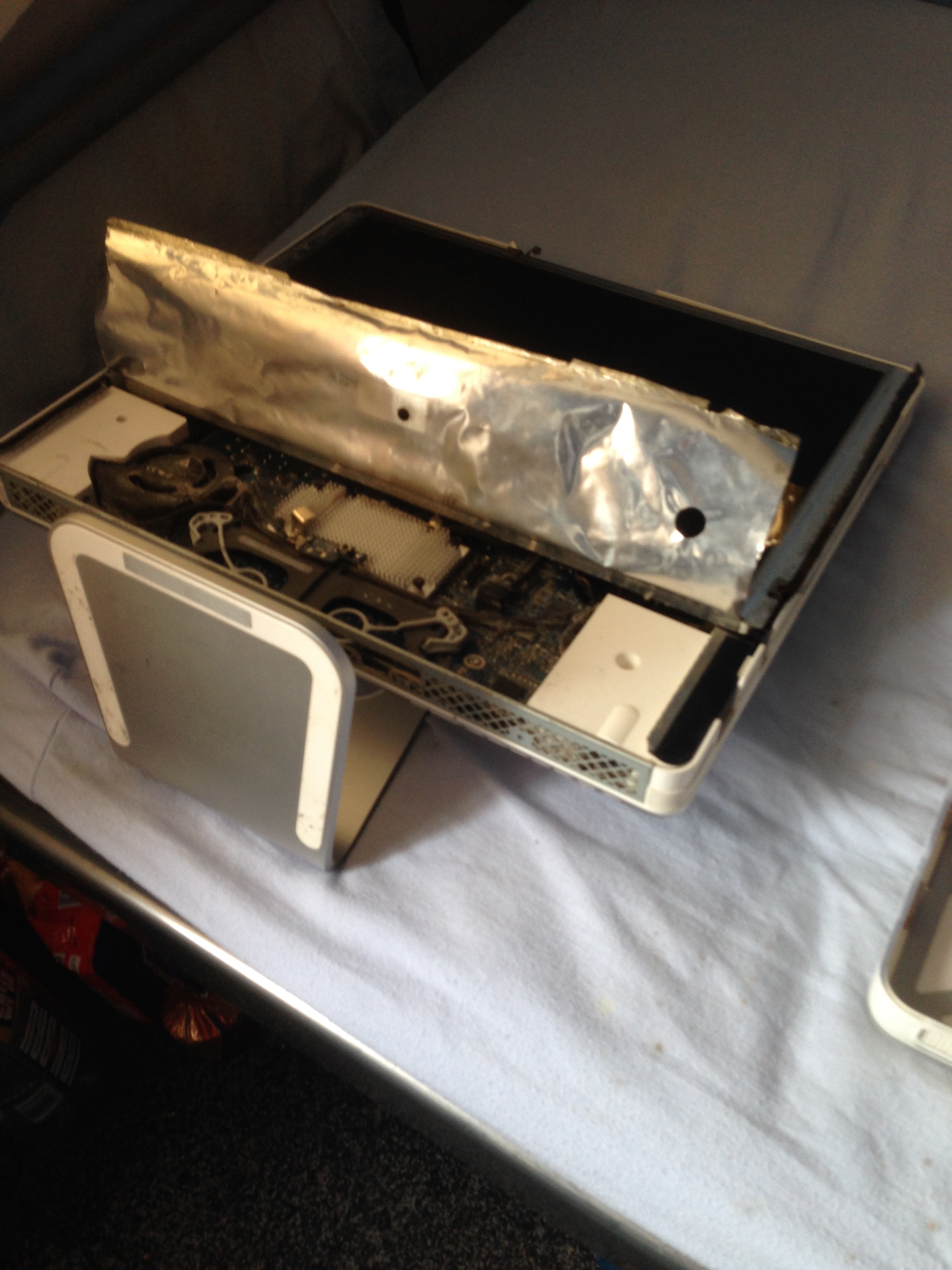

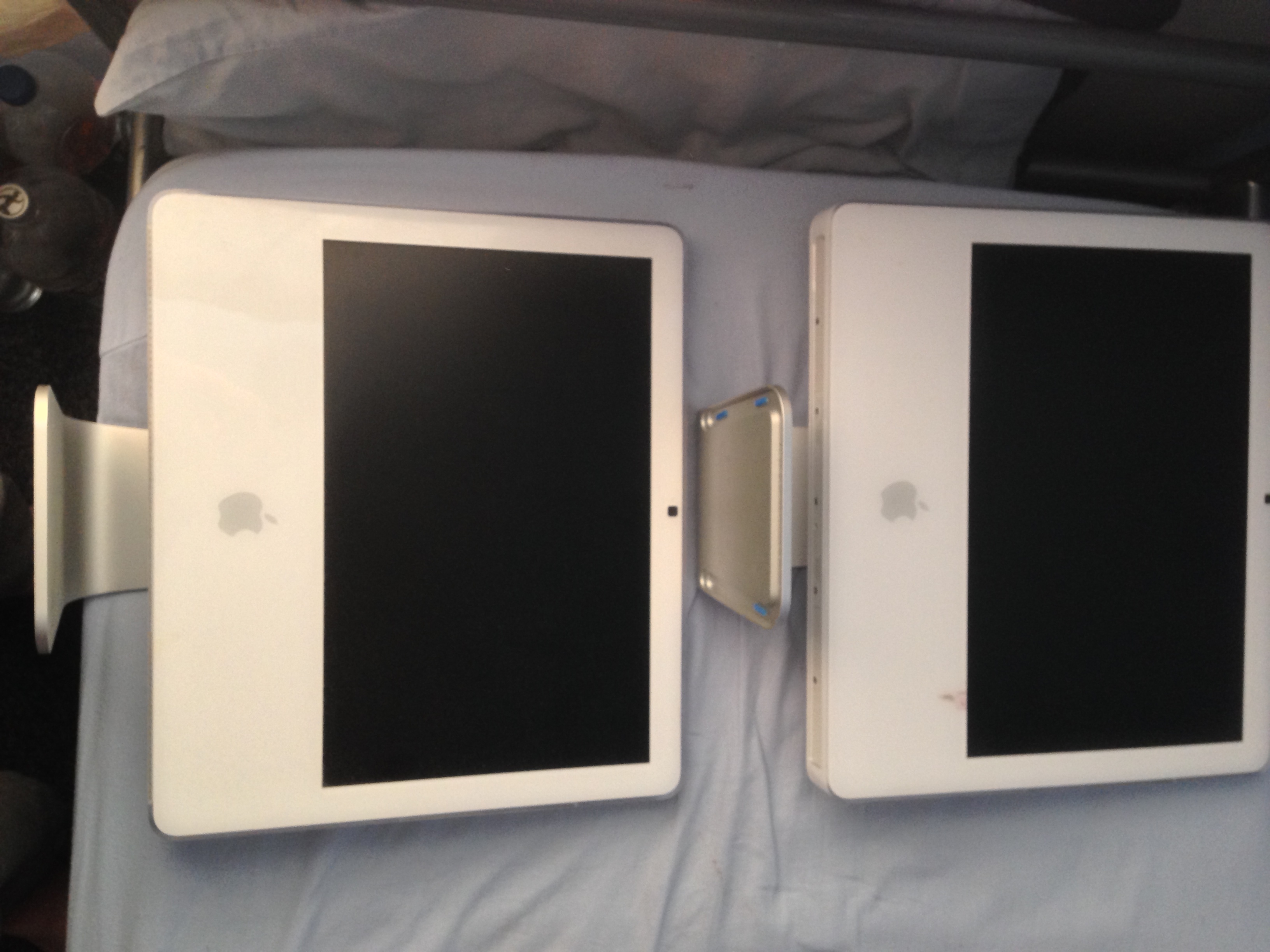

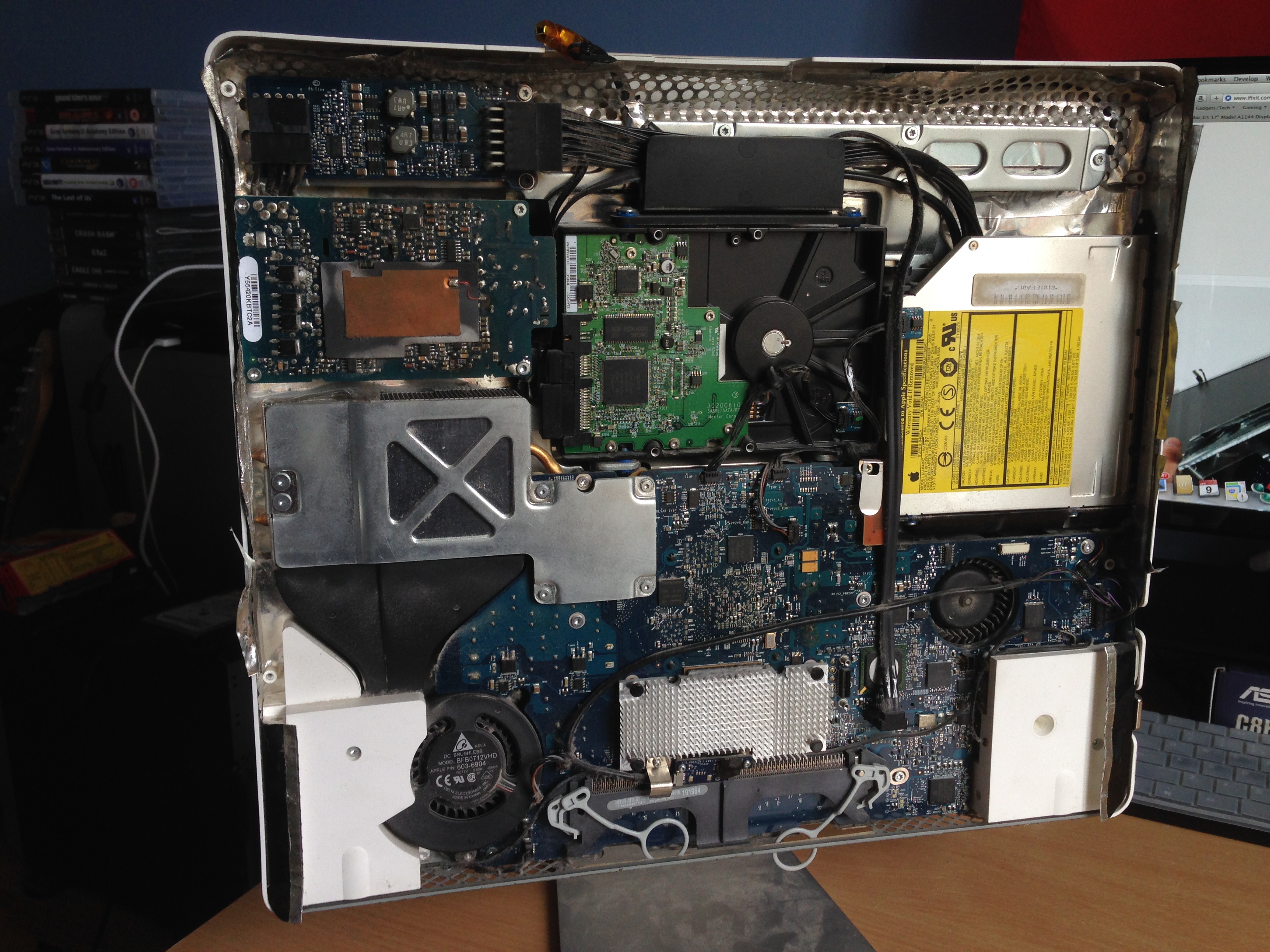

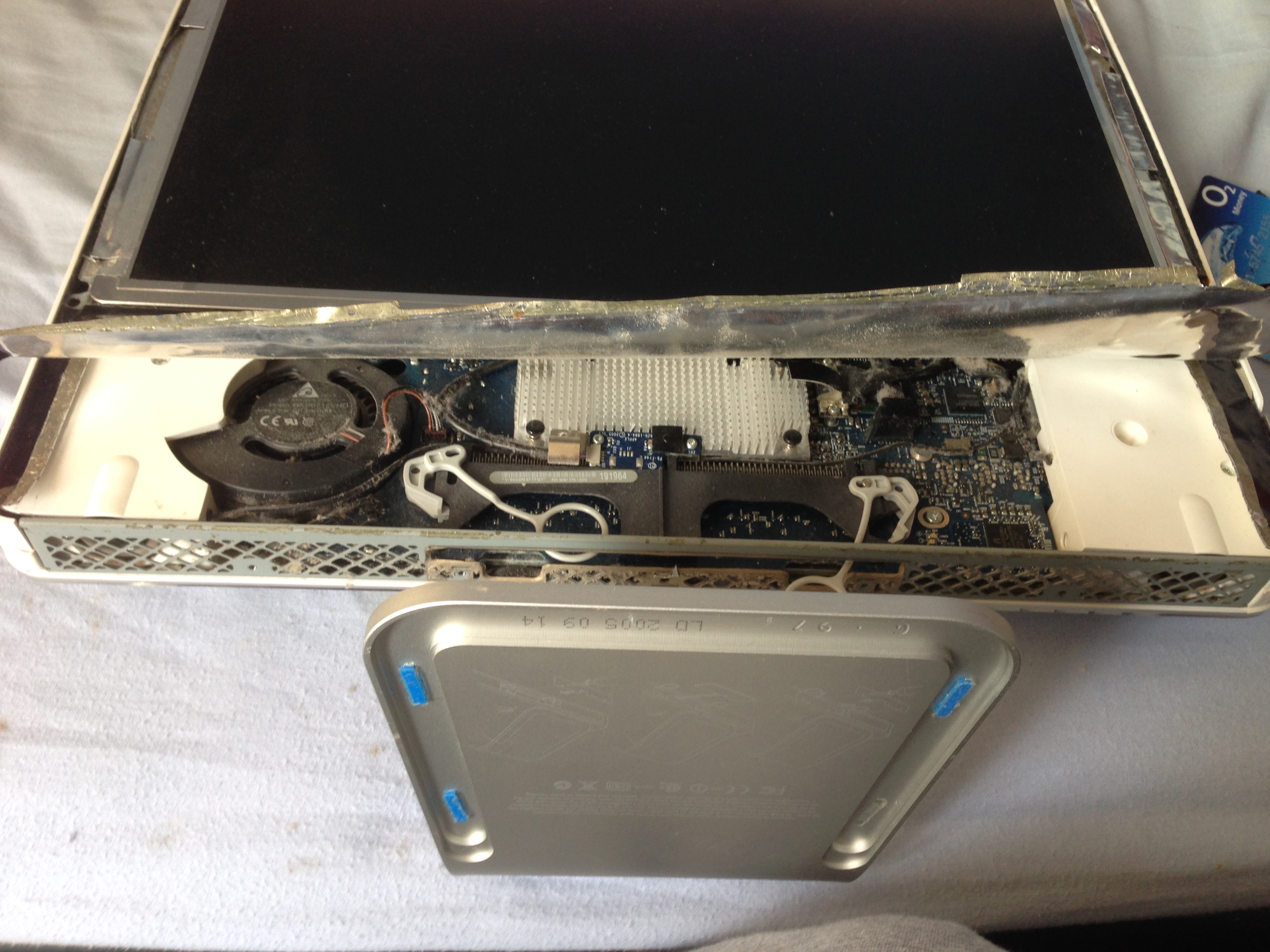

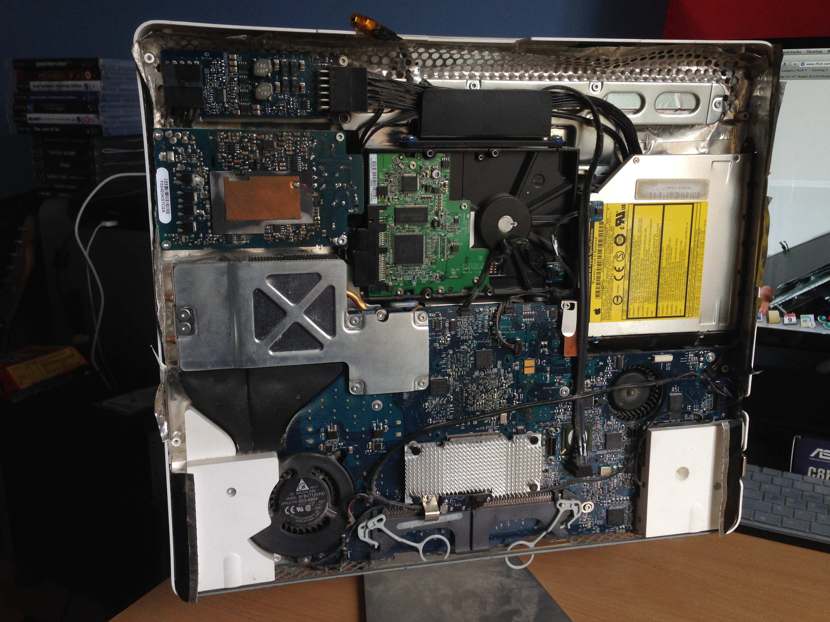

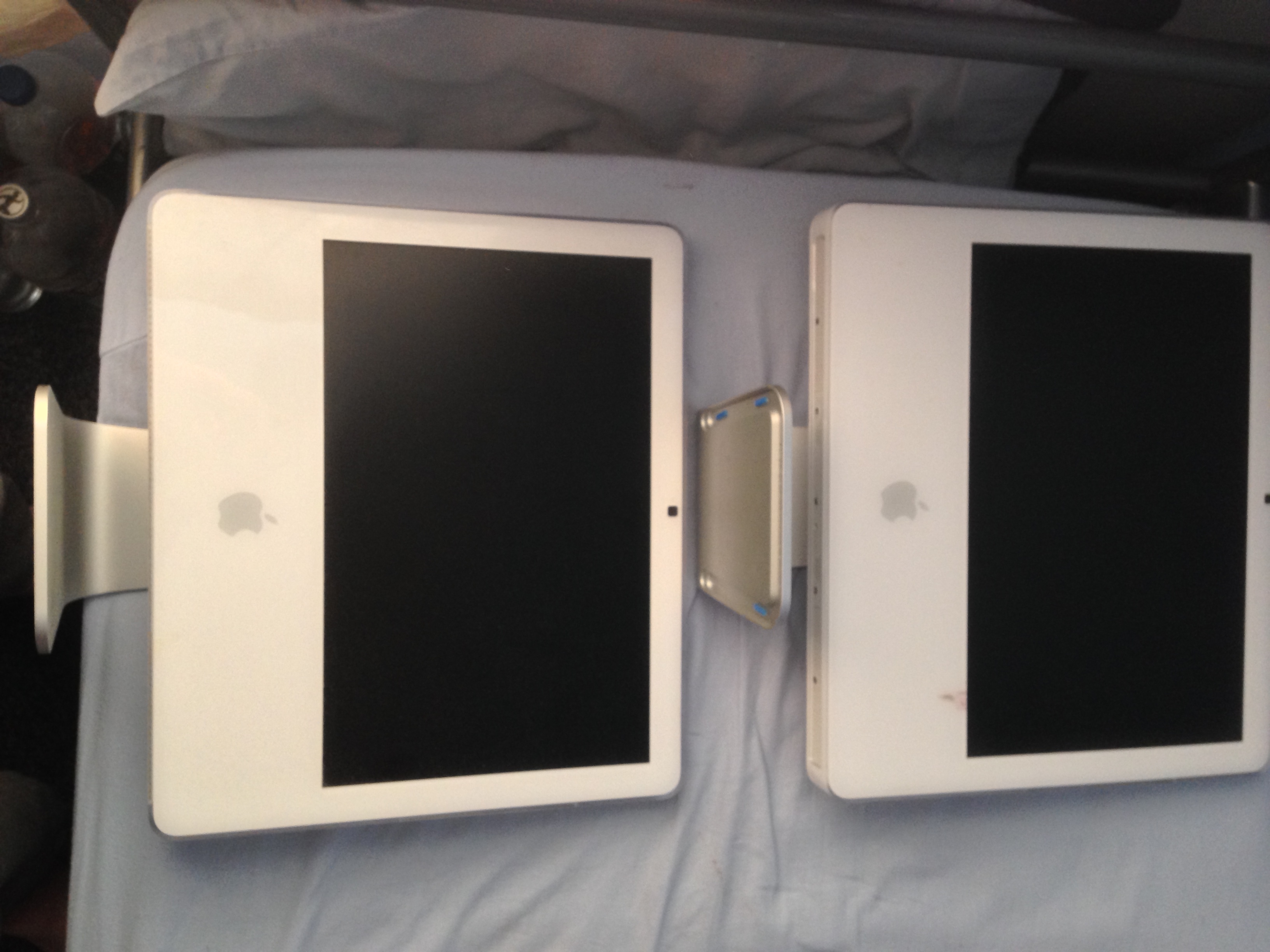

So my grandparents bought this iMac G5 1.9 isight as a refurb model in late 2005 and in 2011, they got an iMac i5 2.5.

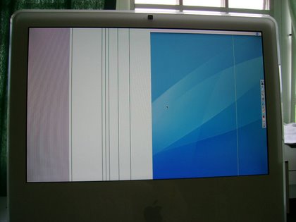

My mum took over the use of the G5 just for email and web and bout a year ago it started getting lines on the screen 🙁 thought it was the logic board so her husband bought some crappy 1.4ghz AMD Apu thing that uses 100% of the cpu just running windoze explorer. That thing is slowwwwwwww :roll eyes: I think my Tibook 500 is faster lol
Recently my mums friends iMac G5 just stopped booting and the beeps it made pointed to a RAM issue and since its onboard I figured there is no way to fix it. So I swapped the screens over and now have a working unit out of the two 😀😀😀

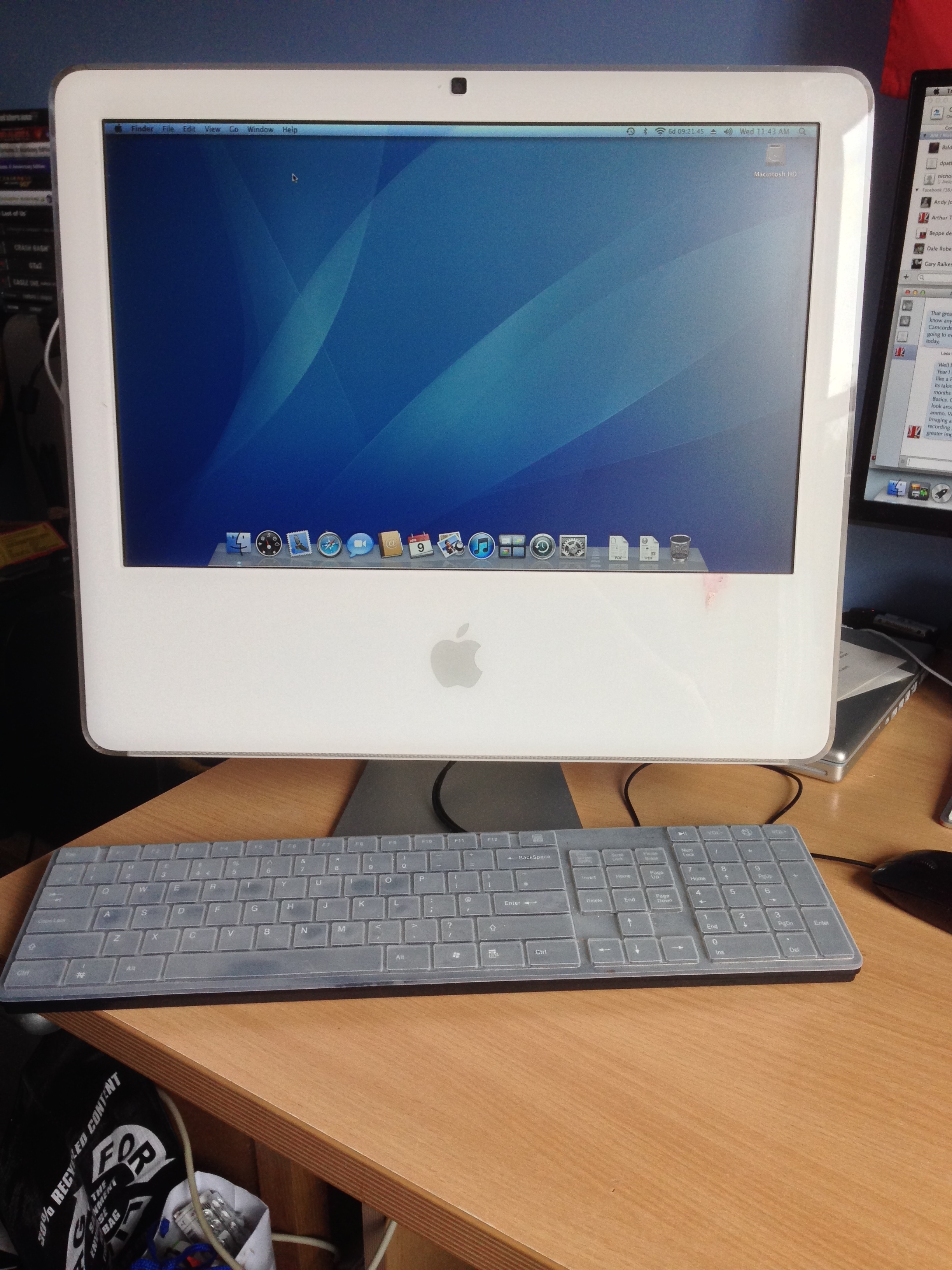

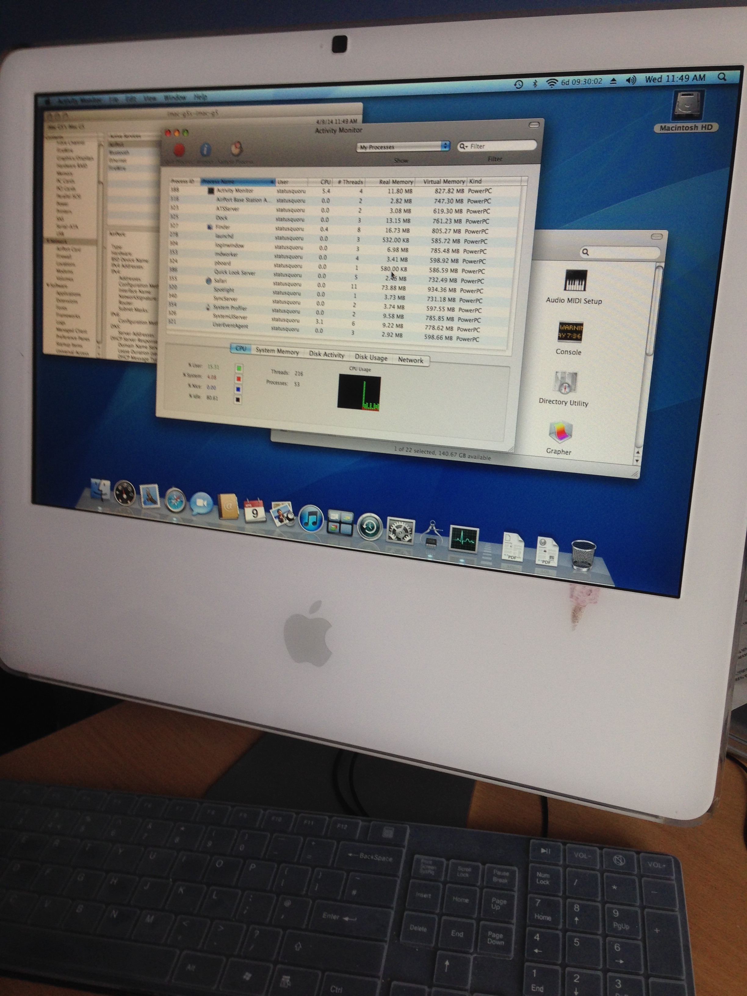

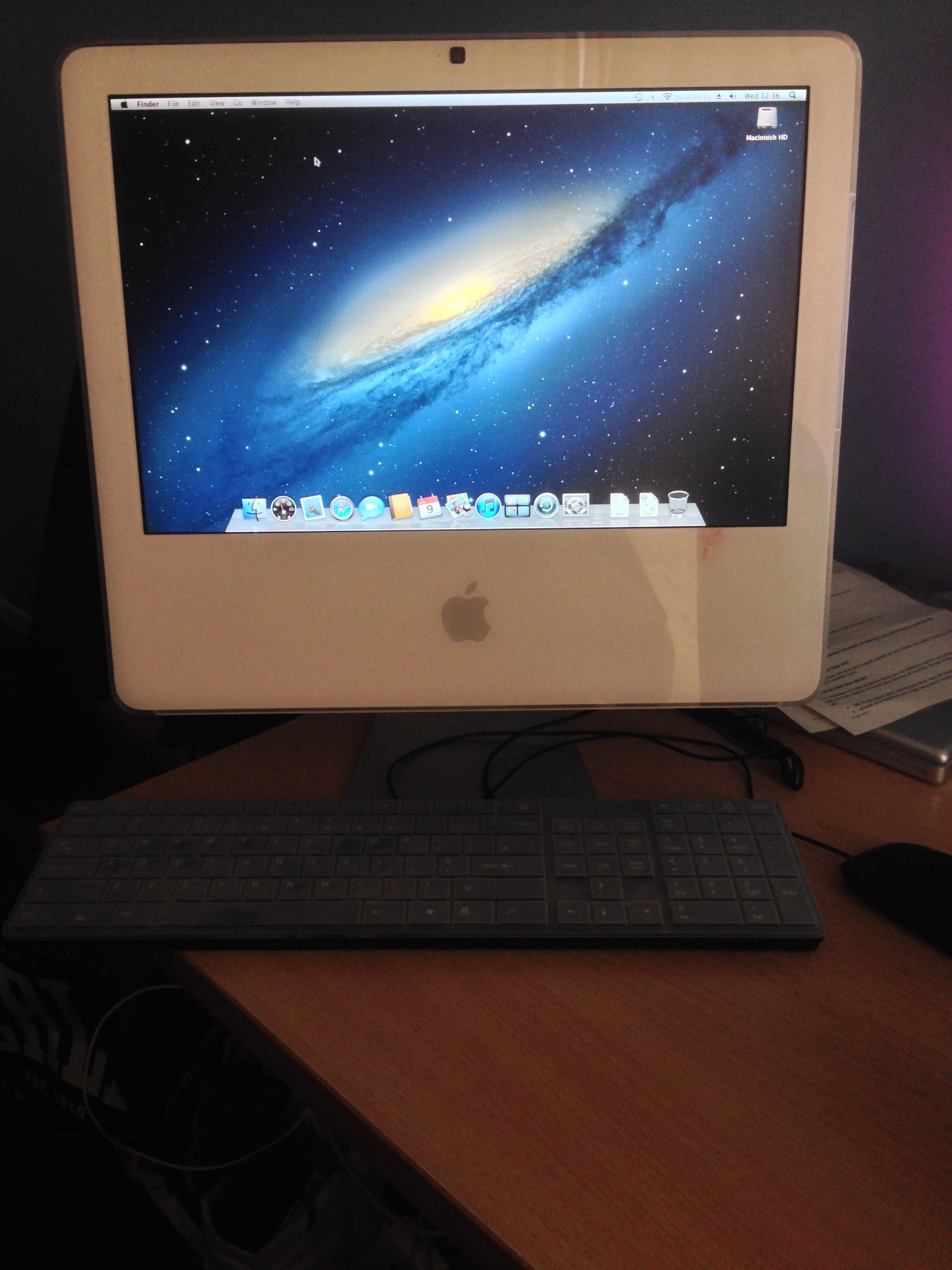

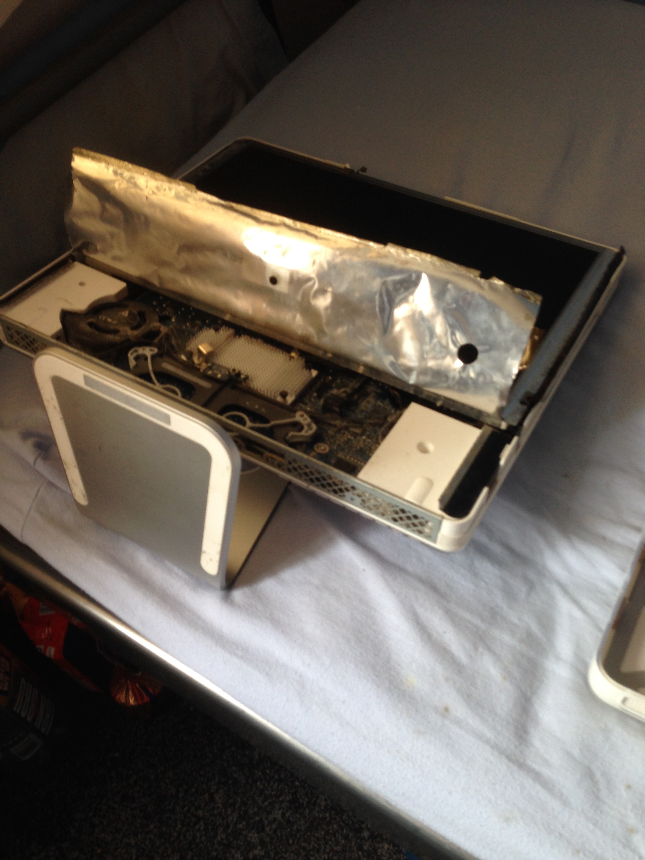

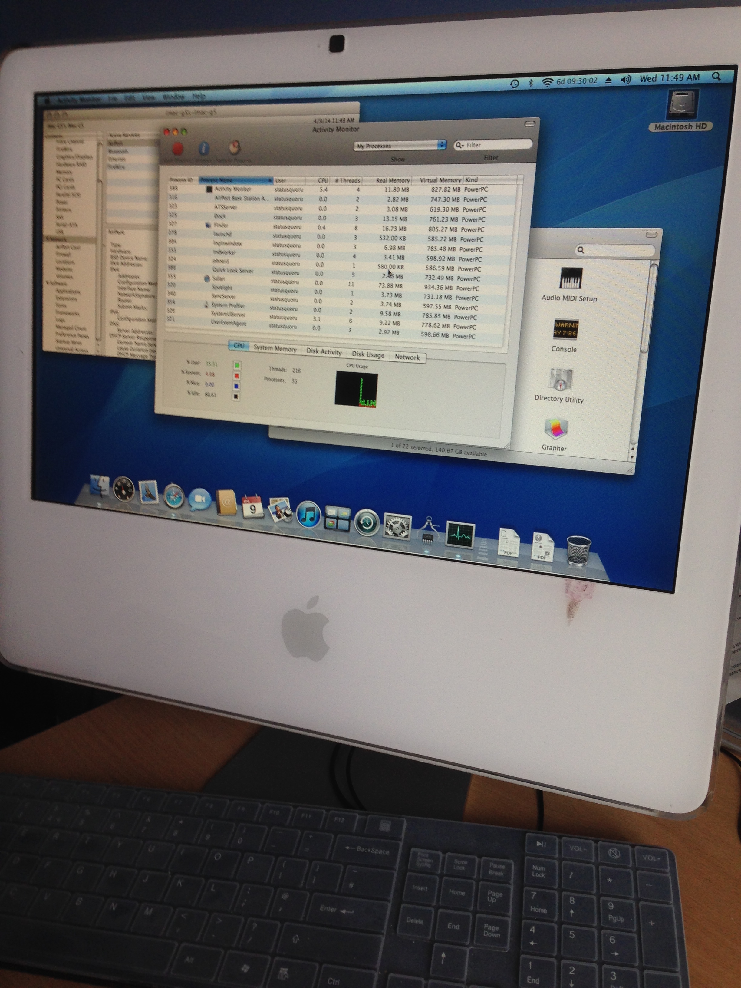

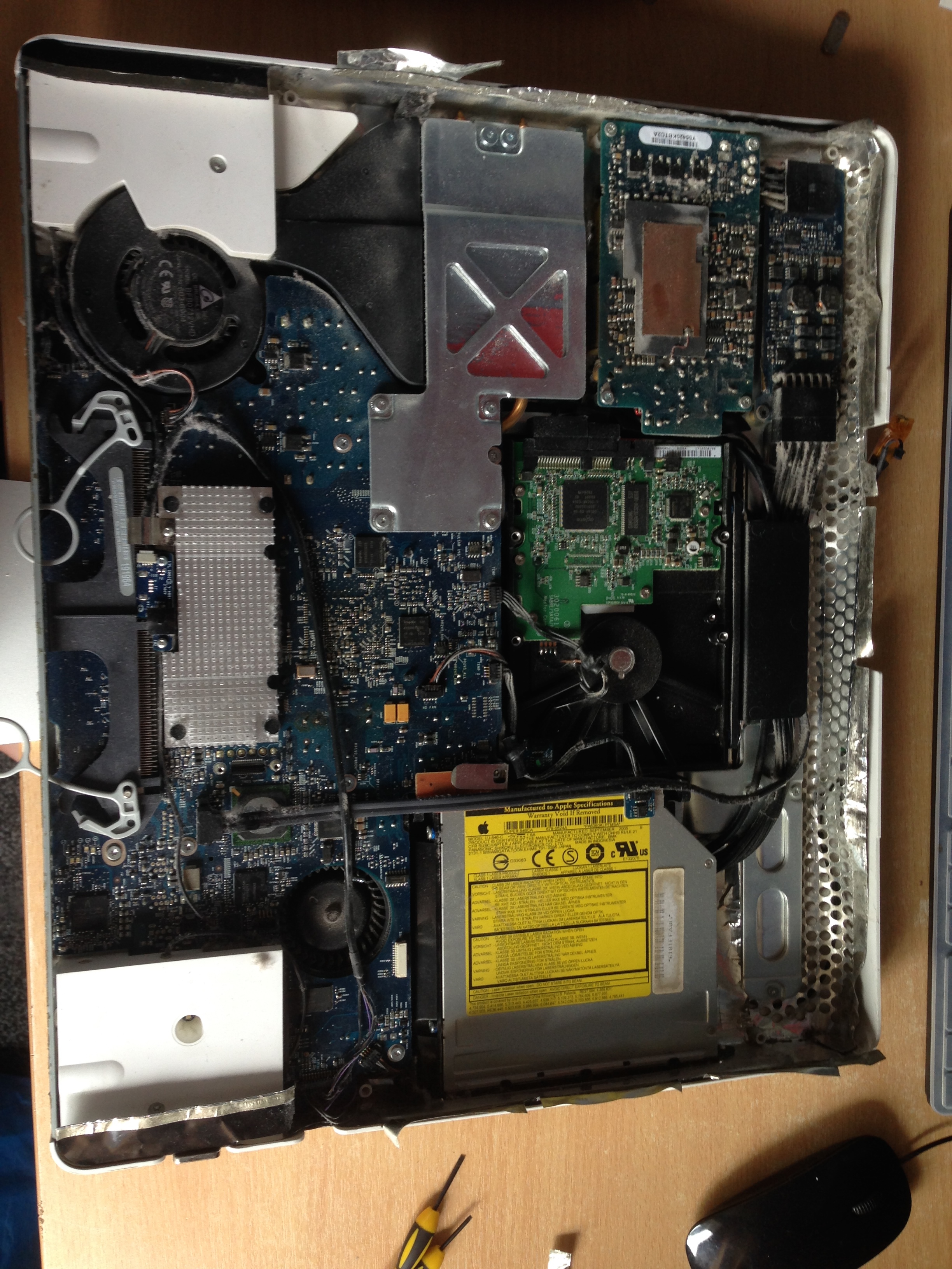

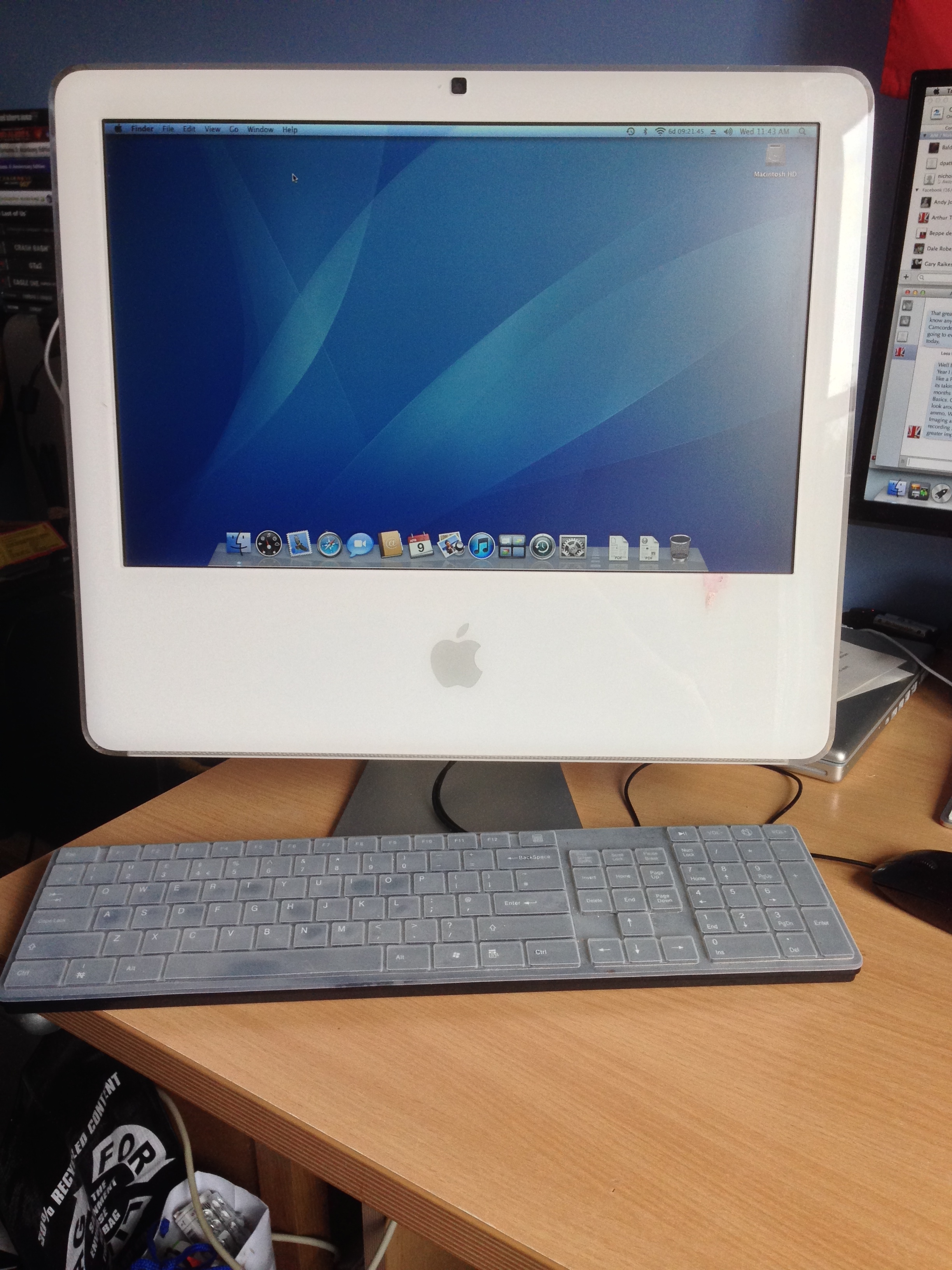

Gave it a clean 10.5.8 install with all intel binaries removed. Seems pretty snappy 🙂
I should have put a 500gb hd in it when I had it opened as it has a 160gb :roll eyes:
G5 1.9 - 1GB ram - 160GB HD - X600 pro 128mb GPU

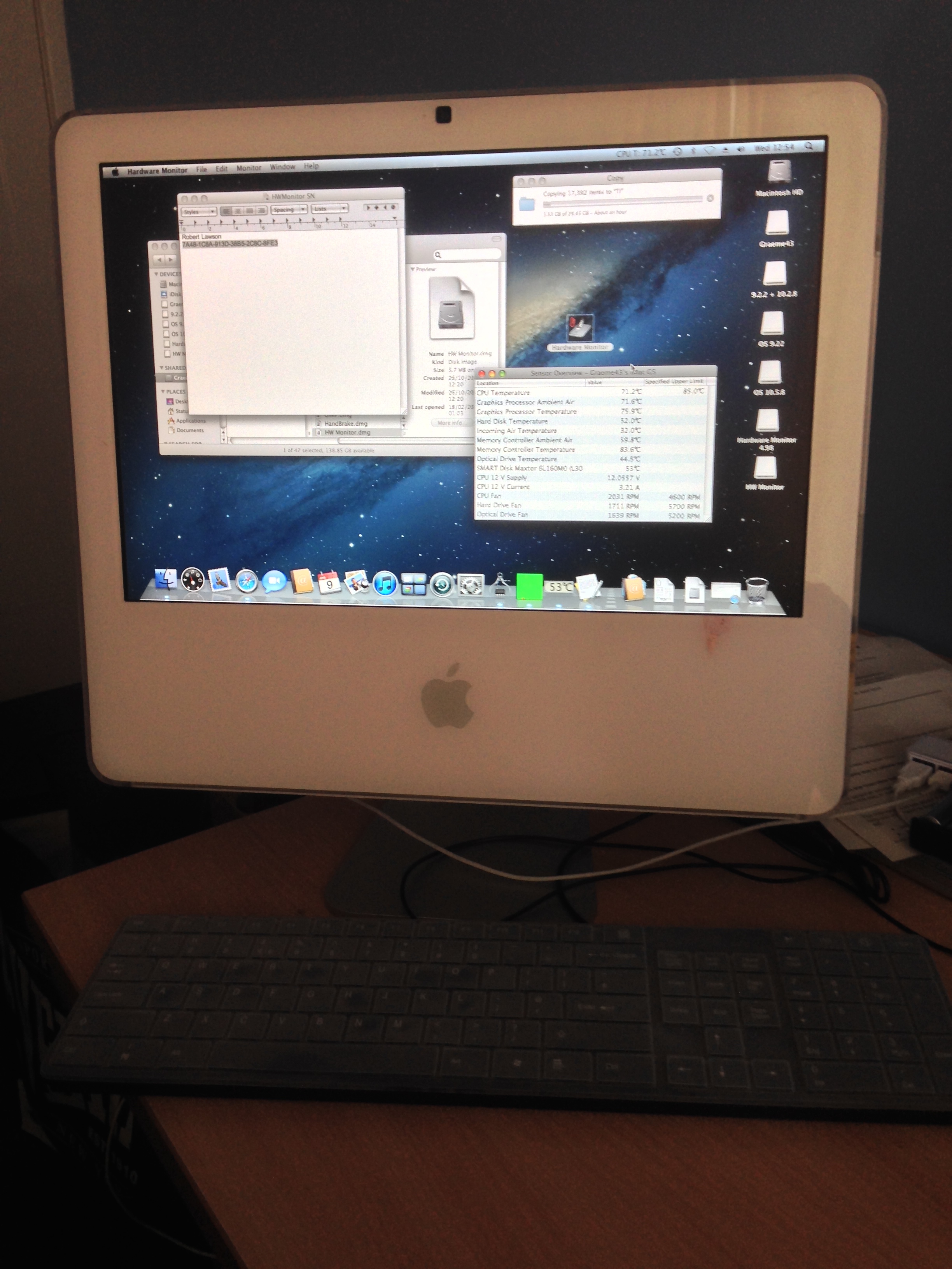

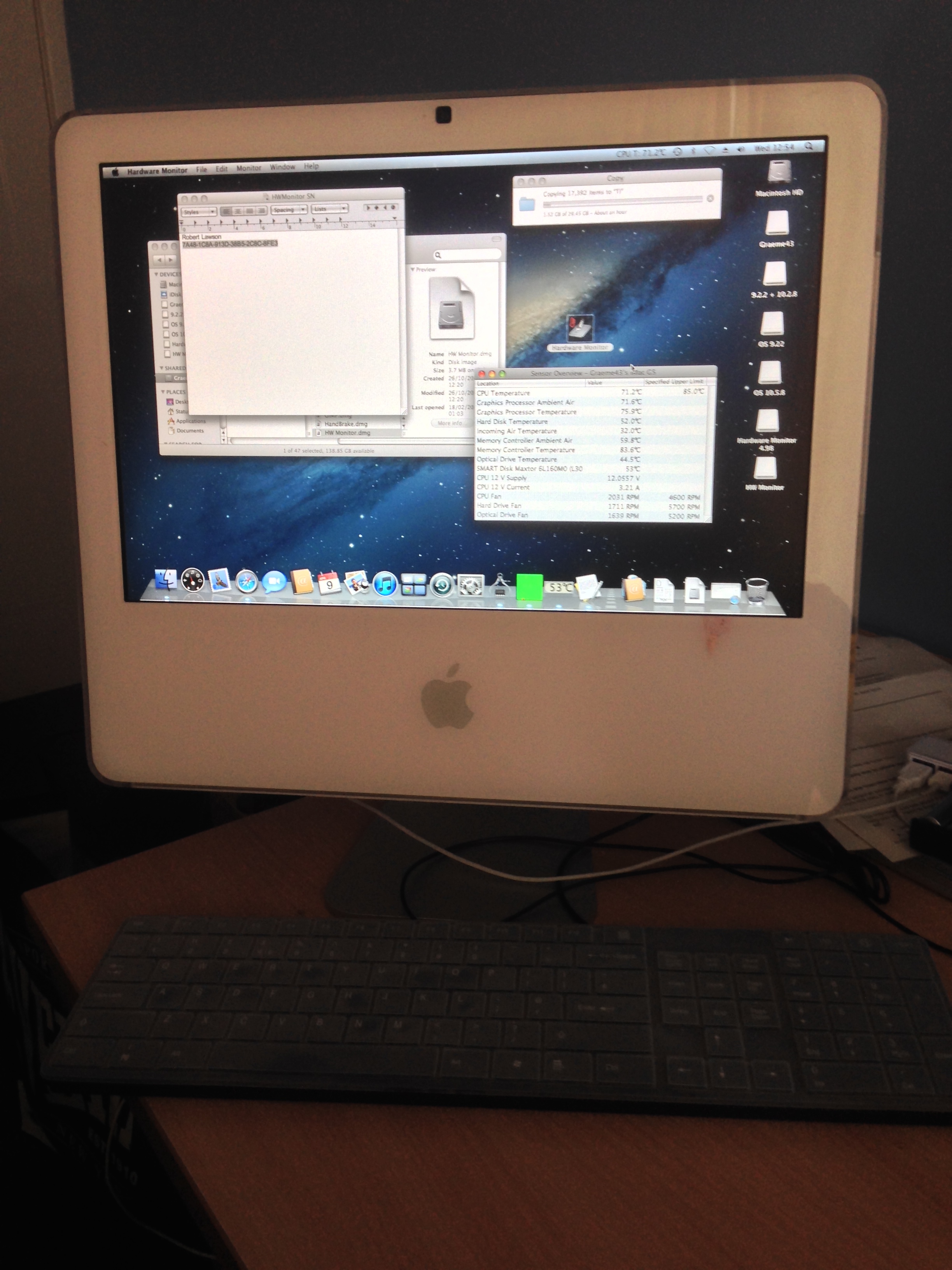

It seems to run quite hot! If my other macs got that hot id be very uneasy 🙁

I hear you! I have an iMac G5 as well and it runs in the 140-160º range (Fahrenheit). I had to look this up to make sure this was a standard temp and that the Mac was not overheating. But, it's a G5, so…
it quotes 85 as the max temp, but 70 is fine. if i set it to reduced cpu it drops to 60

Did you remove or reseat the CPU? If you touched the heat sink fresh paste should of been put on.

I was just copying files from my Mac Pro. Using AFP always seems to use a high amount of CPU on all the macs I have here ranging from iBook G3 to MacBook Pro 2.4
Never had to remove CPU

It may be good to repaste the heat sink. Thermal compound has an average life expectancy of 5 years, and less if pushed regularly. However, few people actually change theirs but it greatly helps.

I have never changed mine in any Mac I have owned but I do dust them out like my Mac Pro. I don't have the tool to take out the CPUs so I have no choice but to just leave it. If I had the tool Id upgrade her to 8 core 🙂 its a 2006 model. I have a PowerMac G3 and it has no paste on it at all.... hmm

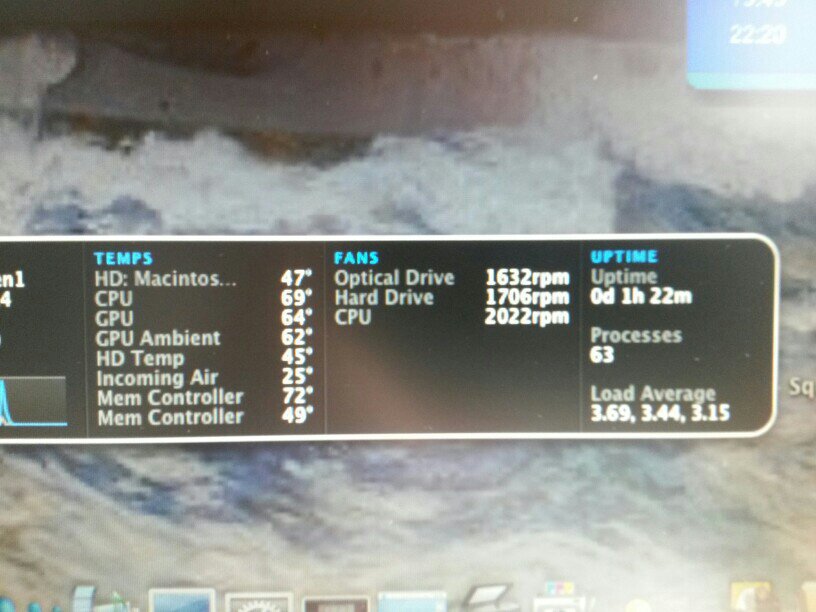

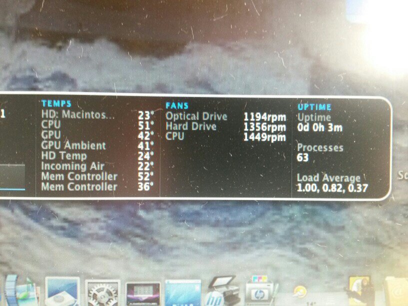

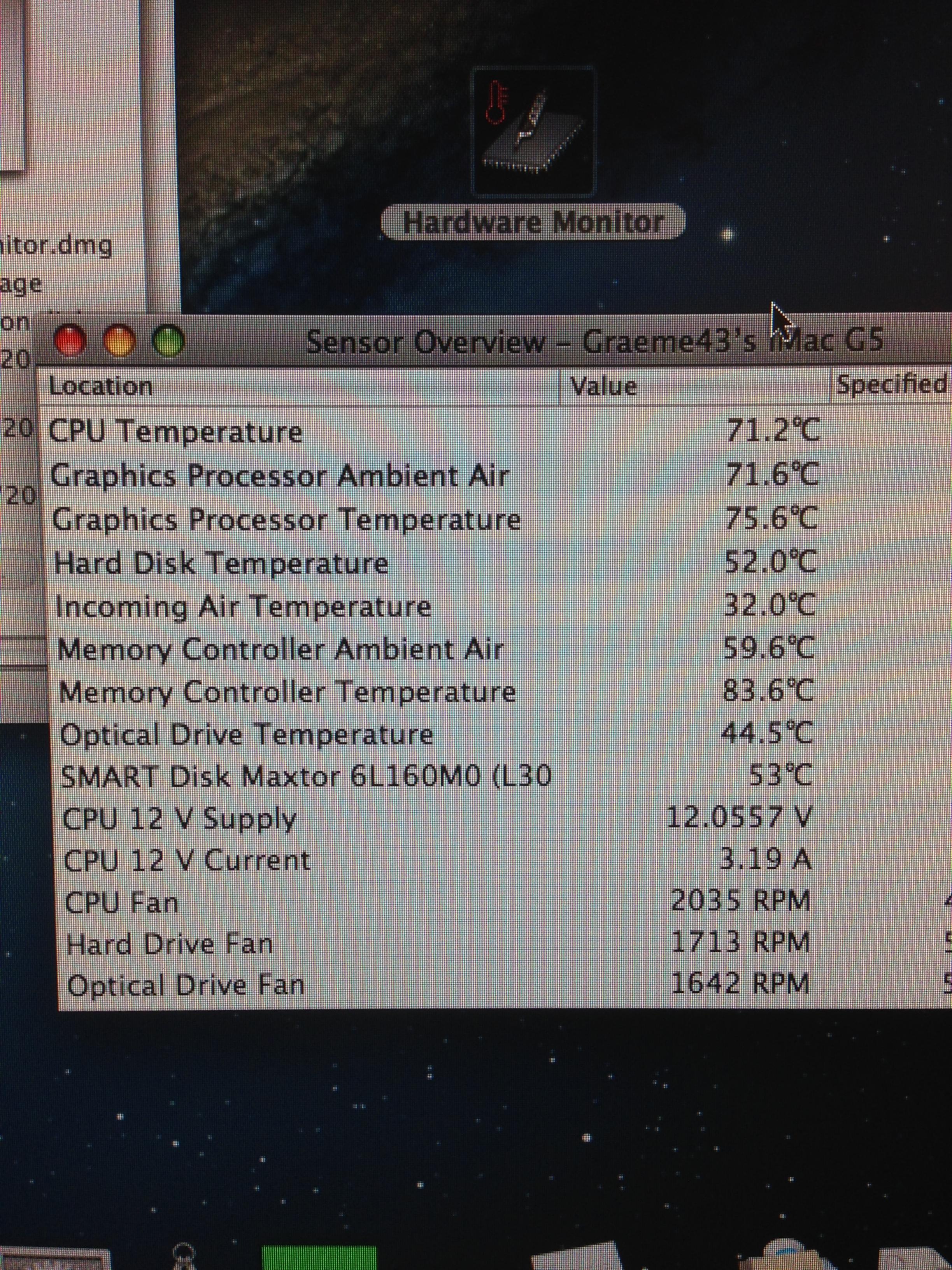

OK, after a while processing an MP4 to DVD in Toast 10, CPU is at 99-100%, temp up to 70°C.
See attached pics for iStat Pro on startup, and about an hour into processing ...
Also you can see I've cleaned the screen for the 2nd photo 😀
Cheers 🙂
Hugh

I guess 70-72 at max CPU is average then 🙂

Still seems a little hot to me. Maybe someone with an iSight iMac G5 can chime in? My PowerMac G5 (Way Different I Know) is hovering around 45 c with Leopard WebKit, QuickTime, Spotify, and Temperature Monitor open. Just a point of reference...
70c does seem hot...maybe it's the isight ver? My Imac G5 1.8GHz rev A (after I redid thermal paste) would stay around 52c.
If you look at the iStat Pro temps from my above post (taken on an identical machine to the OP), you can see in the photos that even under 100% CPU the temp is stable at about 70°C, and the fans are not running wildly.
I've used my iSight for a number of years as a video processing machine and it has always been so.
I also have another iMac G5, a 1.6GHz, and as a comparison the fans are extremely active and loud. It achieves similar CPU temps under load.
Cheers 🙂
Hugh
