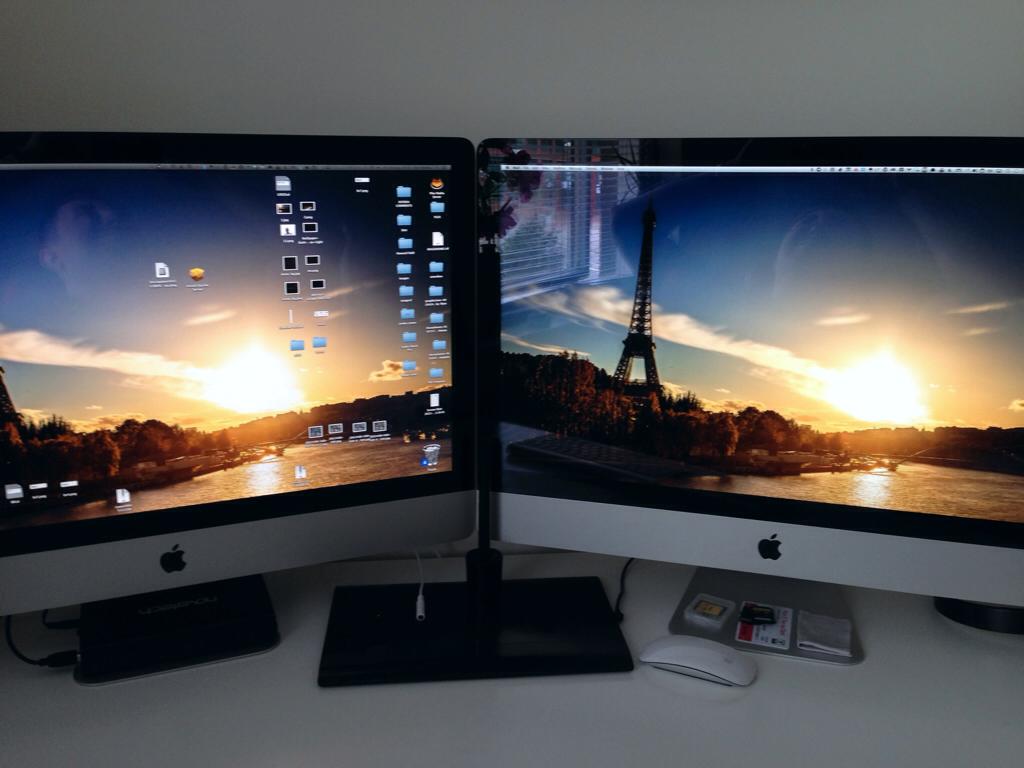

Here's an unusual one for you. Likely a dumb idea, but I'm curious.
I want to get a 27" iMac, but I want dual display, even though they're 27" (yes, I'm greedy). The problem with using the Thunderbolt display along with the iMac, is that they don't look the same and aren't the same height. That's not the end of the world, as you can sit it on a stand or whatever.
However, here's an idea that crossed my brain. I can get an older refurbished 27" iMac for around $100 - $200 more than a new Thunderbolt display. What do you think of linking two iMacs together? I watched a Youtube video (below) where a guy was using a second iMac, and he could use it as a standalone or as a secondary (extended) display for the first iMac.
How to Connect Two 27" iMacs for a Dual Display Setup! - YouTube
I was curious about this, because the height problem would go away, and I could potentially use the second one as a bootcamp machine or whatever, leaving the primary one free from "tampering".

Anyone know if you could connect (2) of the new 27" iMacs together (dual display) like the example above explains. I want both displays to look the same..plus would like to use the 2nd iMac for extra hd storage. Thanks in advance for any help
Hooking up 2 iMacs
I'm trying to do what the OP was trying to do.
I just bought a new 27" iMac yesterday to replace my old 24" iMac
I am trying to use it as a second display. I bought a Thunderbolt Cable from Apple and was hoping that I could do this. I hooked it up to my 27" and to my 24" but it does not let me I used the same tutorial as the OP posted.
I saw the threads about the 2011 iMac, so that means my iMac cannot do it? I can hook it up to my tv, but not to my old iMac.
Any help is appreciated!

Hi, I feel that this needs a little correction.
You can use most non-Thunderbolt displays with any Thunderbolt Mac, with the right adapter.
What you can't do is hook a non-Thunderbolt display, via an adapter, directly to the second Thunderbolt port of an Apple Thunderbolt Display. If you put some other Thunderbolt device between the Thunderbolt Display and the non-Thunderbolt display, then both will work.
However, neither of these two points are at all relevant to gerardo350z's post. He's trying to use a new Thunderbolt iMac as a monitor for a non-Thunderbolt Mac, which won't work at all (because the new Thunderbolt iMacs can only accept a Thunderbolt signal as a video input source, and gerardo350z's old iMac can't produce such a signal).
I thought about doing something like this before but my question is can the second iMac be turned on and used as a server while simultaneously being used as a display for the other computer?
Probably not of interest to newagemac anymore, but in case anyone else is wondering: yes, the iMac which is working as a screen is still running full Mac OS X. If you log in before you switch it to external-video-input mode, you can start whatever file servers or other applications you want. At any stage, you can switch back and forth between external video input and normal mode (Command-F2).
Note that to use an iMac in external-video-input mode (i.e. as a screen for another computer), you have to start the iMac in Mac OS X, Windows won't work.
