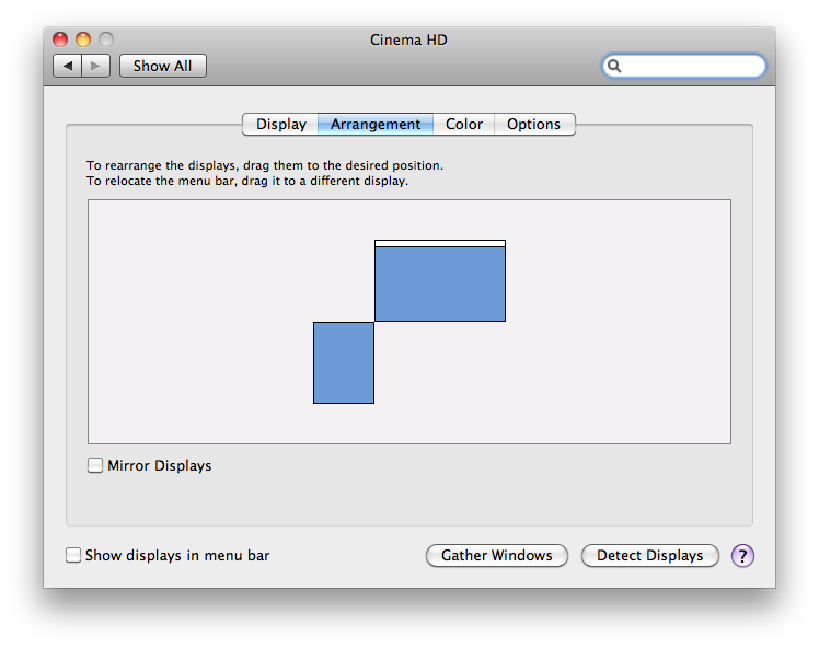

The easiest thing would be to setup the second display so that it's positioned in an awkward location like so:

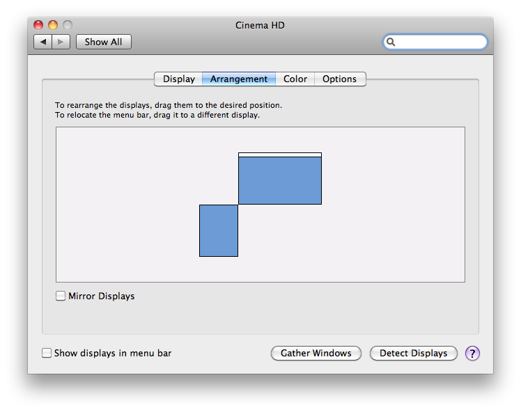

But I believe the displays must have a common pixel so the mouse can travel between them.
If your Mac display (upper right in this case) has any functions activated by moving to the lower left, you may end up on the other display. For example, if I drag my mouse to the bottom left I start my screen saver (with password).
So you would need to deconflict something like this with your display placement for both the Mac and PC.
Yeah you need a common pixel so you'd lose one hot spot. That's pretty easy to live with though.
Understand and agree.
However, someone like me who just drags down and to the left at the max would probably transition to the other screen. In my case I would need to set up the screens differently so that wouldn't happen. YMMV.

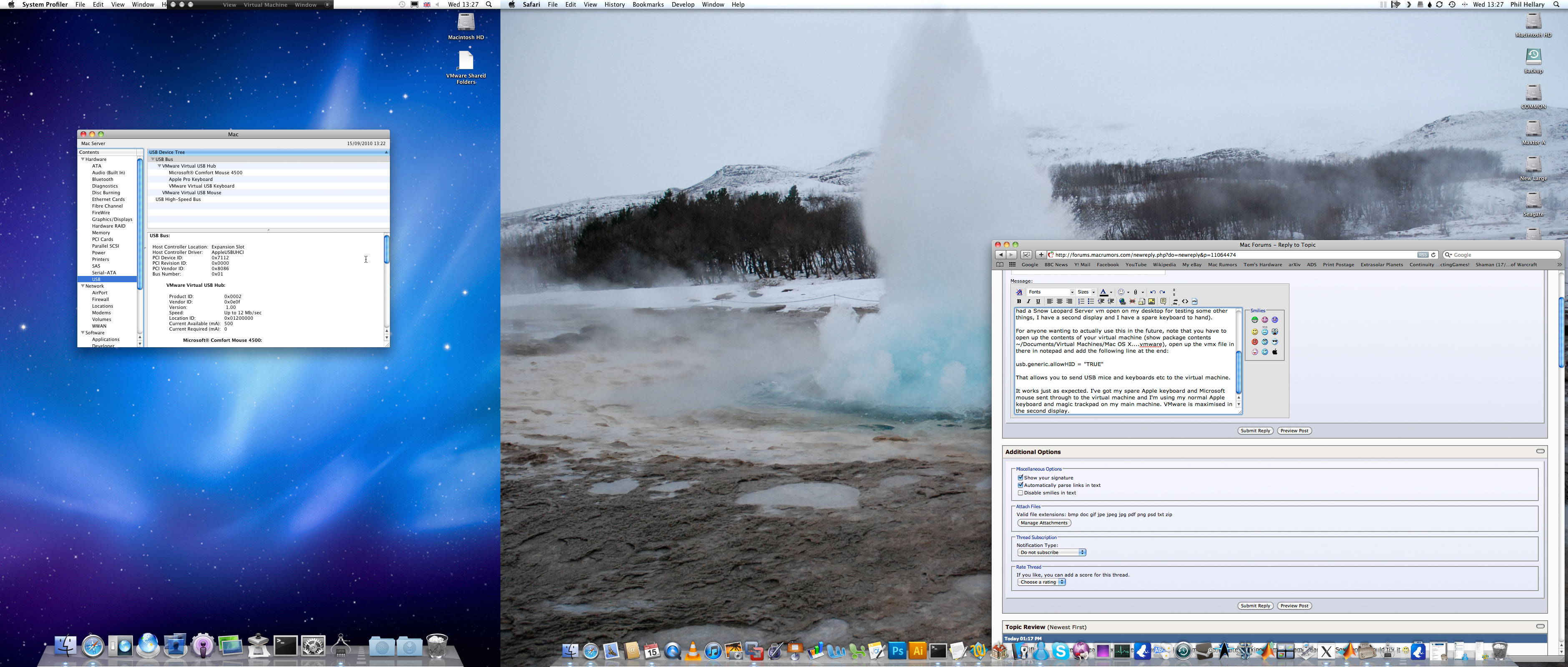

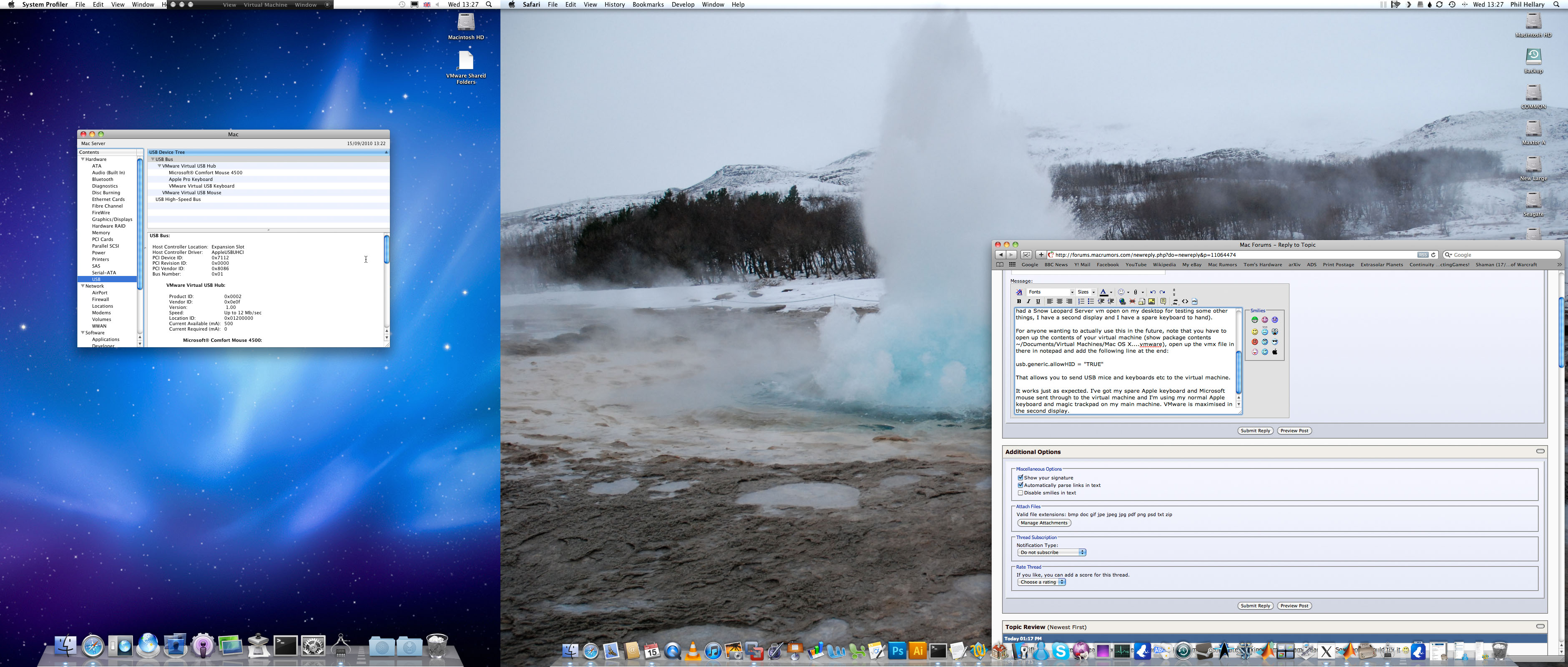

Well, in the interests of the 'why not' sentiment, I've given it a try (I already had a Snow Leopard Server vm open on my desktop for testing some other things, I have a second display and I have a spare keyboard to hand). In this manner you could have as many clients as you wanted.
For anyone wanting to actually use this in the future, note that you have to open up the contents of your virtual machine (show package contents ~/Documents/Virtual Machines/Mac OS X....vmware), open up the vmx file in there in notepad and add the following line at the end:
usb.generic.allowHID = "TRUE"
That allows you to send USB mice and keyboards etc to the virtual machine.
It works just as expected. I've got my spare Apple keyboard and Microsoft mouse sent through to the virtual machine and I'm using my normal Apple keyboard and magic trackpad on my main machine. VMware is maximised in the second display.
I've edited the two screenshot files together here:
Edit: You could even go another step further and use a usb to vga/dvi adapter too. You could attach a mouse, keyboard and vga adapter to a hub and then connect that hub to the VM. One cable to add a second user.
