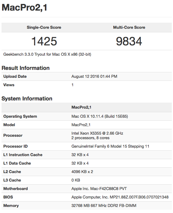

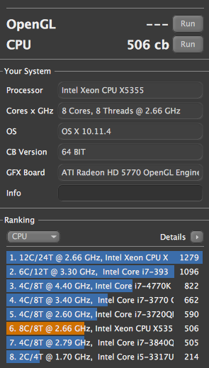

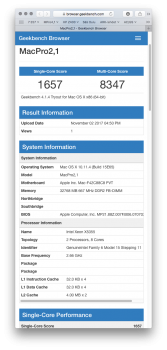

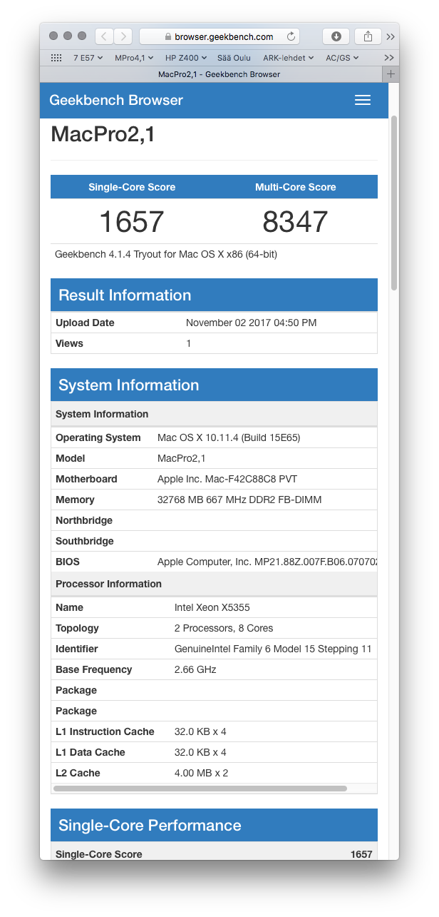

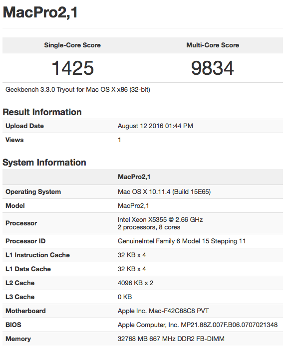

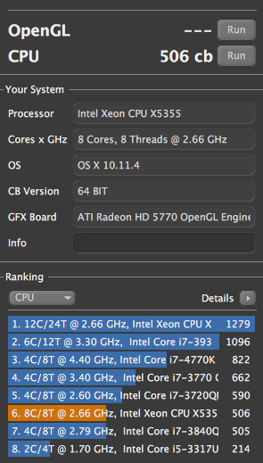

Sure I took all the tests possible back then. Attached are GeekBench 3.3.0 and Cinebench R15.

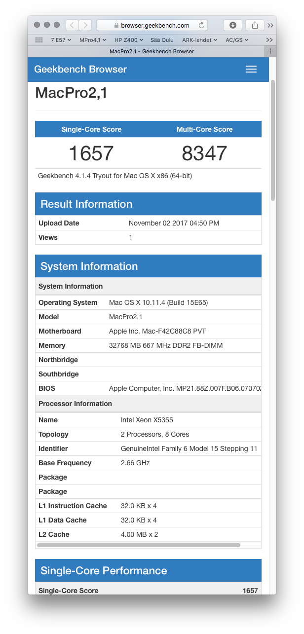

edit. GeekBench 4.1.4 added. It differs from GB 3.3.0, andit might give a better perspective in regards to newer machines.

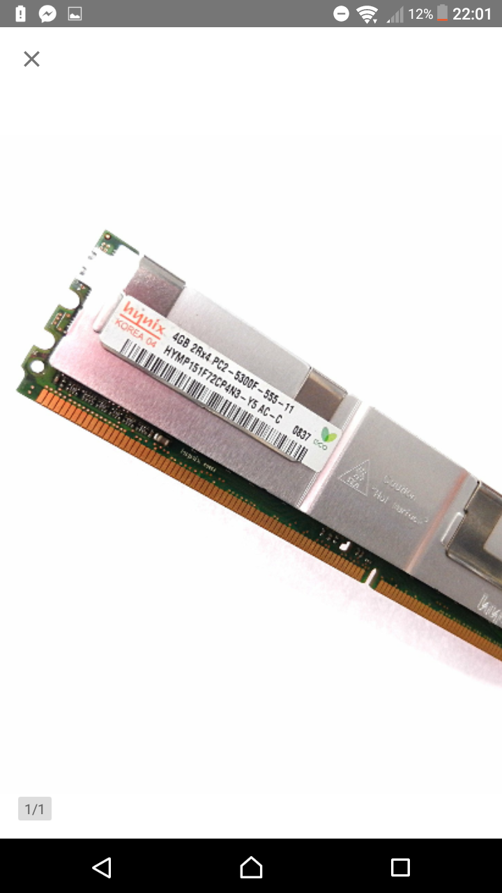

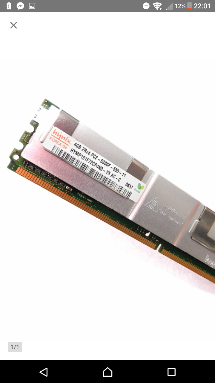

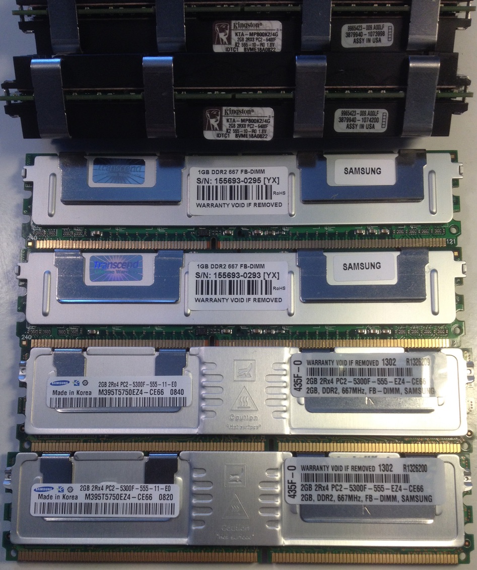

I foujs those rams for 3$ each with 3$ shipping. Will they work for Mac? I want to buy 2 of them.

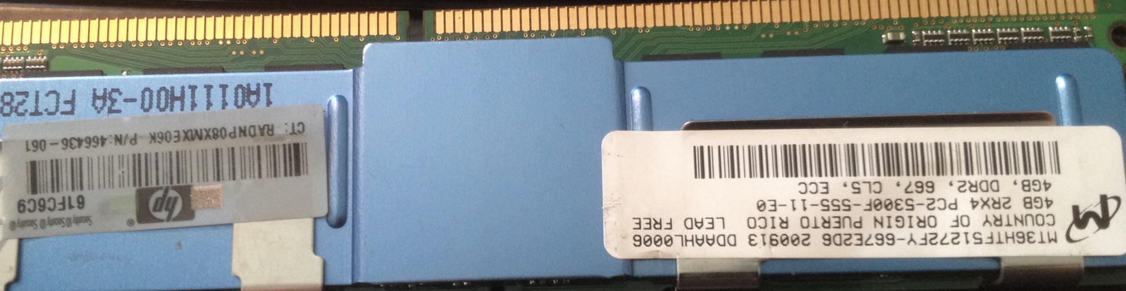

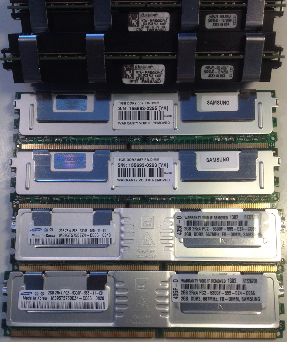

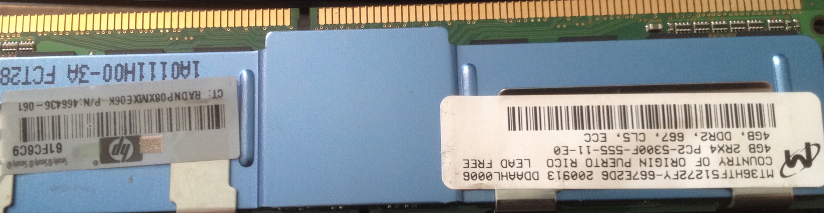

Looks like compatible. Attached my dumped memory modules, an the new ones are those HP ones. Regardless of the brand, your memory code at the dimm's looks like kind of very similar, what do experts say about this?
