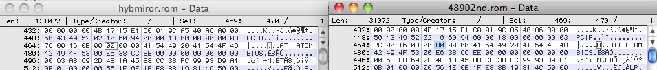

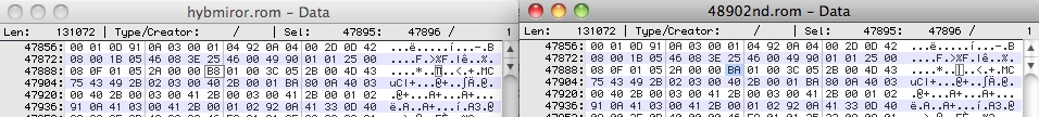

Comparing files (hybmiror and 48902nd) with HexEdit gives 3 differences, did you make them ?
